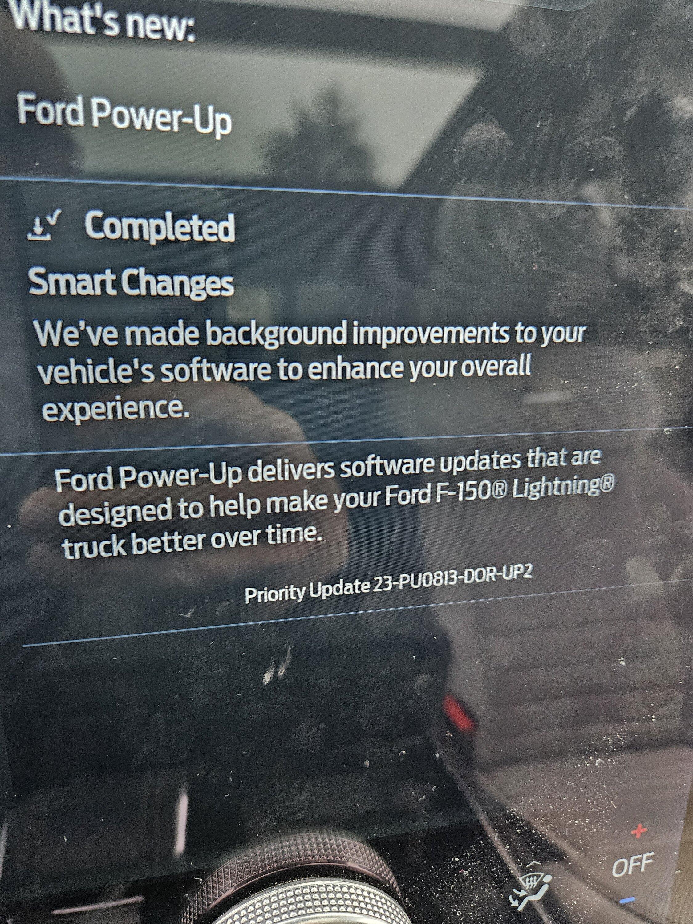

I just checked again, and an update is now showing available. 12V SOC had increased to 85% with truck powered on. I launched a manual update and received a message that it would take 13 minutes to complete.
@rugedraw , I finally got the update to complete on the 4th attempt. The first 2 failures were my fault since I forgot to turn the truck "off". I did turn the truck off on the 3rd attempt, but the update still did not complete. I did exactly the same thing on the 4th attempt as I did with the 3rd attempt, and the updated completed this time.

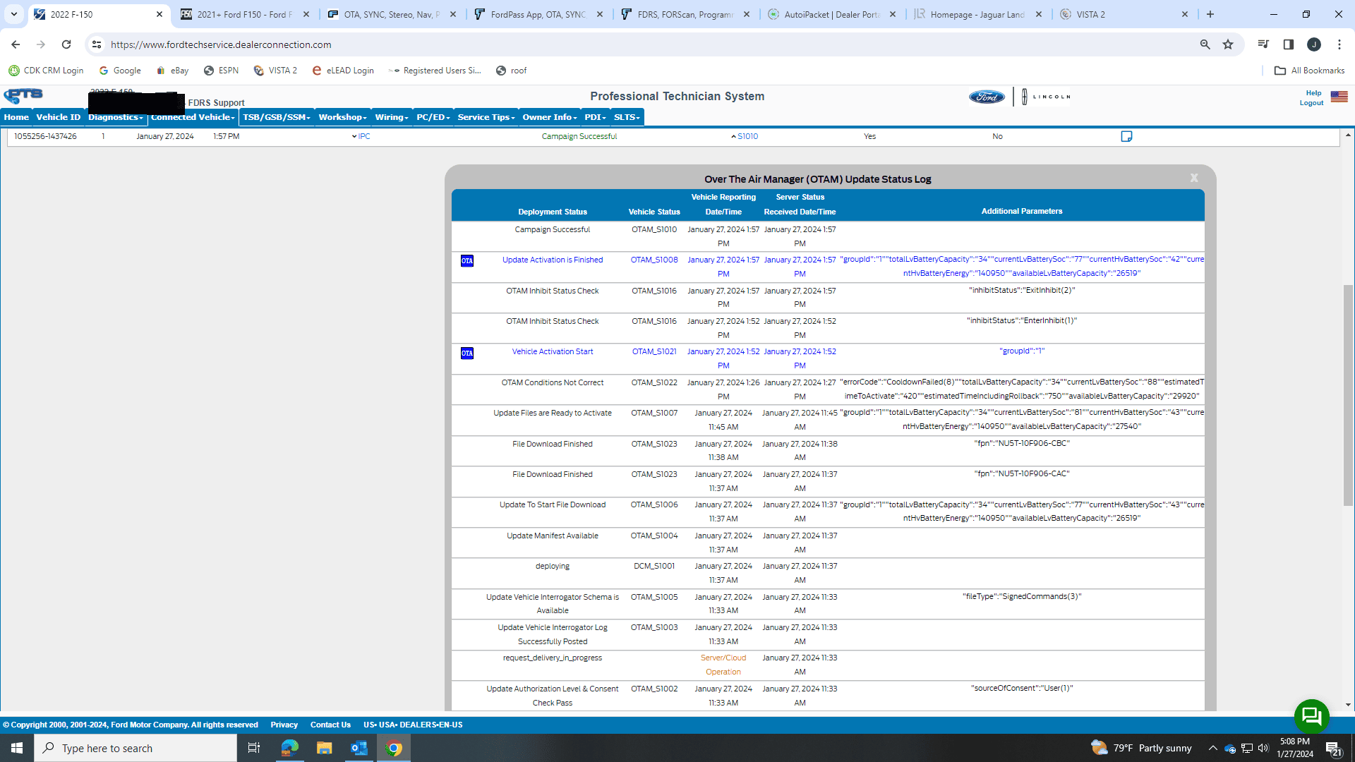

PTS is acting up and not showing OTA dashboards right now. I'll try again later.
Edit: It's back up. Looks like it just failed to enter inhibit mode the time before it installed. It only recorded two attempts and the battery stats are almost identical in both attempts.
