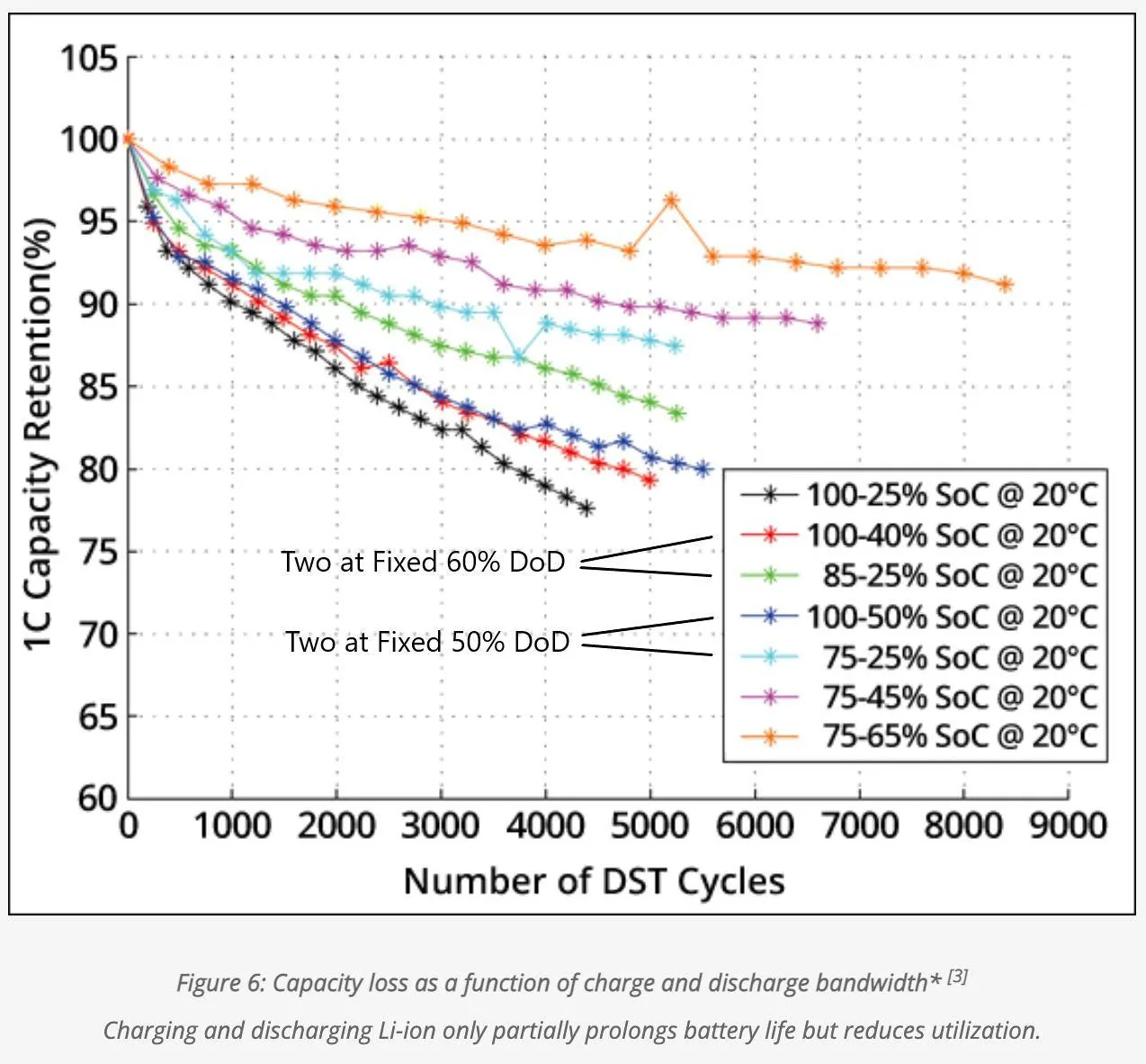

I, personally, find that graph really misleadning.
The 25-100% delta will reach the same throughput 7.5 times faster than the 65-75% cycle, so if they were scaled to look at throughput you'd be looking at a 92% vs. 90% capacity which is not a whole lot, but the graph makes it seem like you'r dealing with a dead battery vs. one with 92% capacity left at the point in time which simply isn't true.
The only ones you can compare is the two that are fixed to 50% and 60% respecively where the conclusion is that it's "bad" to always charge to 100% - which we knew already.
The Battery University article there isn't perfectly clear on the testing however it is the norm to run the battery through the same number of "cycles" (100% of capacity) for all tests.
In a case similar to the graph linked 25% to 50% (25%) would be done 4 times, 25% to 75% (50%) would be done twice, and 0% to 100% (100%) would be done once, to count a "cycle" of the battery.

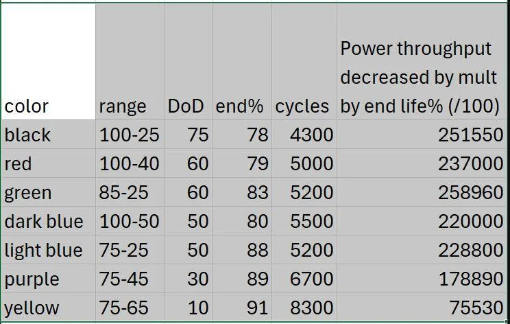

Does this table below reflect what you are getting at? Mini-cycles look good for range, but one has only traveled 1/3 as far as the others?
