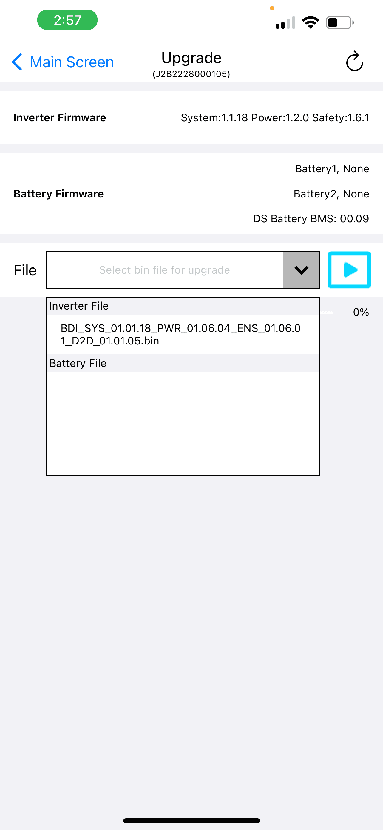

The Delta Tech's have never seen the errors I have before. They attempted to force the software update and encountered the error. So the software for this unit is written in China they said. They can't do anything here in the states. They need to wait until China wakes up, and have them either remote into my inverter and fix it, or at the least, remote in to assess the situation and fix some settings.
Now I feel like I overpaid for this.
Edit: Update - Delta is going to authorize an RMA once AEE solar gives me the case number. Looks like I need a new inverter. Actually wasn't too hard to work with the Delta tech. There were only 2 of them I've worked with over the course of this 2 week trouble shooting and they're very smart people but overworked. We will see how this works out and how long I'll be without solar production.
Edit: New HIS is on the way from AEE solar. The inverter is defective.

Got the new inverter yesterday (got a whole kit, they only ship as a kit). And we put it in today. It worked flawlessly. The last one wouldn’t even take an update. This one took it, makes killer solar energy, more than my Tesla inverter.

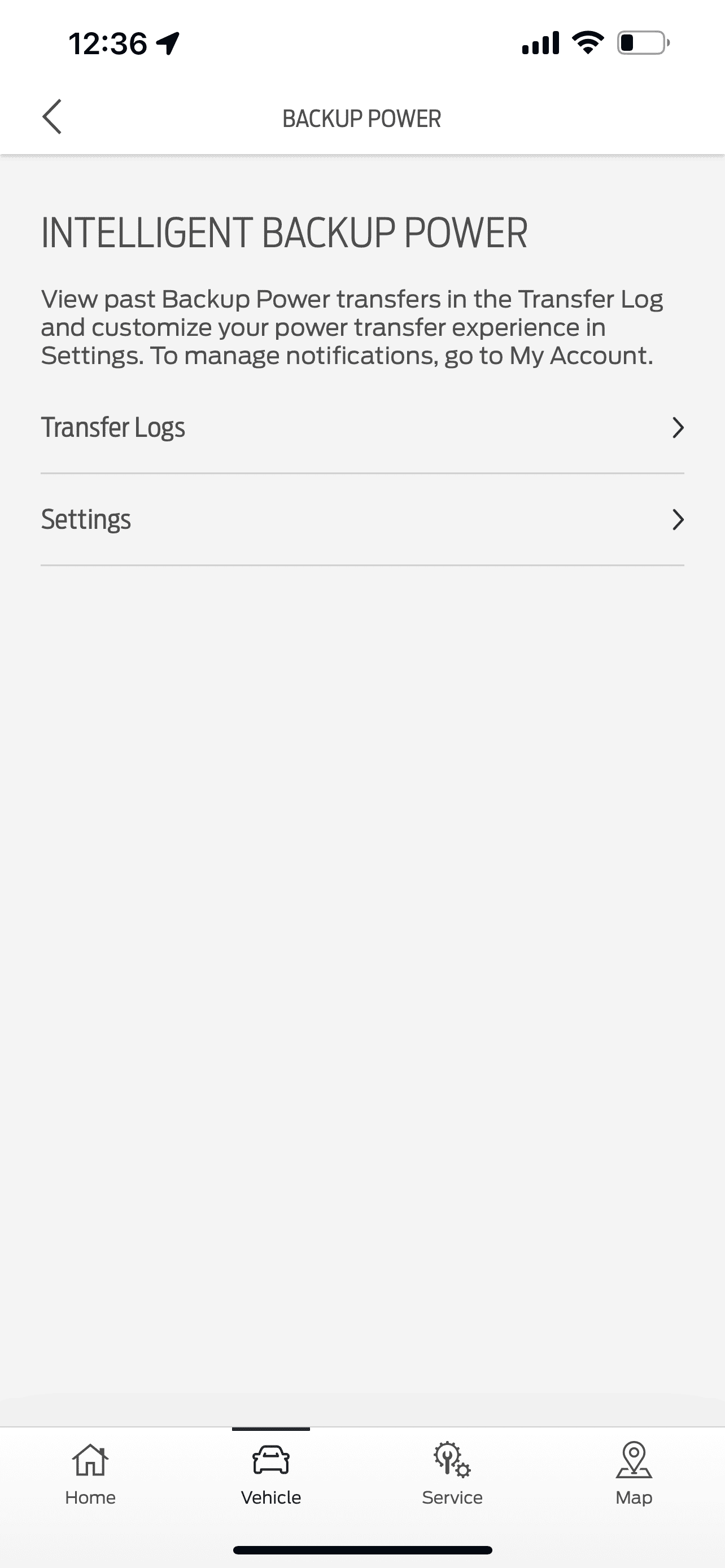

What are you guys using to see the check mark things on the app? I have literally never seen that where everyone has the check marks but were missing one?
yed19
yed19
Jay
Dec 6, 2021
339
295
Washington
Now I just need to make sure the truck backs up the house.
https://www.f150lightningforum.com/...backup-power-without-sunrun.12564/post-310803
IdahoSpud is the only one Inhave seen on here that has a working non SunRun installed system functioning. Welcome to the club of those without the final âś…

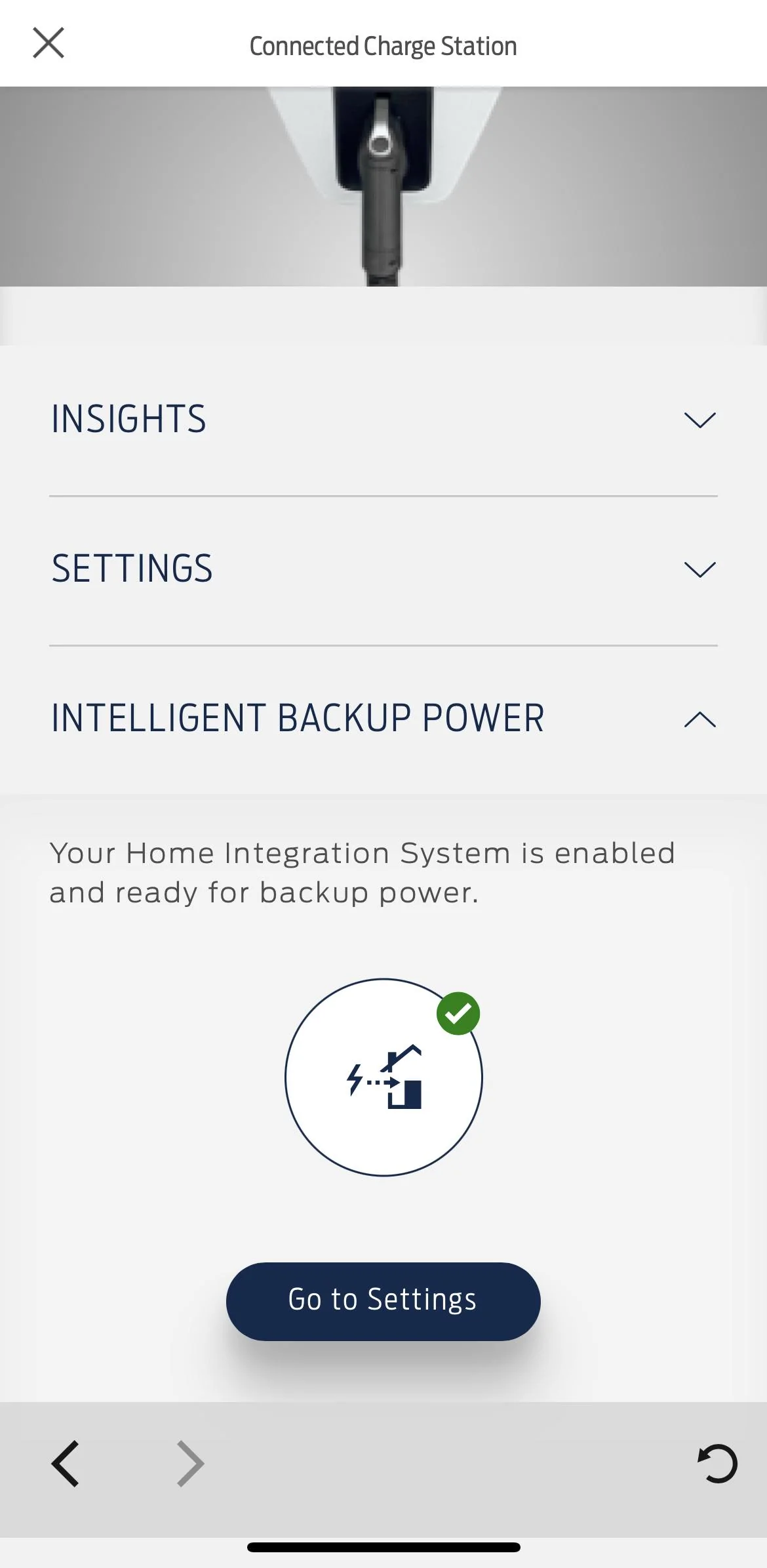

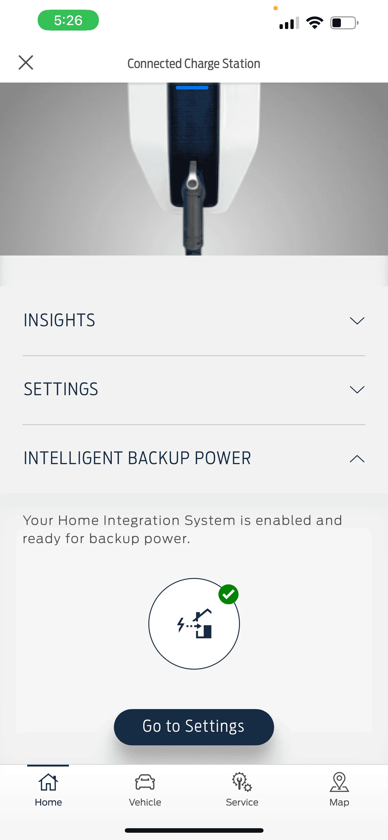

My system has been working for a while now. I actually believe it was the first in this thread.
Under the ChargeStationPro you should see the following:
Yeah I have all that too…
Ford F-150 Lightning Installing a Home Integration System for Intelligent Backup Power (without SunRun) FD6F4852-D098-4B7F-A315-C0D519641F3F
