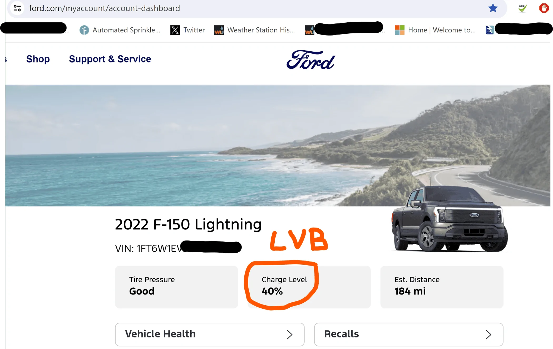

Is everyone checking their Low Voltage Battery at www.ford.com/myaccount ? Most updates require LVB SOC to be above 90% and others require above 95% to download and apply.
I do. I check mine almost daily. The lowest LVB charge level I have ever seen is in the 80's though. Even then I will plug up to a level 1 charger to keep the LVB topped off and ready for any udpates that happen to come my way.
Have you had the CSP for the LVB monitor completed already? Or maybe you just had one of the larger OTAs pushed to you that caused the low SOC for your LVB?

I have had the CSP preformed. I'm also getting updates but was just pointing out to the people not getting the updates to check this. I just made a 4 minute drive and the LVB SOC went went from 40% to 66%. I havent charged at home in a few days so no LVB charging with L2 charging in a few days. I do question the health of the LVB. The last update I received was the "Refind Audio" update 23-PU1024-6CH-AUD (May 22nd) and I had to get the LVB SOC to 95% before it would apply.
