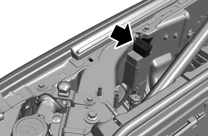

They learned from Mach E. LVB jump points are by the right frunk strut :p
pp. 420-421 paraphrased
  1. Locate the jumper cable symbols on the right-hand side (Frunk) luggage compartment cover.
  2. Remove the cover. See Installing and Removing the (Frunk) Luggage Compartment Cover (page 338).
  3. Remove the red cap. Connect the positive (+) jumper cable to the positive (+) jump point of the Lightning
  4. Make the final connection of the negative (-) jumper cable to the negative (-) ground point of the Lightning
