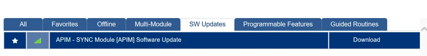

Hey hey, so after the 6.2.0 (second GWM) update I now see this APIM update pending in FDRS. Nothing in the truck yet. I'm guessing this will be 6.3.0 for Lightnings? Looks like the numbering is different from our Mach-E and ICE friends.
Mike G
Mike G
1,415
1,935
N. AL, USA
I just saw this a few minutes ago on my truck as well. I will do a 30 minute remote start around 0845 to get my 12V battery charged back up so that when the 0900 scheduled "Check Updates" time rolls around it might start downloading. And before any of the smart guys jump in and tell me that the Check Updates time is only for when to apply inhibit updates, and has nothing to do with actually checking for updates...I've done it this way at least 4 times to make OTAs that I knew were supposed to show up for me...download and process. I do it that way so that I can find out what the OTA number actually is when it's done....and if it doesn't update in one day I take the FDRS laptop out and do it that way.
And I too think it's probably going to be 6.3.0, but I'll find out shortly. :)
I should also mention that it is Wednesday...and that's usually when I see updates show up in FDRS for the Lightning. (Normally it's Friday for Mach-Es but there have been exceptions).

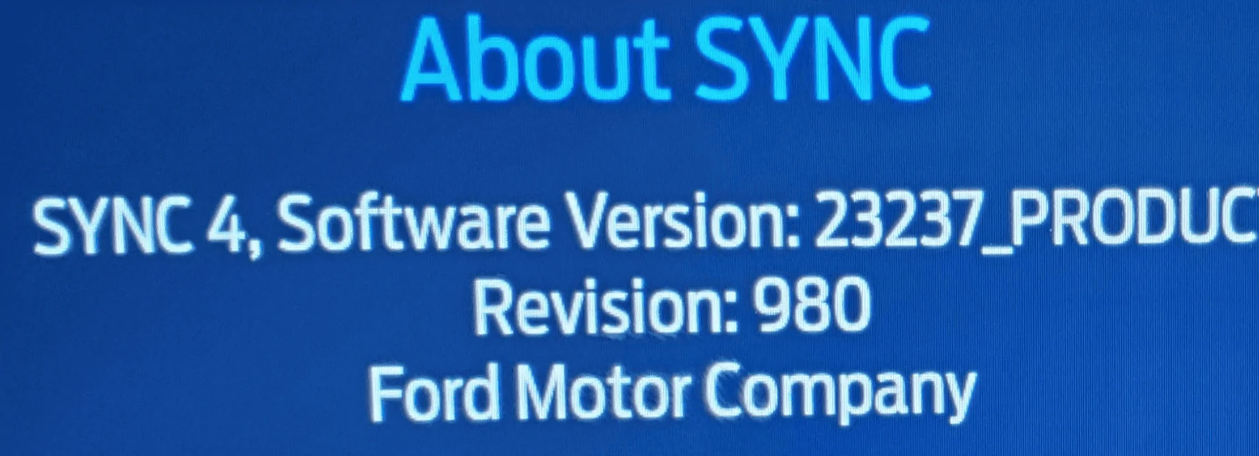

Is your truck already on Sync 23167?
Edit: A member if the ICE forums with a 2022 PowerBoost had a new APIM pop up in FDRS. He installed it last night and got this:
Ford F-150 Lightning Lightning Software Updates using FDRS 1697641480344
This means a new APIM OTA is right around the corner.

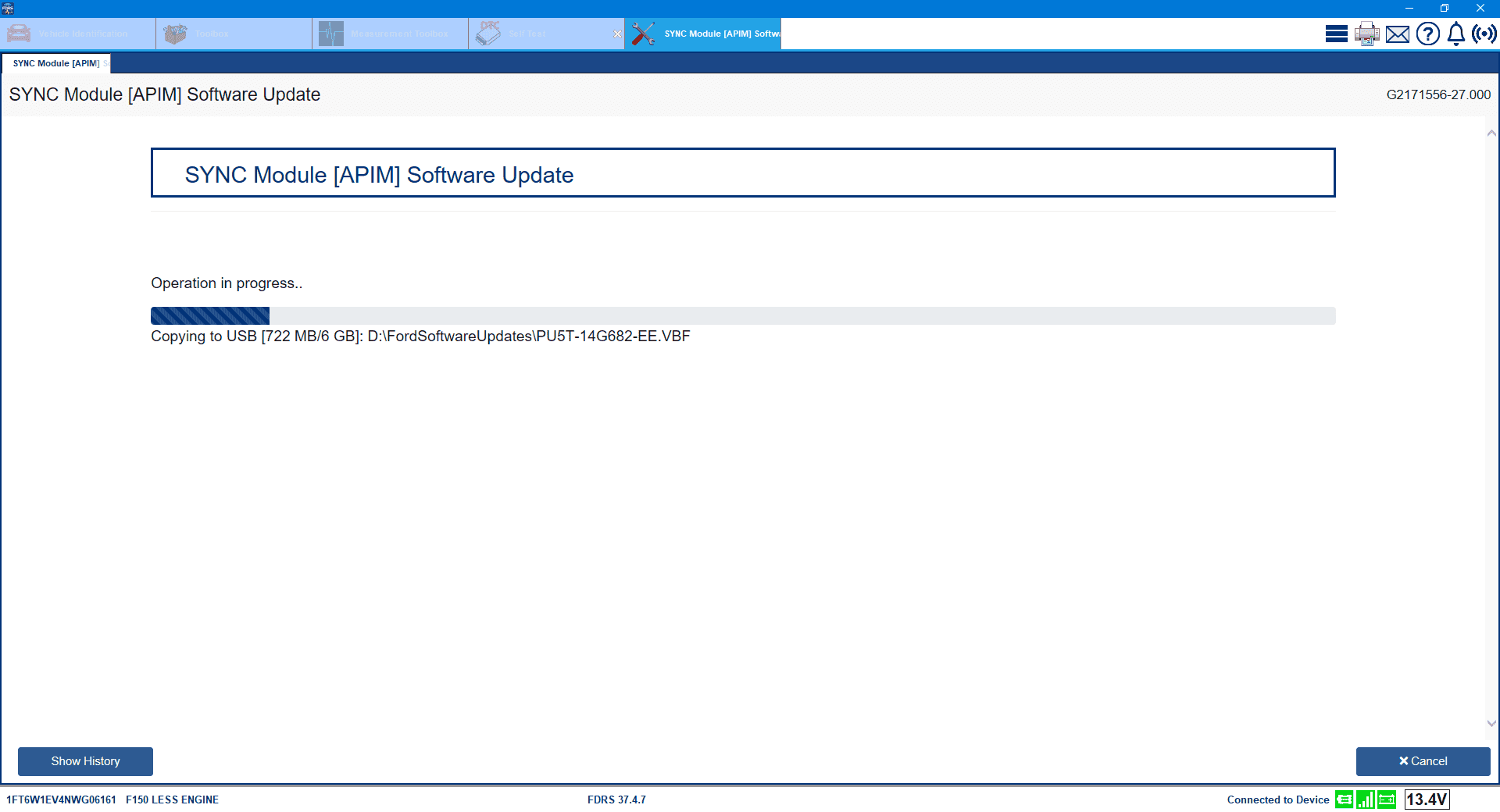

Mine is downloading now via the TCU, but I also connected using FDRS about a half hour ago and put all 6GB of the downloaded files on my USB drive to update tomorrow if the OTA doesn't finish today. I wanted to let it OTA first just to see what the version is and the notes. You don't get to see the OTA version or the notes if you update with FDRS (normally).
It looks like this will be an upgrade for Sync from 915 to (insert future Sync version placeholder here) and an APIM rev from "-EC" to "-EE" according to the application manifest for the download file.
Good man! I was curious about the notes, too. Let us know what it says when it goes through.

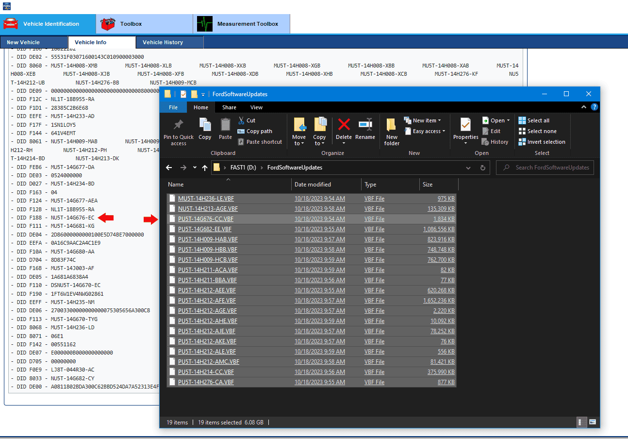

Correction or clarification...
So while out on a drive trying to give the TCU time to do it's thing i stopped by the dealership to see if my wiper motor had arrived for that recall. Nope. And I asked them to check if any OTAs were downloading. Again, nope.
So apparently this is one of those times when the update has been made available to FDRS but has not been put in queue for OTA to my truck yet.
I brought the thumb drive in from the truck and noticed that when I plugged it in that I had been referencing the wrong DID when I previously mentioned what the old and new revs would be.
It's currently "-EC" now and will become "-CC" after the update takes place. Sorry for any confusion I might have caused with that.
Ford F-150 Lightning Lightning Software Updates using FDRS APIM-update_Lightning_18_Oct_23
At 6.08 GB this update is a full Sync update by the look of it. Looks like all the packages and strategy got touched in some way.
