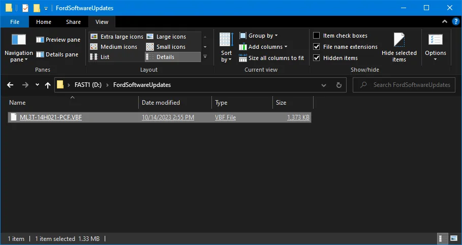

So while on a road trip a couple of days ago my truck downloaded and applied 6.1.0. I didn't post about it because others covered that ground. I did a couple of updates on a relatives Expedition yesterday and was a bit annoyed that the updates refused to clear after they had been successfully applied but then later realized I hadn't changed my time zone on my FDRS laptop to match the zone I was now in and thought that might have something to do with that. I also showed at that time that I had a gateway update on my Lightning (the road trip vehicle) and was curious about that not clearing since I had *just* gotten OTA 6.1.0 applied. So that was weird.
Today while still at the relatives I decided to revisit this gateway update conundrum and noted that after the 6.1.0 OTA my GWM revision was "-PCE"....so when I checked and saw that a gateway update was *still* in my available list I got the USB drive out and this time it did download an update to the drive (took like 2 seconds!) and then when I checked the drive before sticking it in the console USB slot this is what it was:
Ford F-150 Lightning Lightning Software Updates using FDRS Lightning_GWM_-PCF
Yup...1.33 mg, that's it.
And that took my GWM to "-PCF" from "-PCE".
Wow.
No idea what this update did. I checked the usual Sync screens looking for any differences and didn't see any...and Oh BTW I still don't have the "Charge Assist" app as a new app in Sync like others have been reporting. I have it on my Mach-E but it hasn't made it to my Lightning yet despite others reporting that they have it already. (I still just use the charger location app in the nav system menu anyway).

The GWM update you did was the equivalent of 6.2.0.
Ah interesting. I’m in the same boat where I thought getting 6.1.0 would clear the GWM update in FDRS but it did not. I guess I’ll go do it by hand tomorrow!
