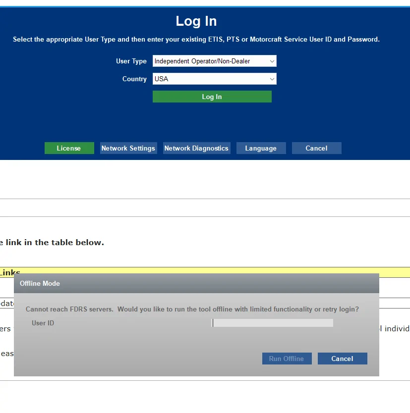

anyone else having issues logging into FDRS?

hmmm.. uninstalled and re-installed and that seemed to fix the issue.
Closing FDRS and re-opening it will fix many issues you may come across, too.

Thatā€™s actually where i started at, but it didnā€™t fix itā€¦ which is why i went to the reinstall. Been at this for a few hours so far. The power supply i got has been rock solid in the 14.2-14.4 range :)
