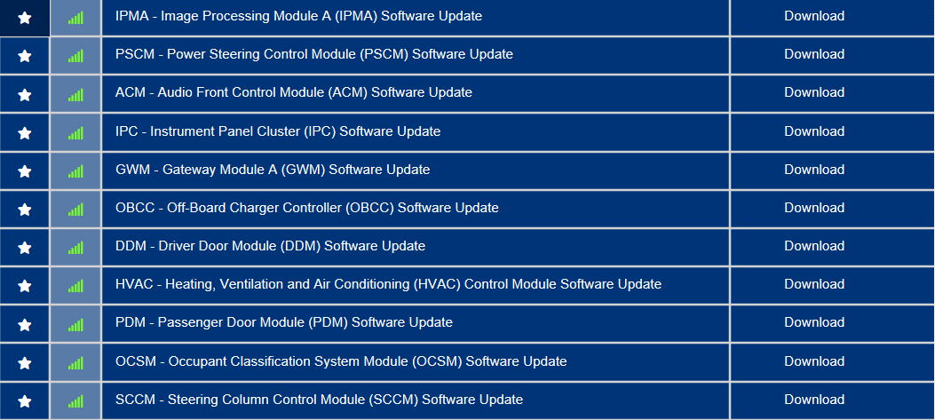

I don't have access to FDRS at the time, but this is what PTS is showing pending for you:
Anything pending for my Truck? Currently at the dealer trying to get them to install at least the Tesla update.
Vin 1FT6W1EV2PWG25879

Here's your list, but good luck getting them to update anything.
Ford F-150 Lightning Lightning Software Updates using FDRS 1712681581046-ji
how would I go about it to get them to update it all? Is it really that hard to update things
You can just try pestering them to do it, but the thing is some of those modules can take a really long time to update and if you have a bunch, it can practically take all day. I think this is one of the big reasons they won't do it.
gotcha, all they do is gotta click update and walk away right? And just go through the steps.
Eh, in my experience it seems to need a bit of babysitting, every module has to be done individually...some of the modules require power cycles... I had one seem to fail and just kept cycling through for hours and I finally had to sort of hard crash FDRS to get it to stop. That turned out ok, it had installed but was failing some sort of check...so, not quite set it and forget it!
Sounds like a pain. Is there anyway to get ahold of this programming for a normal person?
