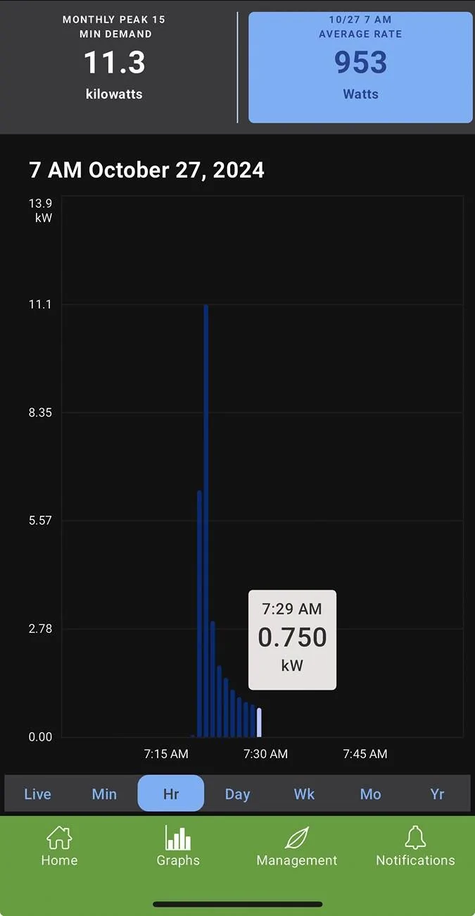

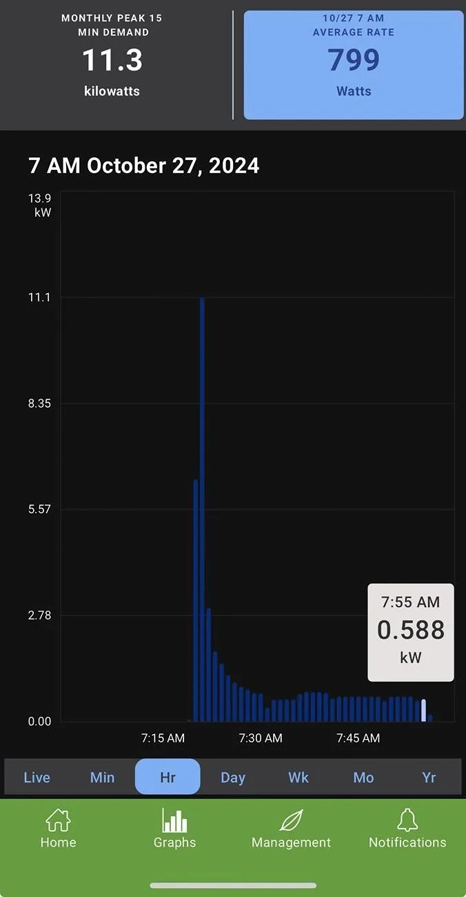

Unless someone has a technical diagram, I am going to use my preconditioning to see how much electricity I use I have it set to high temp ?
55* out side coldish battery
Truck set for 740 departure
7:21 peak 11.5 kw
7:22 drops to 2 kw
7:23 to 7:40 leave less than 1KW
donโ€™t see like a PTC heater is kicking on I know it jumped to 11.5 because the truck was at 89%.?

Yes, that brief peak load was the OBC topping up your HVB.
Like to see the "by the minute" snap shots a couple minutes after the battery returned to 90% SOC goal, I bet it's a lot less than the PTC values of around 5-6 KW

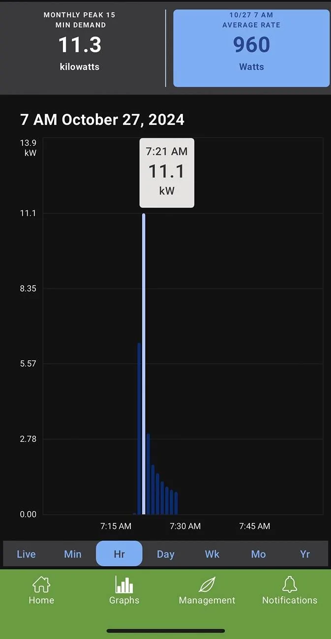

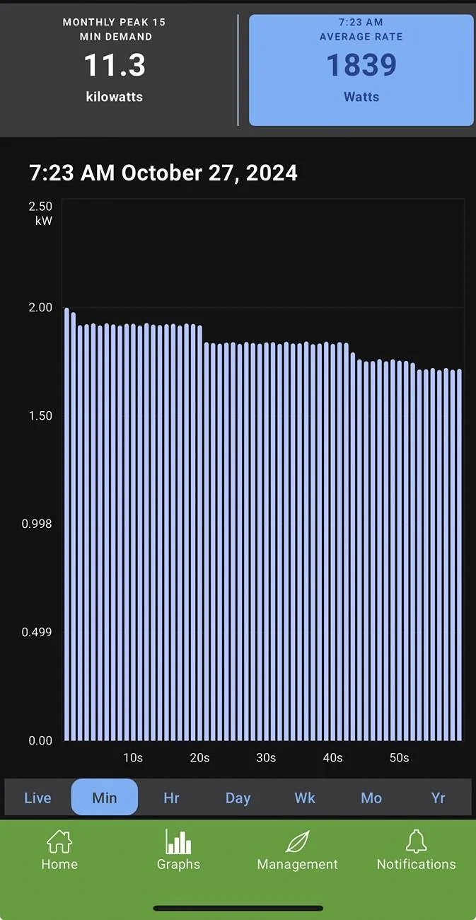

@TaxmanHog
Yep drops to less 2 kw then all the way down to less than 1 kw till I leave

K, as a data nerd, what are you using to generate these? Is this from an aftermarket thing or is it in the ford app (which I obviously don't have yet since I don't have a truck yet)?
