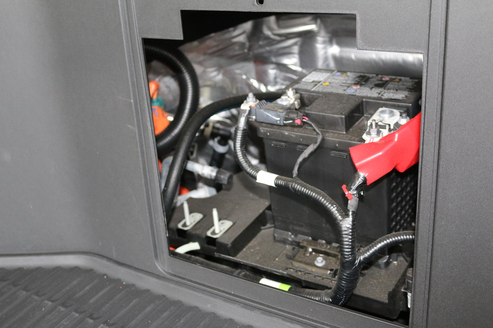

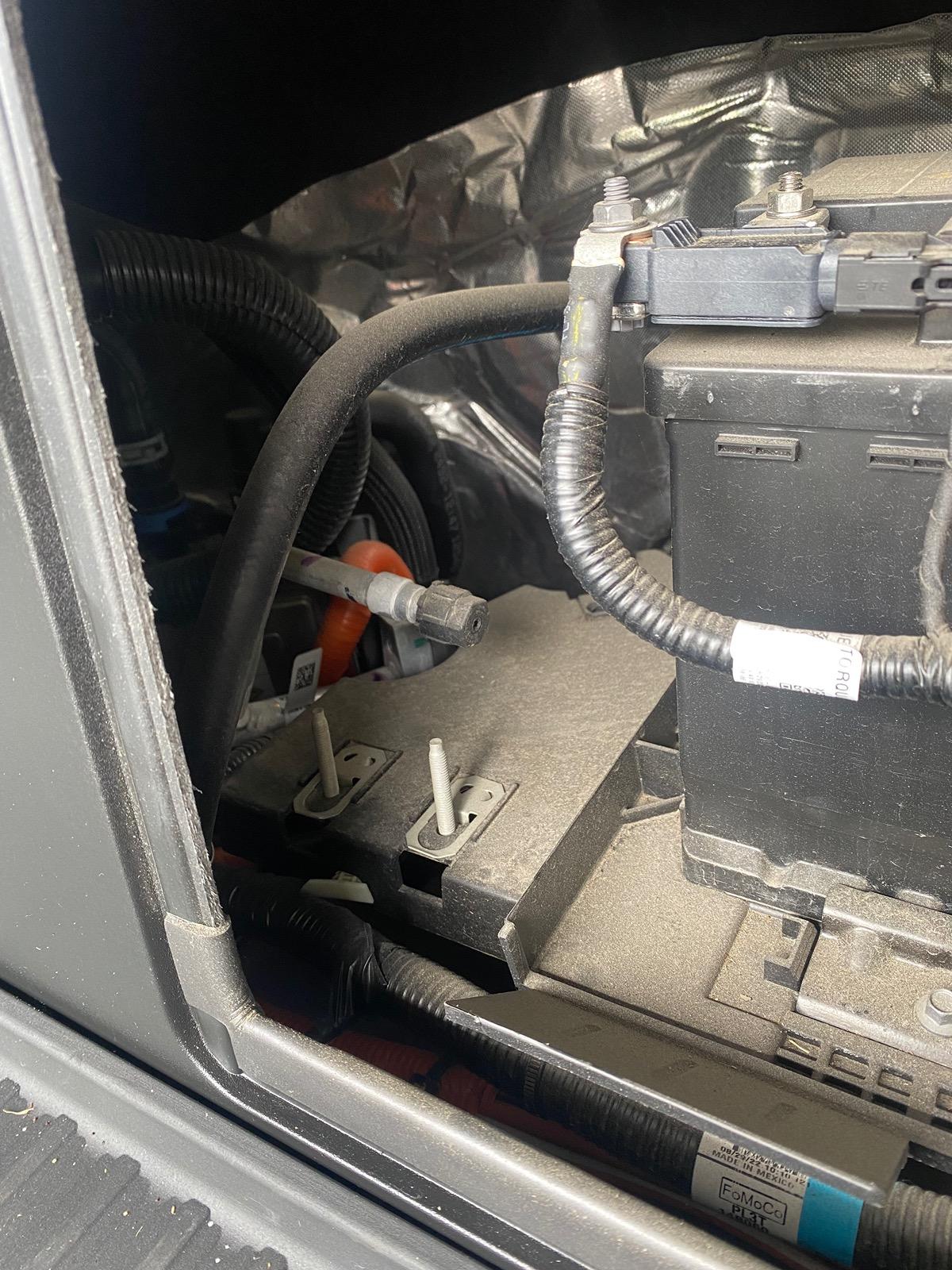

I know it’s not actually missing, I’m guessing a chiller went here at some point. Just wondering what was supposed to go here?
Looks like a service port for A/C or cooling/heating HV battery/drive train system

Yes I am aware of what the service port is. The mounting plate with the bolts sticking up out of it is what intrigued me to ask. Consensus seems to agree that non-max tow vehicles have the chiller placed on the passenger side of the battery. Max tow have the chiller on the drivers side.

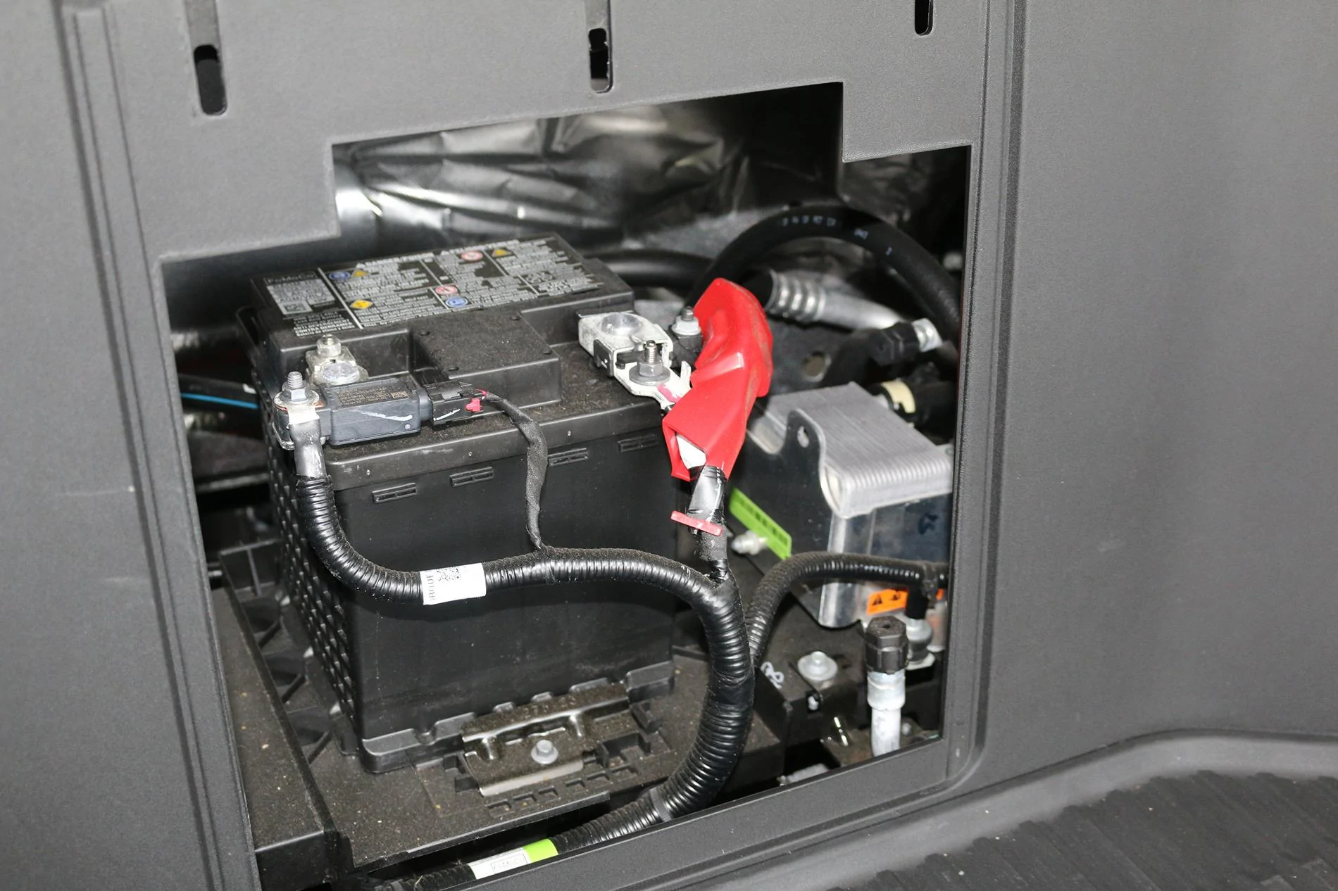

The part we are talking about is a "chiller". Every Lightning has one. It is on the passenger side of 12v battery and connects to the single compressor. This single compressor controls temps for cabin, battery and motors.
For trucks with Max Tow option, the chiller instead connects to a 2nd compressor that they have. That 2nd compressor is used to maintain temperatures for battery, motors but not the cabin. It seems for routing purposes they moved the chiller to the driver side since it connects to the 2nd compressor which is mounted further back on the truck.

Confirming my ER with Max Tow has the power train chiller on the drivers side of the LVB.
It chills the hot glycol coming from the battery, onboard charge controller, PPOB and EDM's.

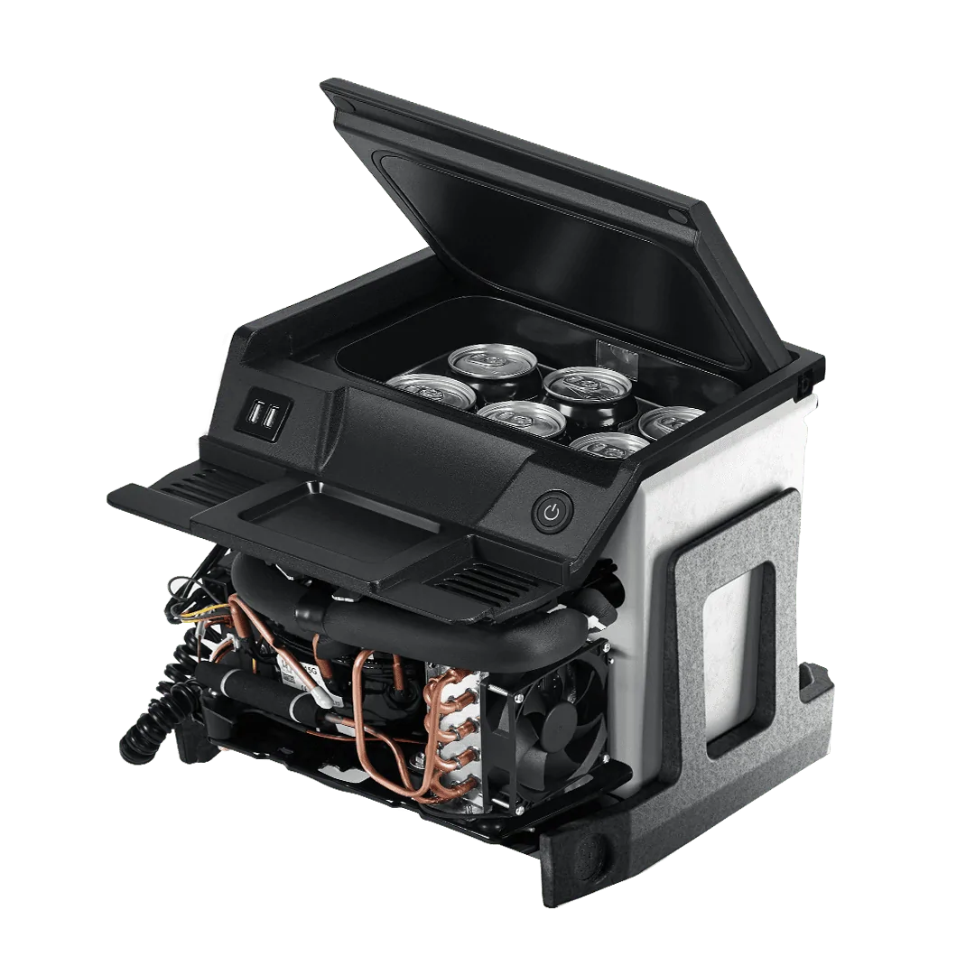

What I am hearing is that Ford offers great aftermarket support and ensured that regardless of whether you have max tow or not, there is plumbing in place for this:
Ford F-150 Lightning Missing part? E0401-00810-B1_2_1080x
I guess that’s why the console fridge is so seemless to upgrade.

I have the MAx Tow package and a chiller on the driver's side, two mounting posts on passenger side:
Ford F-150 Lightning Missing part? IMG_5620-battery compartment right drivers side.JPG
Ford F-150 Lightning Missing part? IMG_5621-battery compartment left passenger side.JPG
Oh dang, after I used the Lightning to jump another vehicle, I forgot to put the red plastic back on the battery terminal...back outside I go.

Don't believe that is true. It seems the truck only has the one chiller. With Max Tow you get an additional compressor , but no additional chiller.
The chiller is placed on passenger side of 12v battery if non-Max tow. The chiller is on driver's side of 12v battery if you have the Max Tow option. Believe this is so they can easily connect the chiller to the 2nd compressor used in Max Tow.
