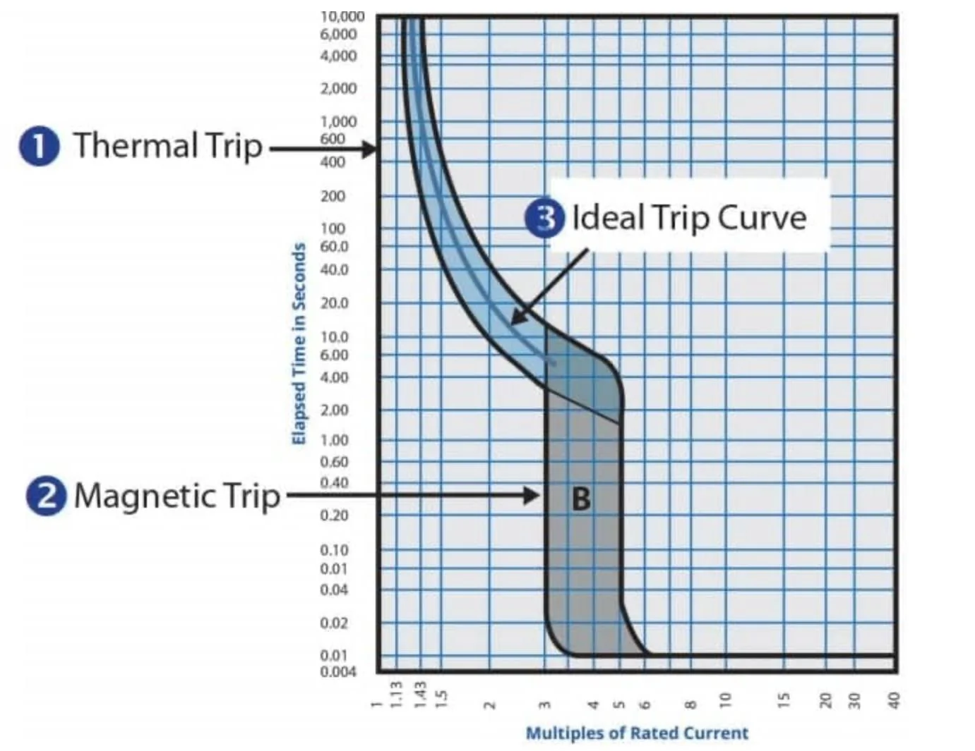

I haven't seen any testing of this. I believe the webasto go units are rated 32a but only draw about 30a continuous. I bought mine on the open market, it's Ford branded and labeled 32a but doesn't trip the 30a breaker I had in my garage.
I think Rick did some testing of this when the new dongle was introduced with the Lightning. I don’t remember how detailed it was.
Drawing 32A on a 30A breaker may never trip it, but that doesn’t make it safe.
