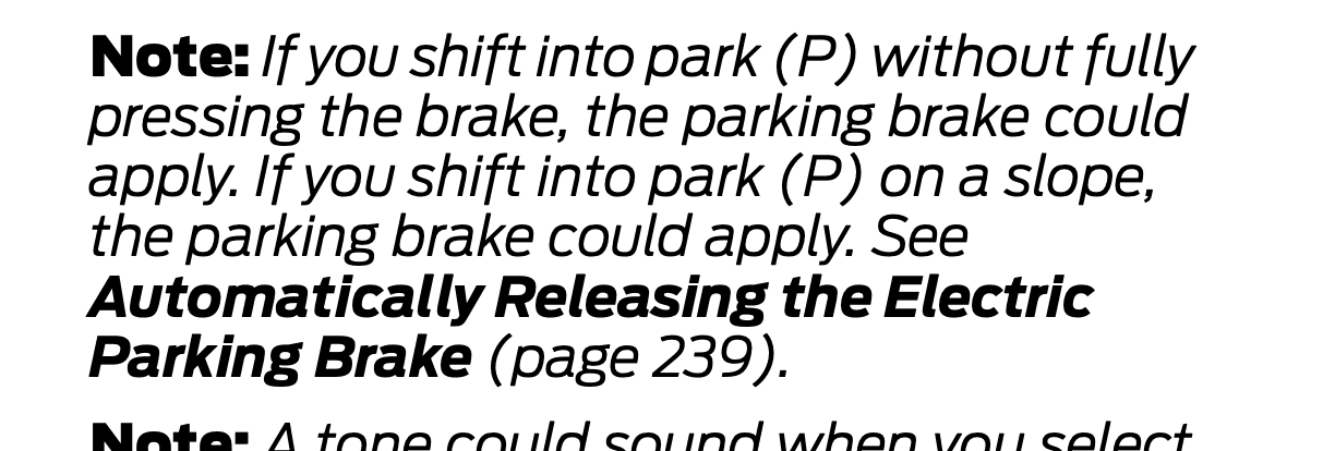

So I got out for a quick errand and did some testing. So at home on the driveway slope if I put the truck in park it will set the parking brake every time. If I pull forward it automatically releases. If I attempt to go backwards (the slope is down away from the garage) then I must press the accelerator at least 3 times or manually release the brake.
Also in a flat parking lot - the brake would release automatically either direction. The key is that I also had to set the brake - so it is on me to do so. At home the truck is setting the brake on its own.
Per the manual, this is not Hill Start, it just determines to set the brake on hills. From the manual:

Ahhh, you know, I have had to press the pedal more than once to disengage. I never paid enough attention to know if it was when I was reversing. Thanks for the feedback!
