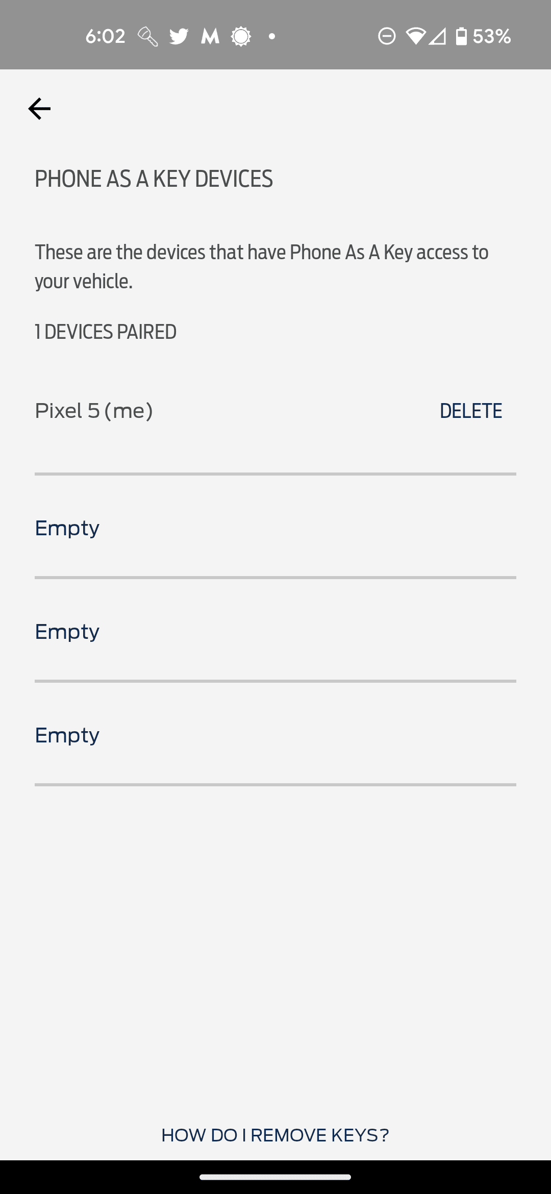

I took delivery yesterday (Fri Sept 2nd) and was able to setup PAAK at the dealership. I only received one key fob. My Blend Date was July 27th.
Ford F-150 Lightning Phone as a Key issue Screenshot_20220903-060234
