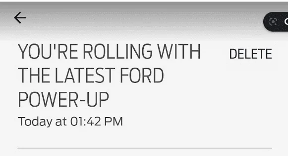

Mine updated a 1:42 pm, this was after we had arrived at our lunch destination, the truck had been off maybe a whole 10 minutes when I received the alert.
I received no alerts prior to this today, no flags on the main screen of a pending update, nothing, I'll assume this update happened while driving or shortly after I parked the truck, maximum window of occurrence was 1:05 to 1:42 pm.
The lunch destination is right next to huge cell tower that probably has multiple carriers broadcasting from the location, this restaurant might become my regular monthly visit, we only go there a couple times a year!!!! Had a great Strawberry Chicken & greens salad.
4.1.1 alert on Ford Pass

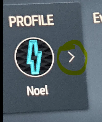

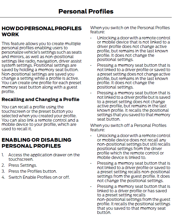

Read through owners manual there are prerequisites to set up if you have not done so yet, pages 542 to 544 in the 2022 owners manual title "Personal Profiles"
If you have a personal profile, but find it's not loaded, tap the right > to open up the selection menu for guest and stored personal profiles, select the desired profile. Often Guest profile loads while a truck is in departure or remote start mode of operation, frequently I need to select my own profile.

I have profiles setup, but reloading them is a step I was unaware of, and explains some of what I experienced.
