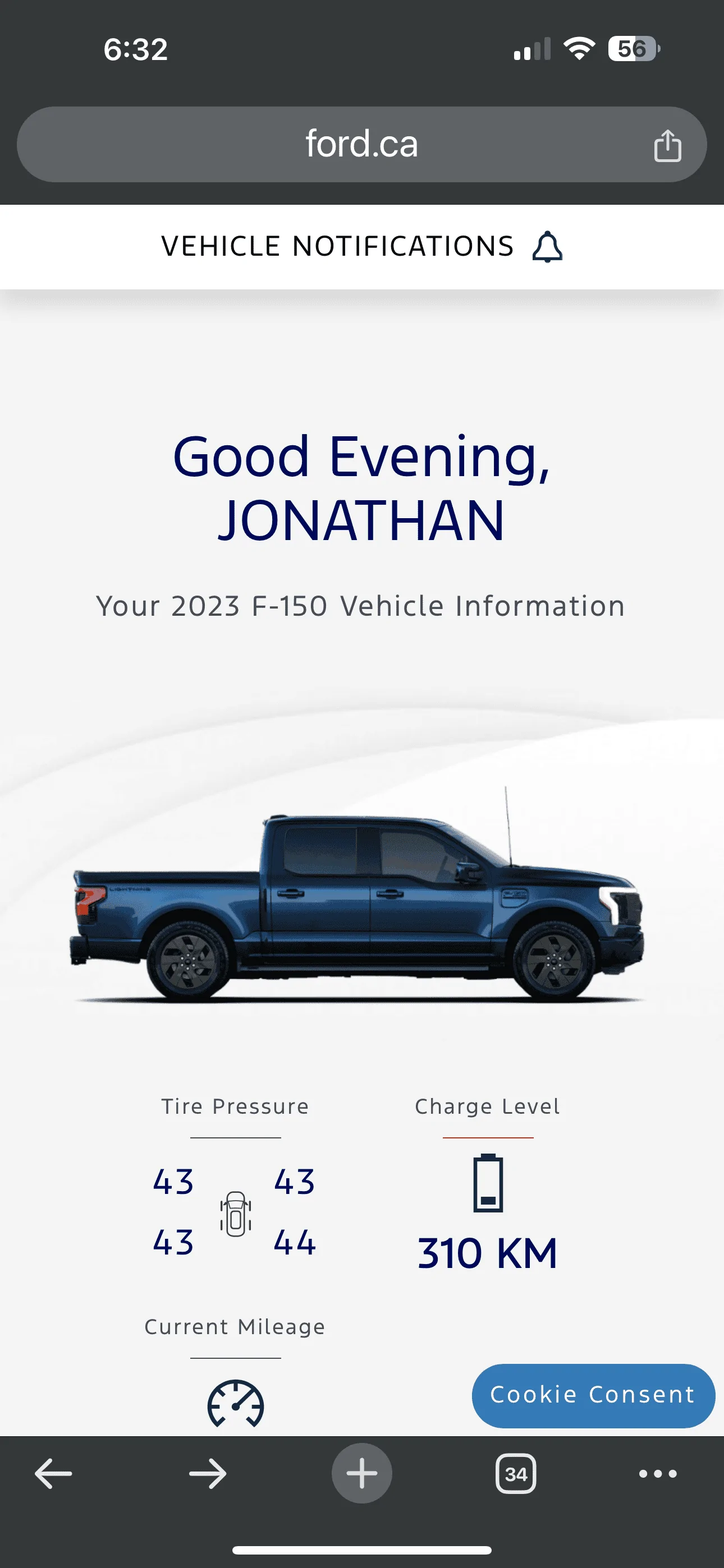

So I need to share this based on the 12v SOC discussion earlier in this thread. When I sign on to my account from my phone, I see this:
Ford F-150 Lightning Power-Up OTA 6.8.0 - Smart Changes: Center Screen 2023-12-18-18.32.43.760
Absolutely no sign of the 12V SOC, hence my confusion earlier.

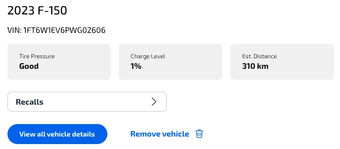

When I sign on to the desktop site with my laptop, I see this:
Ford F-150 Lightning Power-Up OTA 6.8.0 - Smart Changes: Center Screen 1702942876011
Charge Level is showing the 12V SOC. Amazed at the variation in information between the two devices.
Note, my 12V battery has failed this week, hence the 1% (yes it is the real number). It was a watch item for me and I expected it to fail based on the history of increasing low 12V battery messages in FordPass. Bad cell and going in for a new one on Thursday. I managed to squeeze in Powerup 6.5 with a battery charger attached before it failed hard. No more OTA updates for me this week :unsure:
