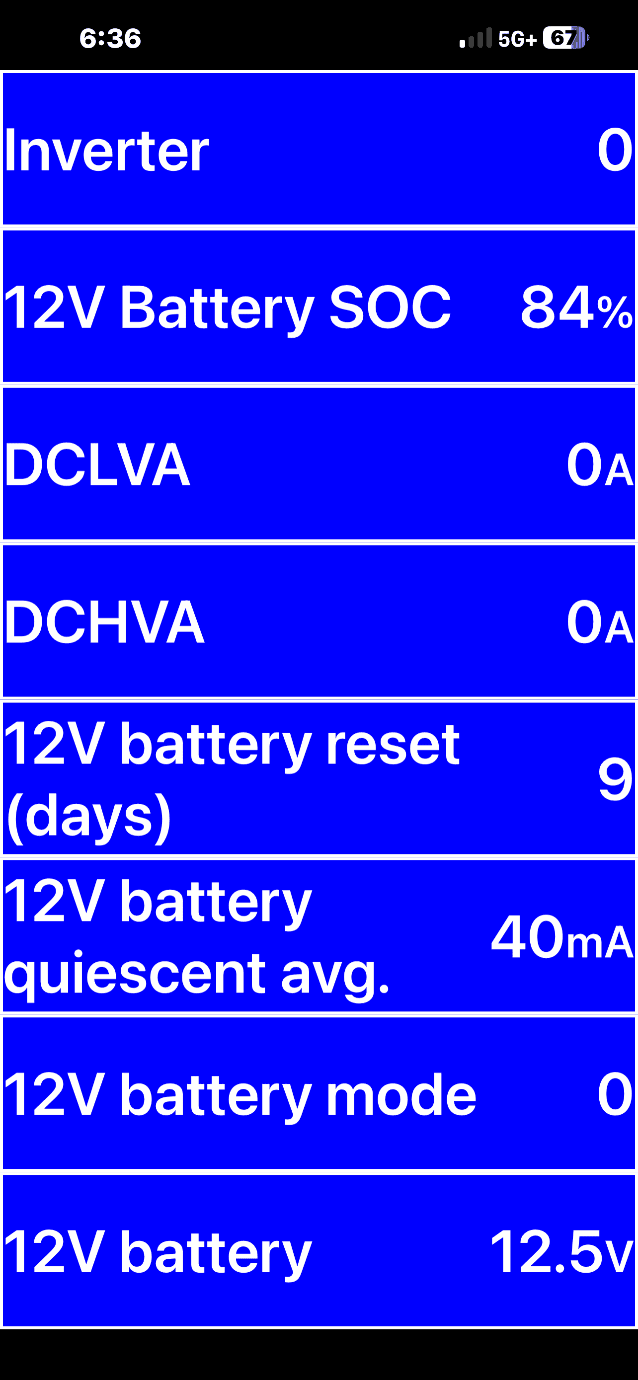

He also said the 50 mA drain was high, need to check that. If anyone else uses Car Scanner app, can you check your 12V battery quiescent avg.? Mine is 50 mA:
Mine seems to run in the 30-40 mA range.

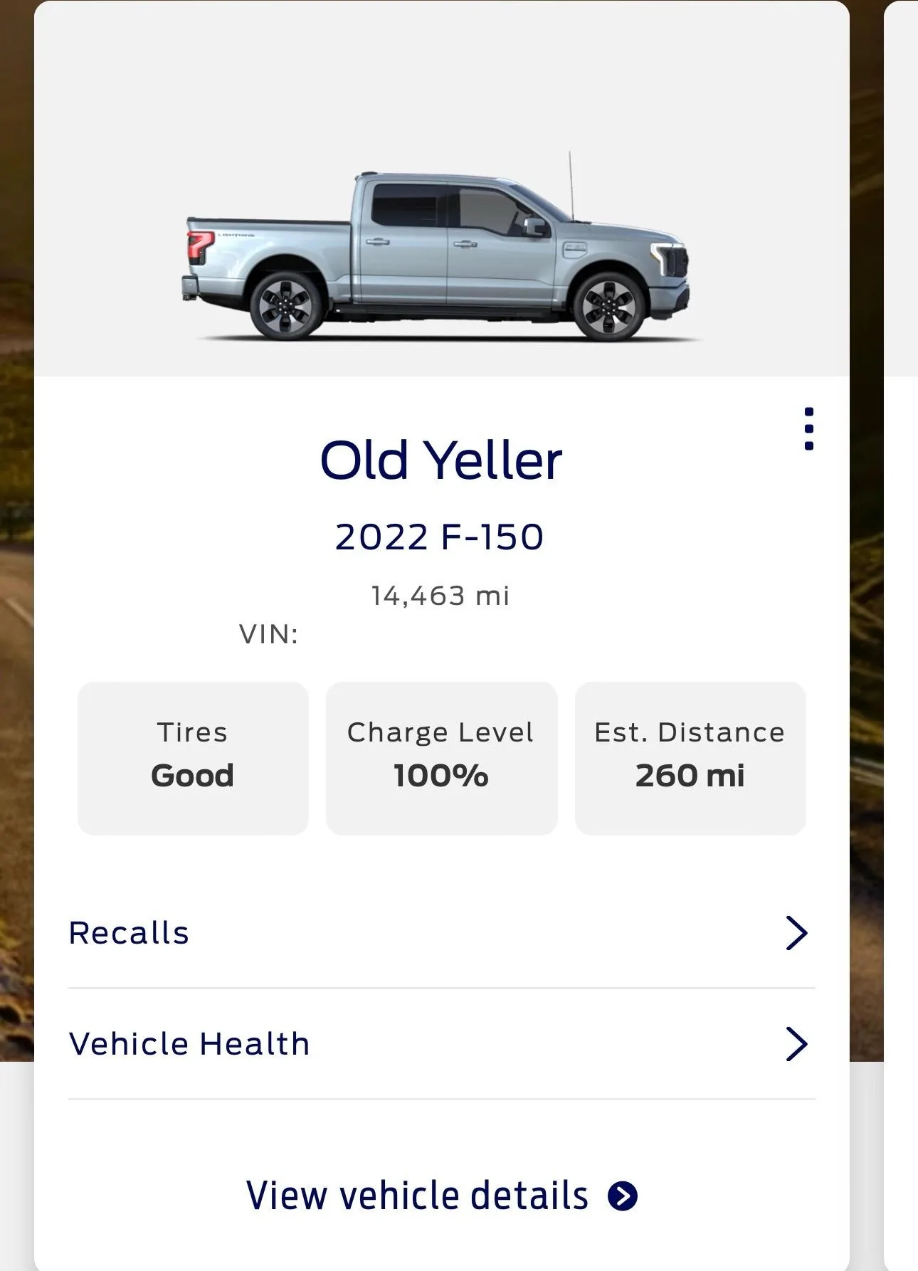

I checked the Ford website and it says I have 100% battery, while I am 90% charge on the HVB.
Your 12v LVB is at 100%
While your traction battery is at 90% for 260 miles, imputed 288 mile at 100% and that's a seasonal adjustment for weather conditions.

If you’re referring to the 12V battery SoC, you can see it in your Ford account at Ford.com.
I have not seen the 12V SOC displayed on the Ford.com status. The charge level in your screen shot shows the HVB SOC. Have you seen the 12V SOC?
