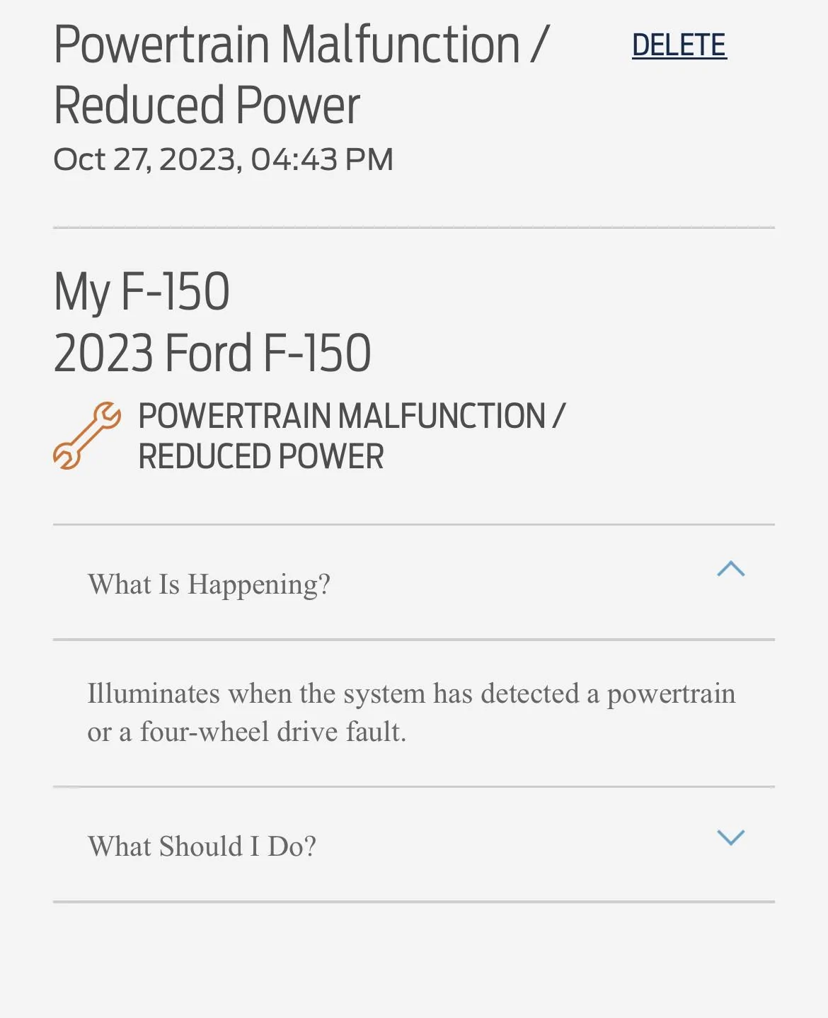

Well folks,
I got the first error.
No noticeable performance issues but got the power train warning and a needs service message.
Taking the lightning in Monday.
