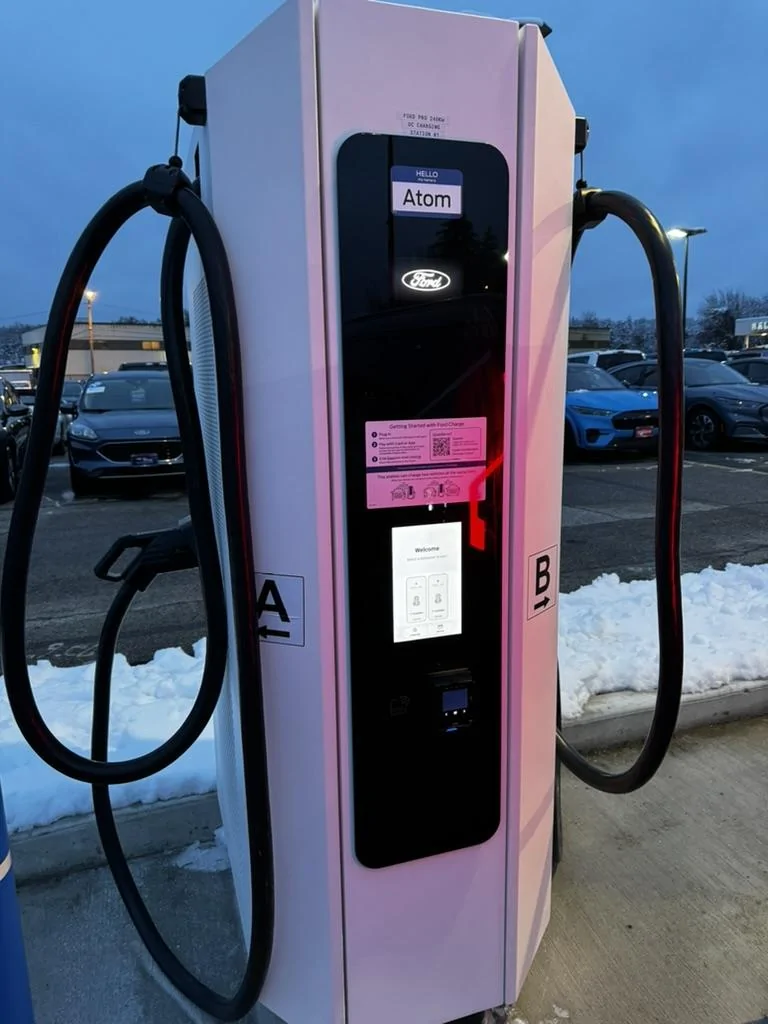

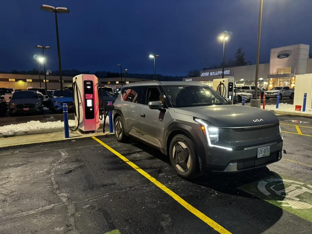

Small world. I've spent most of the last two months in Concord visiting my parents, and I know Grappone Ford well. Their DCFC units are apparently the first Ford-branded chargers to make it online, and it's good to see their service department leading the way as well. A bit off-topic, but these chargers are located right near the entrance and fed my mom's new EV9 at 165 kW. We need more dealers like this!

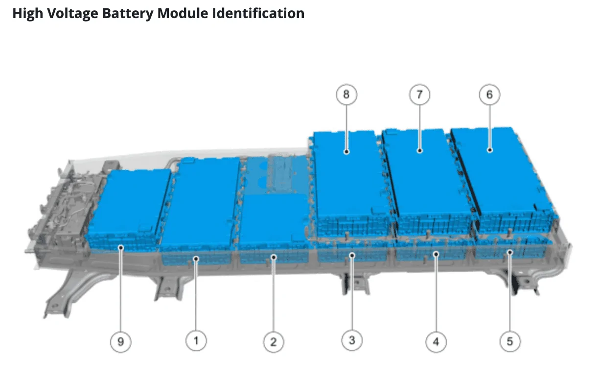

That sounds a lot like what happened to mine. I could charge to 65%, but then it errored when it hit 60% at the dealer. Mine was a failed module 7, which sits in the top row of the pack.
They’re replacing module 1 on my truck. Hs there been any rhyme or reason to the modules that fail?
They are replacing module 9 on mine. Cell #96 was producing less voltage than it should have.
