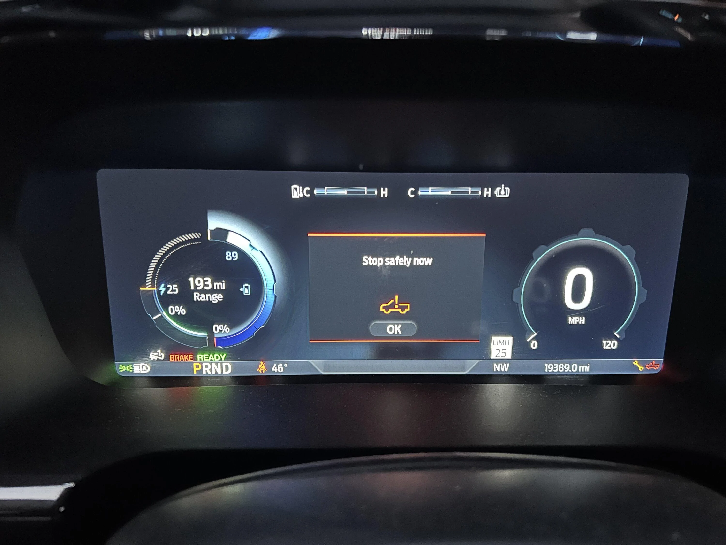

Here we go again. I’m back after 6 months since my last battery module replacement. Woke up this morning to drive 2 hours to a job site only for my truck to throw a wrench and limit power to 25%. Thank goodness I was able to find a coworker to cover for me. Truck has been perfect until one (well two now) morning you walk out to turn it on and all hell breaks loose. First replacement I believe was at 14,000 miles and now I’m at 19,000 been a rough 5000 miles.

Man! I was waiting for a video from the last time. But this is bad. I wonder if it is the same module they replaced
Dang I know. Sorry about that. I actually made a video but it was pretty long winded and I didn’t really like it, so I never posted. I’ll be remedying that shortly.
On the bright side the dealer is well versed in this now and took care of me. They said if they get parts I should have it back in 1.5-2 weeks if it ends up being the module (99% sure it is). Gave me a power boost xlt for now.
