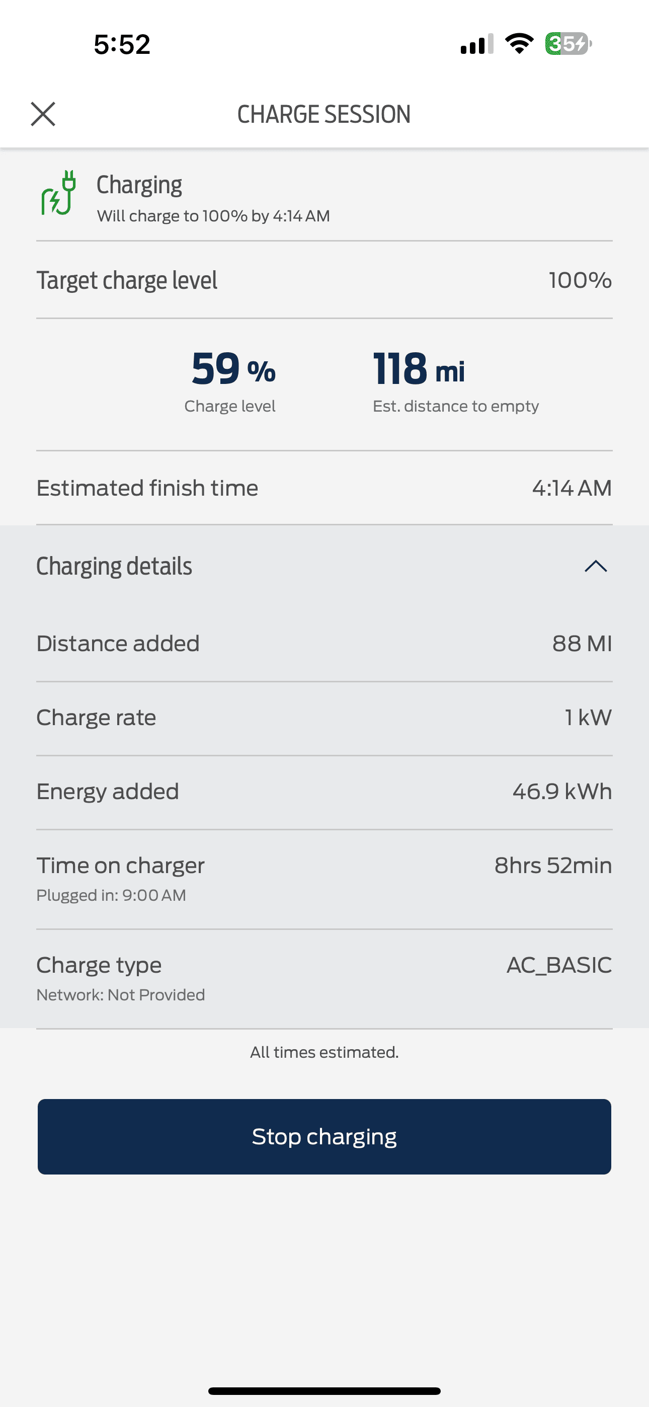

My service writer called me today to tell me they’re working on it. They had to fully charge the battery to keep up their testing, and it looks like they only had a 5 kW charger. Which is sad because they’re the biggest Ford dealer in Minnesota.
They plugged in at 26% at 9:00 this morning, and my app showed 5 kW. I checked a half-hour ago, and it was down to 3 kW at 58%. Now it’s only pulling 1 kW at 59%. It gave up on me at 66% the night before I drove it in, so it looks like the truck isn’t gonna let them fully charge it. I think this is a strategy to prevent fires.

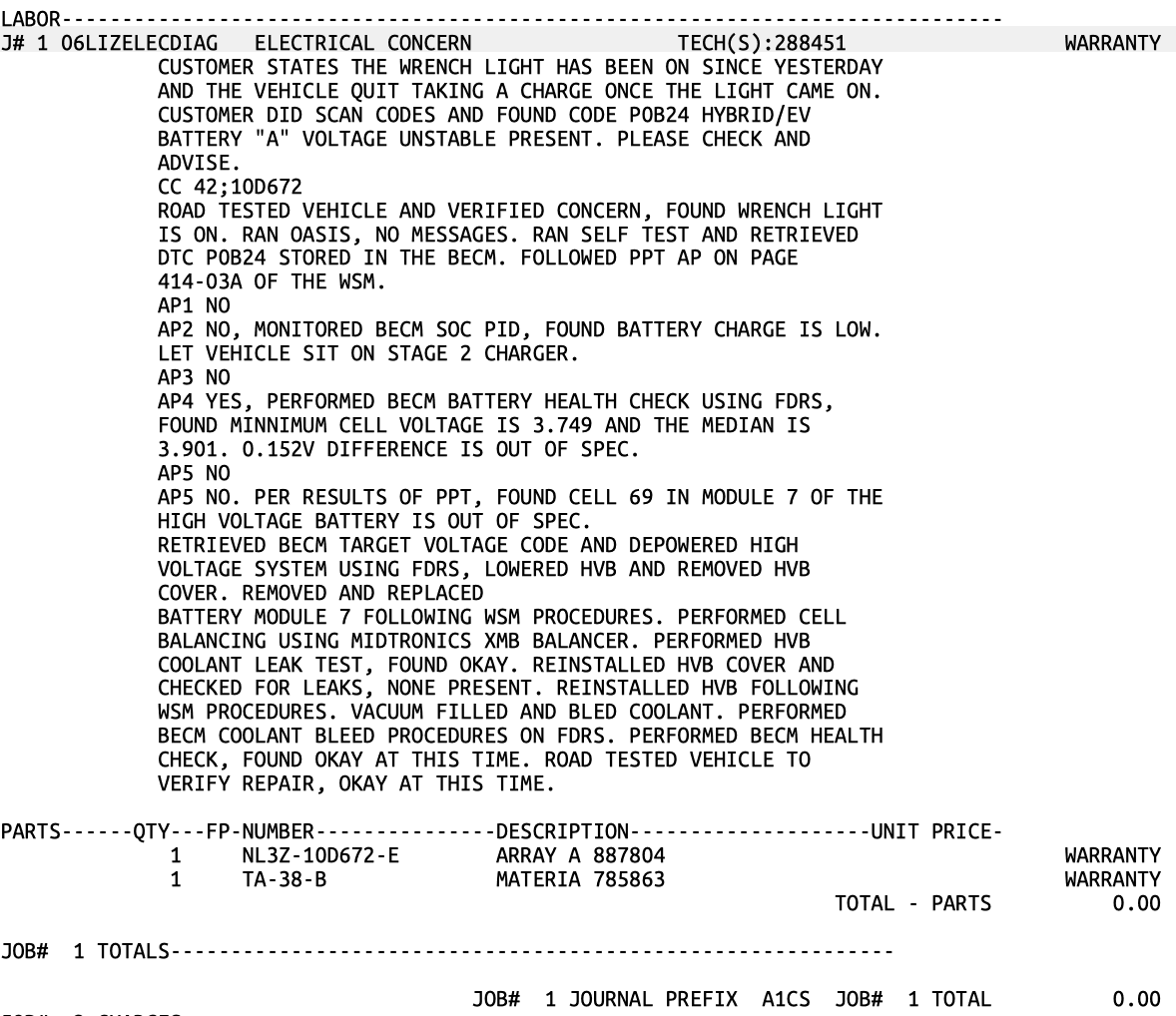

The service writer called this afternoon to tell me the tech diagnosed a failed battery module. The new part is ordered and should arrive in 5-7 days, which is about what I expected.
I can be patient while they figure this out, but there’s so way I’m keeping it beyond the warranty period if it happens again. I’d feel better if this didn’t seem to be such a common issue, but I don’t see myself keeping this beyond the warranty period.

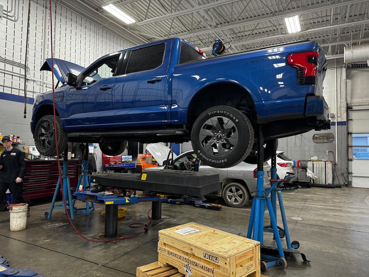

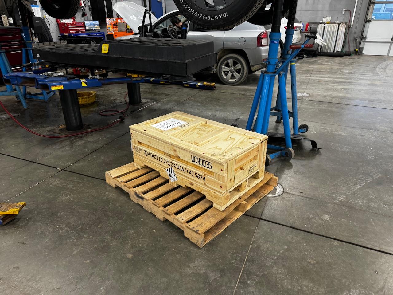

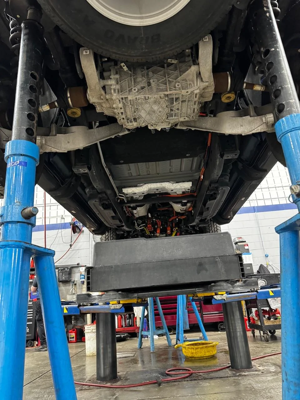

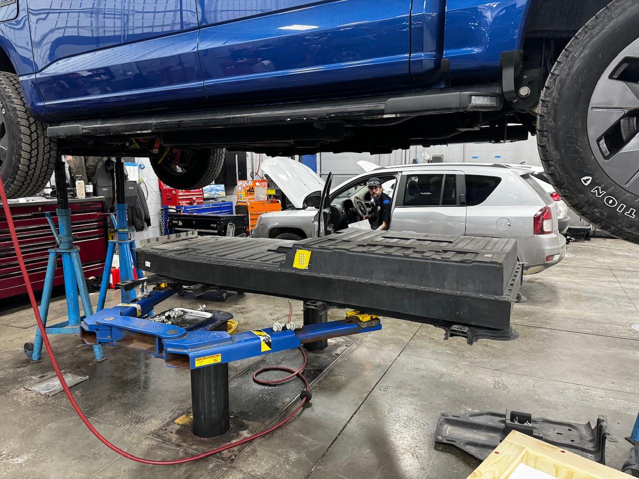

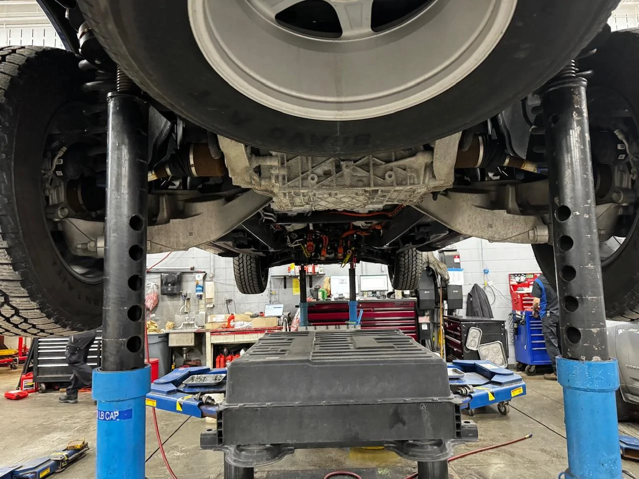

My dealer is moving pretty fast. I showed up to turn in my loaner car, and they were already working on it. The new module showed up on Friday, and it’ll be ready tomorrow. That’ll be twelve days if they get it done.

I got a call from my dealer earlier this afternoon. They wrapped it up this morning and it's all ready to go after 13 days in the shop. I'll pick it up next Thursday when I fly back from New England.
The service writer couldn't tell me what it would cost out of warranty because they didn't order or bill for the battery. It's apparently an exchange that's managed directly by Ford. He said labor would have been about $3K, though.

I joined the non-exclusive Powertrain Failure club yesterday after the truck sat idle while I was on an 11 day international trip. I contacted my service department at Grappone Ford in Concord, NH, as soon as the problem occurred, and they were able to pull the error codes over the air. They had me bring the truck in the next day, and had an ICE F-150 loaner waiting for me. Late yesterday afternoon I heard from the service tech who identified the problem as in cell #96 in Module #9. The module replacement kit and thermal interface kit have been ordered.
On the way down to the dealership I noticed that the Powertrain Failure message and the service vehicle soon icon had disappeared and the truck appeared to be operating normally. The service technician explained that the night before the truck had received an OTA update to 6.8.0, and the update process canceled all the error codes. The problem was still there and he found it quickly even though the warning lights were off.
