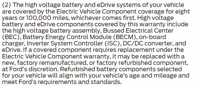

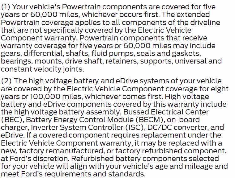

Bumper to bumper is 36k/3yr, but the battery is covered for 100k/8yr so you will be covered for the repair. Hopefully it goes smoothly and quickly. I'd like to think Ford/Dealers are getting better at this.
I agree about the dealers getting better at it. Aside from the hiccup with the cyber attack, they were pretty spot on with what needed to be done, how long it would take to get the parts and how long it would take to do the work.
