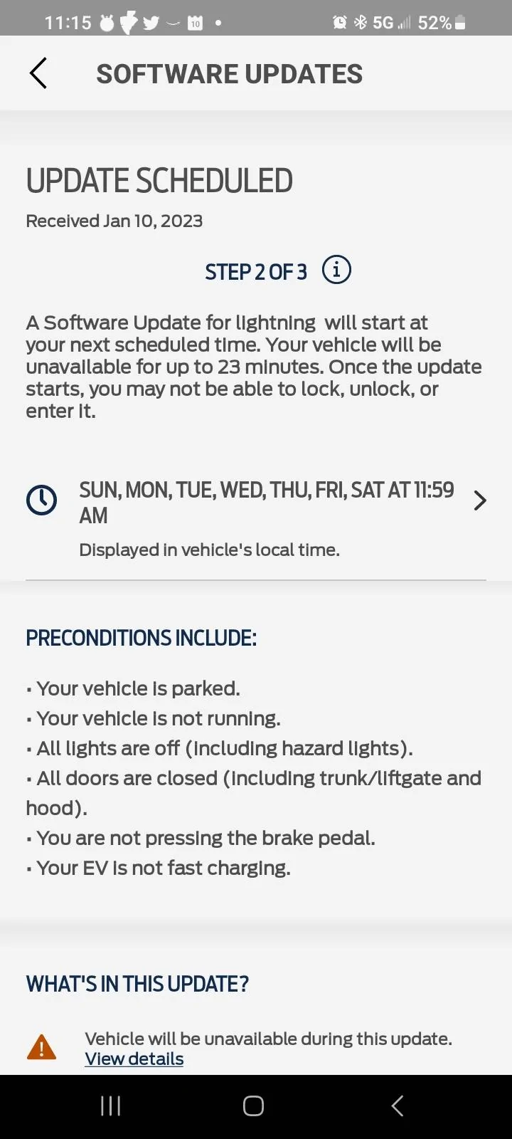

I just received this notice today, my wife has the truck at work and I think I will reschedule incase there's a error after update. I'll just start the lightning just before time for update. I would get it the one day my wife drives it to work on a rainy day in California.

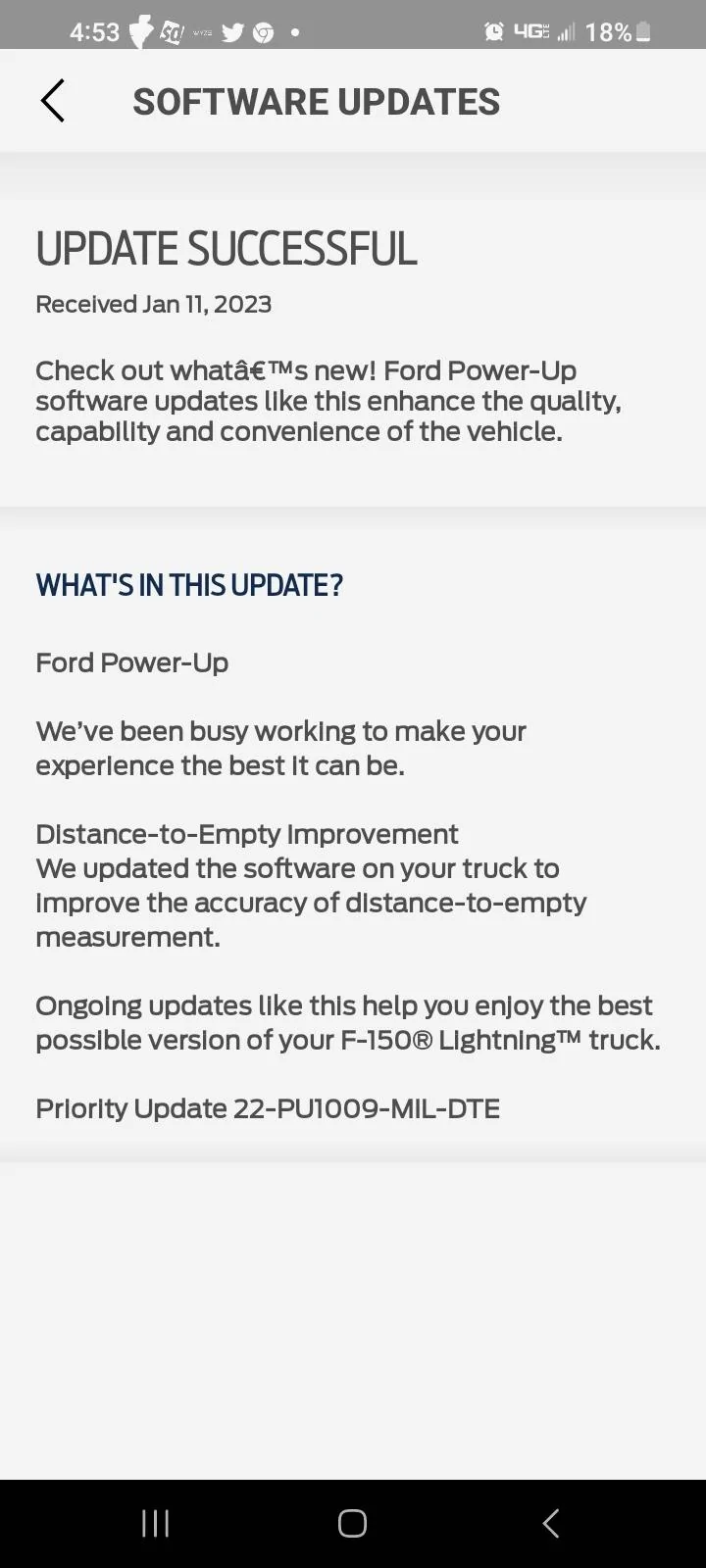

Ford F-150 Lightning Priority Update: 22-PU-1009-MIL-DTE Calculation Screenshot_20230110_111526_FordPass

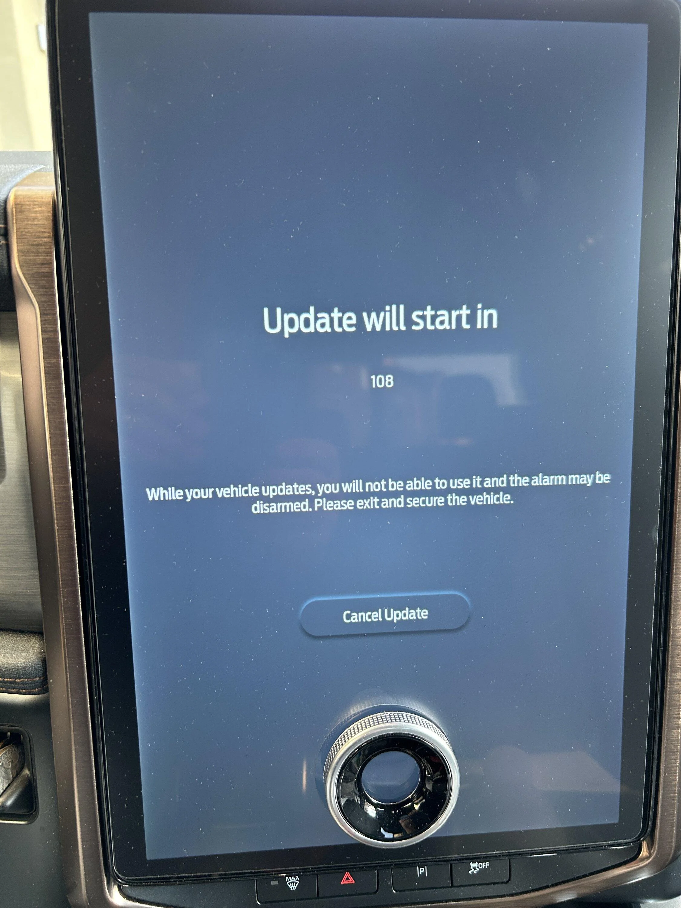

Still been getting the update failure notification. Last thing I haven't tried is charging the 12V battery. I've had my 12V battery hooked up to a trickle charger all morning. Should I try the update with the trickle charger connected, or disconnect first?
I don't think it matters much - it's more of the AT&T signal and Ford's server being available for the OTA.
I had to try multiple times at different locations.
Finally, got mine to update manually by connecting to my home WiFi, parked outside to get a good cell signal, pressing the download now, and hopping out of the truck while locking with the key fob (not the door handle).
Also to prevent interruption, I walked the key fob away from the truck to prevent it lighting up (welcome lighting).
