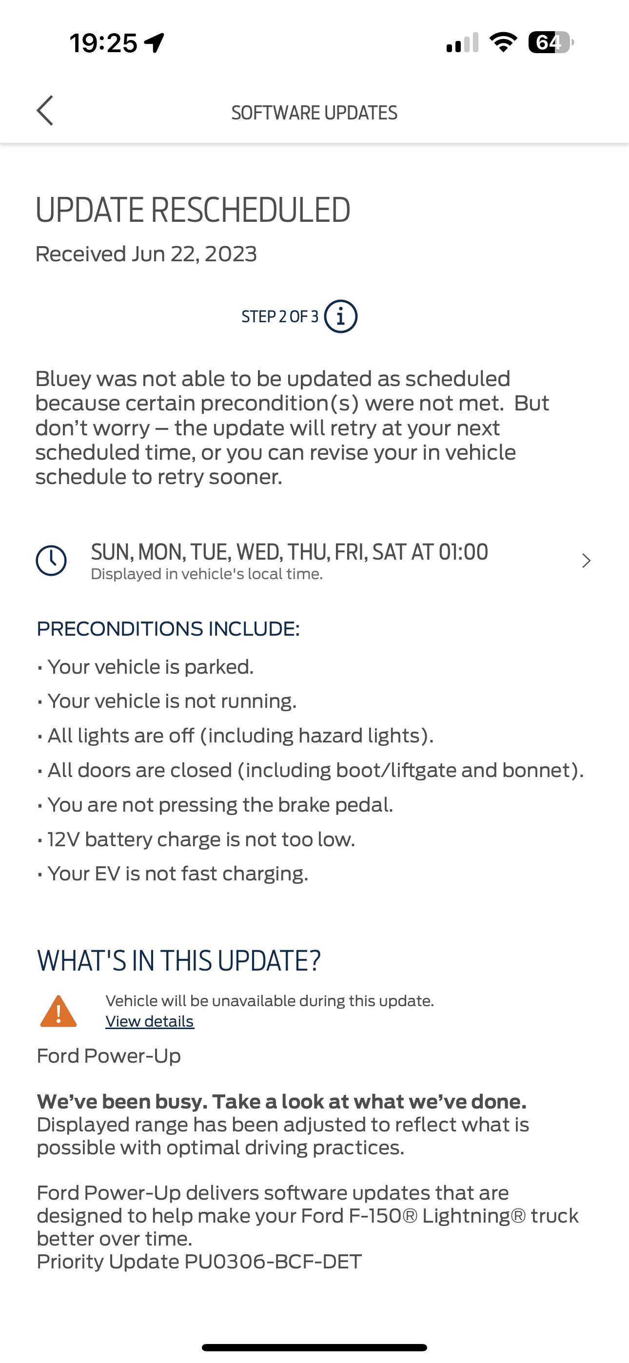

For the first time, I can’t get this update to install. Tried about 10 times now. The other priority update installed yesterday with no issue and I got this one an hour later.
I drove it about 30 mins today thinking the 12V battery may be low from the first update but still no change. Any ideas?
Same here as it’s failed for me a bunch of times today. I was thinking of putting power on the 12v, but the notices say the trunk needs to be closed…. Here’s what I’m seeing in app.
Won't install for me either. I had an earlier update that didn't want to install and by doing it manually and making sure my phone and fob were out of reach it worked. May not have been a phone/fob issue, but the update took. This one won't go after several attempts. And I've driven a bunch, truck at a good SOC... Was plugged in...

I just tried again, but first connected my OBDLink MX+ to see the 12V charge before this attempt. It was at 75% charge. After the next failure, it was down to 71%. Still no success.

I tried to manually force the install like 4 times yesterday after various drives to no avail. I ended up plugging it in and letting it get to the 80% like normal and at my regularly schedule update time of 3am the update finally took!
I haven't driven it but the immediate thing I noticed is it broke my charge limit as it ended up charging the truck all the way to 100% after the update (I have monitors on the home and can see when the charger stopped at 80%, and then when it started again after the update completed) so that sucks. (@Ford Motor Company)
The Fordpass app still shows my limitation of 80%. I'll update if I figure anything else out.

Quick note and no guarantees but I could not get this one to install (first OTA I have had trouble with in the year plus of ownership).
All I did different was turn the headlight dial to OFF and plug it into my Level 2 with charging active. Installed first try after 5-6 unsuccessful attempts. I think the charger plugged in gives the 12V the number it thinks it needs.
I plugged in and l started the update. I didn't let it sit on the Level 2 for any length of time and I was at a low SOC (about 37%).
Just worth a try and simple vs all the other tricks of the trade.
