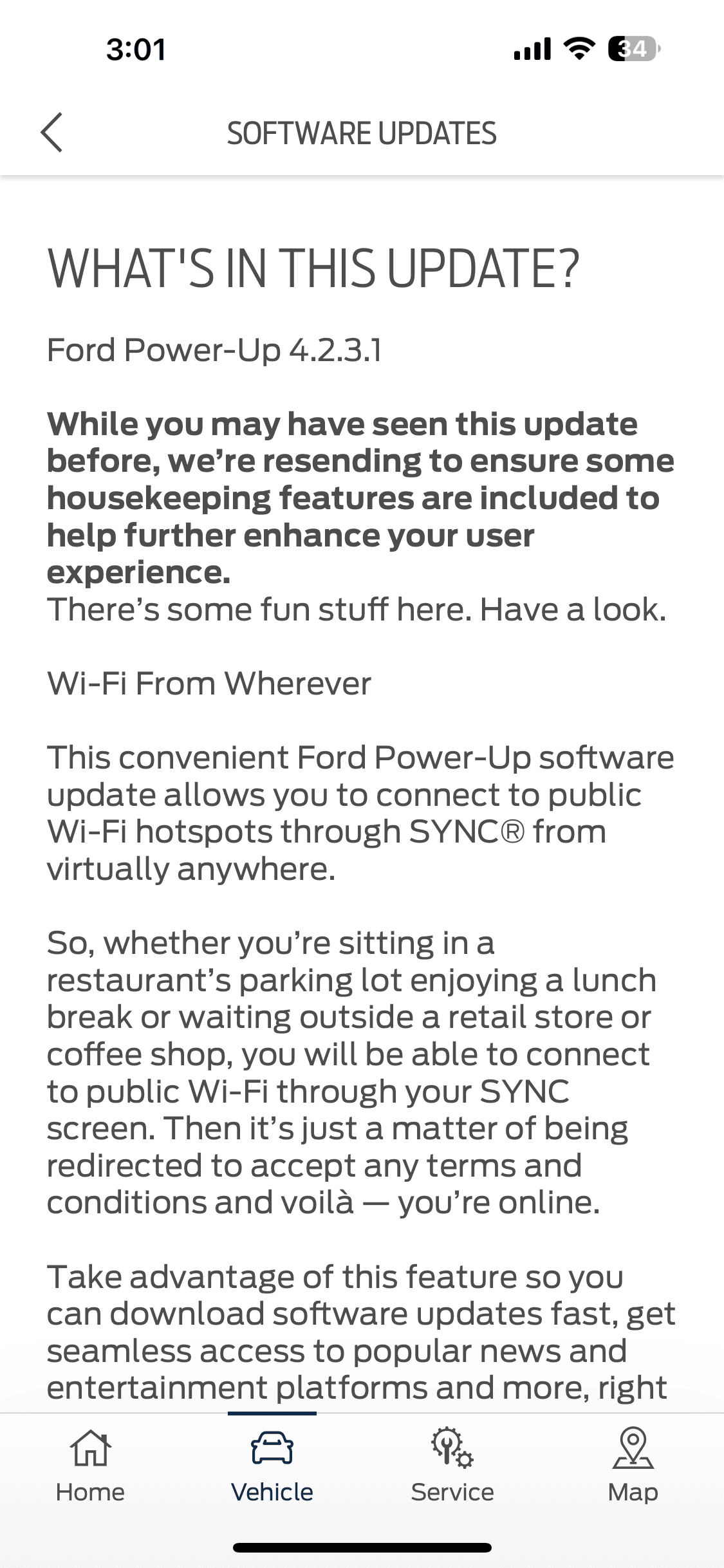

A little off topic but also involves an OTA update. I received an OTA update on June 8th (Ford Power-Up 4.2.3.1). It occurred automatically without error and I was alerted via the app upon its completion. I was not at home when the OTA occurred. Its worth noting that Tesla recommends: To ensure the fastest and most reliable delivery of software updates, connect your vehicle to Wi-Fi.

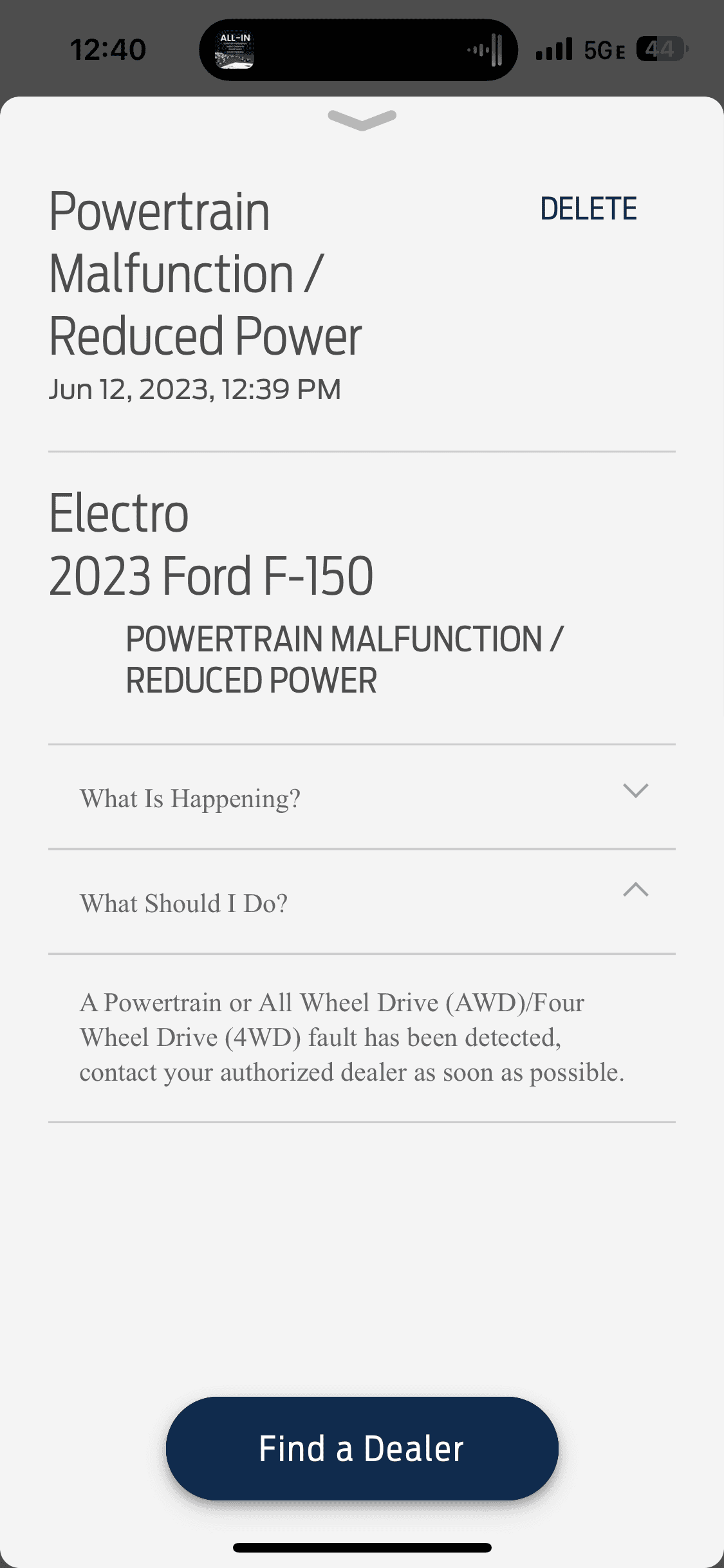

Today I received a troubling alert (Powertrain Malfunction/Reduced Power) via the app and truck after pressing the start button. I shut the truck off and then on to find the alert gone. I drove the truck and everything was normal. I called the dealership and they said the truck had 25 or so faults and corrected itself when the truck restarted. They said the truck apparently "freaked out" and they can't say one particular thing was to blame. I know Ford is new to this OTA game and I am wondering if there is a correlation? FWIW: I did have modem issues at delivery for 2 months (no app connection) that was later fixed via an OTA.
Truck has 2500 miles

had the same thing happen to me when I installed 4.2.4. As soon as It was installed I got the same errors as you. its not caused by the update per-se, you had the code the whole time. Reference customer satisfaction 23H01. You will probably be getting a new battery module. Sorry to give you bad news. Mine was out of service for almost 4 weeks waiting on an appointment, parts, and a technician.

My truck freaked out with a earlier update, don't recall the version upgrade but it was prior to the UI update. Got several errors and warnings, I shut it off and let it sit unplugged overnight. Haven't had an issue since, that was about 3 months ago and ~5k miles. No email or phone call from Ford so I don't think my truck is part of the 23H01.
