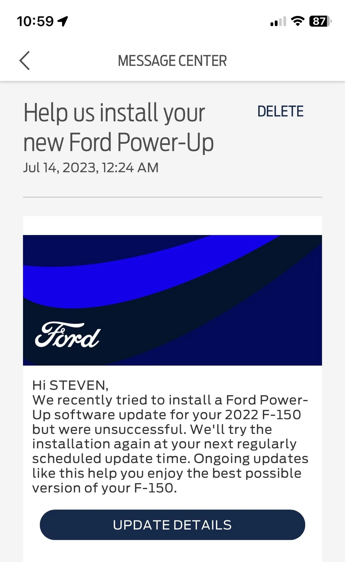

After every failed installation attempt I get a message from Ford to "Help us install your new Ford Power-Up", but have no instructions on what to do to "help". I have asked @Ford Motor Company in another post to please share with us the required conditions for a successful update, or provide instructions to help the update installation process. Crickets.
I think they have half a guy responsible for software development and that dude has never seen a Lightning in person let alone have a chance to test anything. I don’t know how else to explain what I am seeing. And I am not just talking about update procedure. It is everything from operation of their web pages to the apps to the truck software. I totally get what Farley was talking about having outsourced every module and their software and trying to make them work together and have the updates coordinated can be challenging but not putting enough and right resources on it is not the fault of that half guy, it is Farley’s fault.
