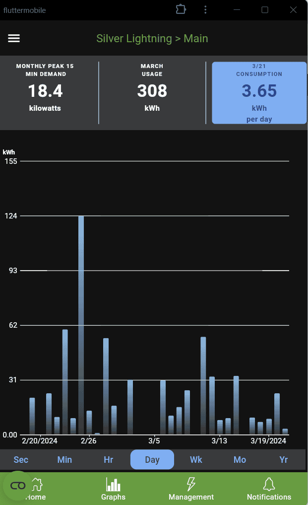

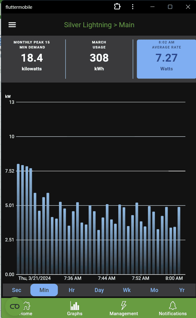

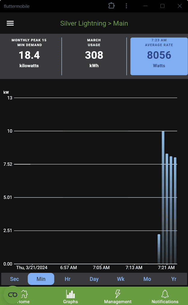

Departure timer (PLUGGED IN) worked perfectly in this mornings chilly 28° windy weather, next few mornings will be sub-freezing conditions.
Up to this point it's been milder in recent weeks, the battery pack still had a lot of latent heat within it, so the total energy used to warm up the battery and cabin was 3.65 KWH, normally 1.5 KWH is consumed with cabin warming alone, the remaining ~2.15 KWH went to battery warming, kicked off at 7:19, for scheduled departure of 7:50, actual unplug & leave time was 8:02 am.

By the day today (charging of pack was last evening)

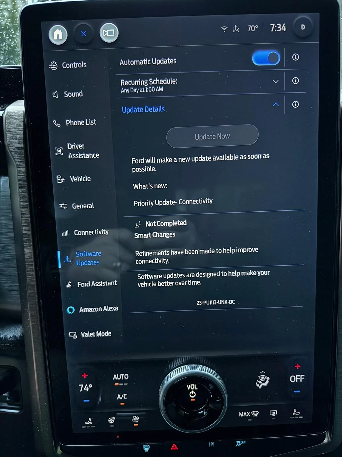

I received this update (kinda - see picture below) about 3 days ago but it does not appear to get installed? I am connected to WiFi and plugged in on L2, LV battery is at 93% and I have no outstanding CSP's. Anybody aware if this will correct itself or what happens next? If I press Update now it tells me there are no updates available.

It may have expired, a new package will be sent in the future [SOON(tm)]
