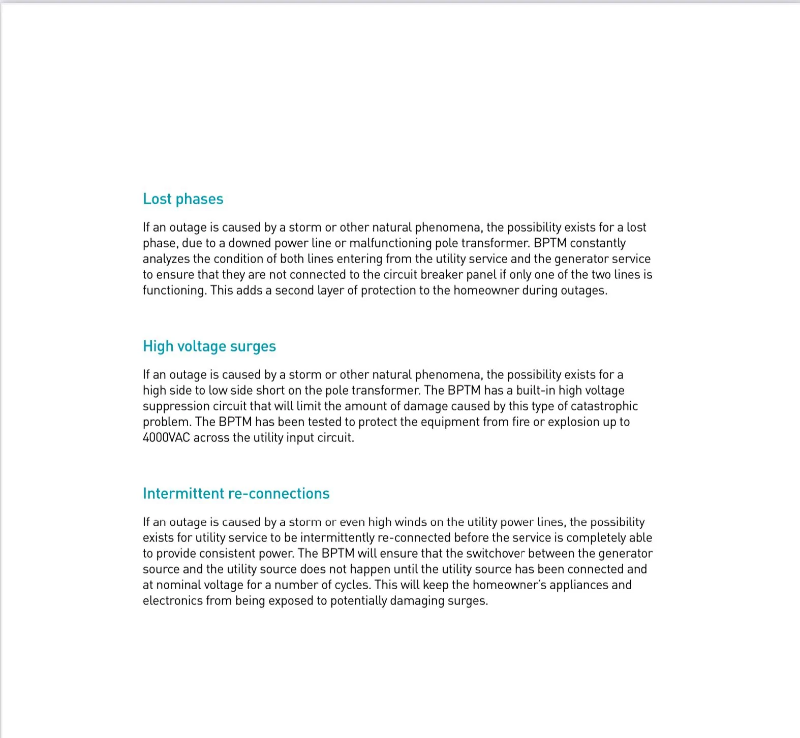

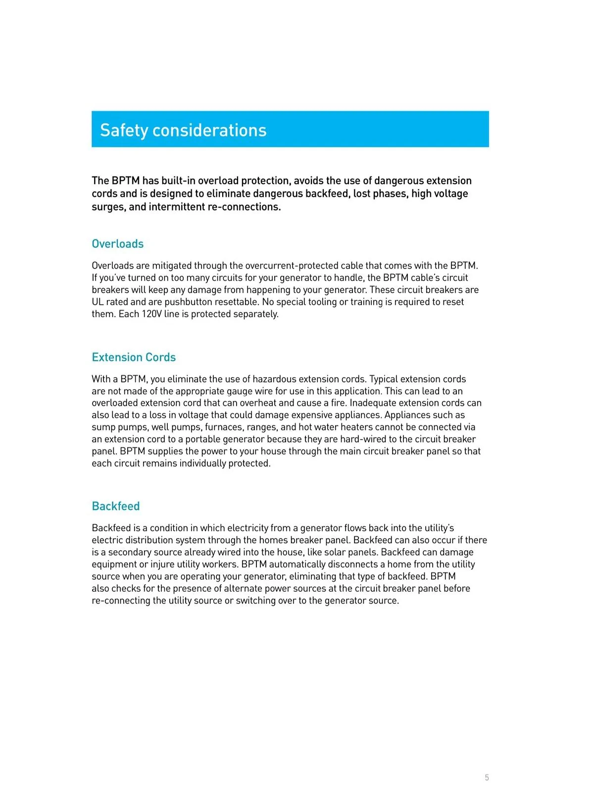

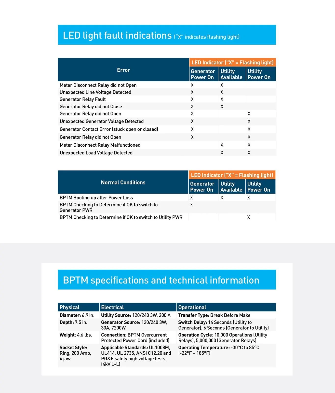

Based on commentary here, I did a terrible thing! I read the manual supplied by PG&E. Pages of interest excerpted below.
Note: As a veteran of many legal encounters, I recommend downloading the manual and printing it out for the truly paranoid. Maybe even put a copy in the safe deposit box! These words are an “express warranty” by the utility provider.

Max 30Amps or 7.2kW load (matches the pro power bed outlet 240Vac available) so one would need to drop excessive loads like hard start air conditioning, etc.
I would think solar systems would need to be dropped as well as the truck may not be able to take in power if fully charged.
Great way to go by saving much higher costs of a separate panel and wiring. Especially if PG&E will provide and install for free!
Get a micro air easy start for your AC's, and they can run
