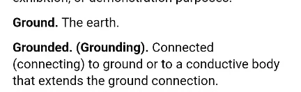

And, just so people aren't confused, these are the definitions that the NEC uses to define bond and ground.
Thank you. You have educated me. So the truck is bonded, but it is NOT grounded from the factory.
