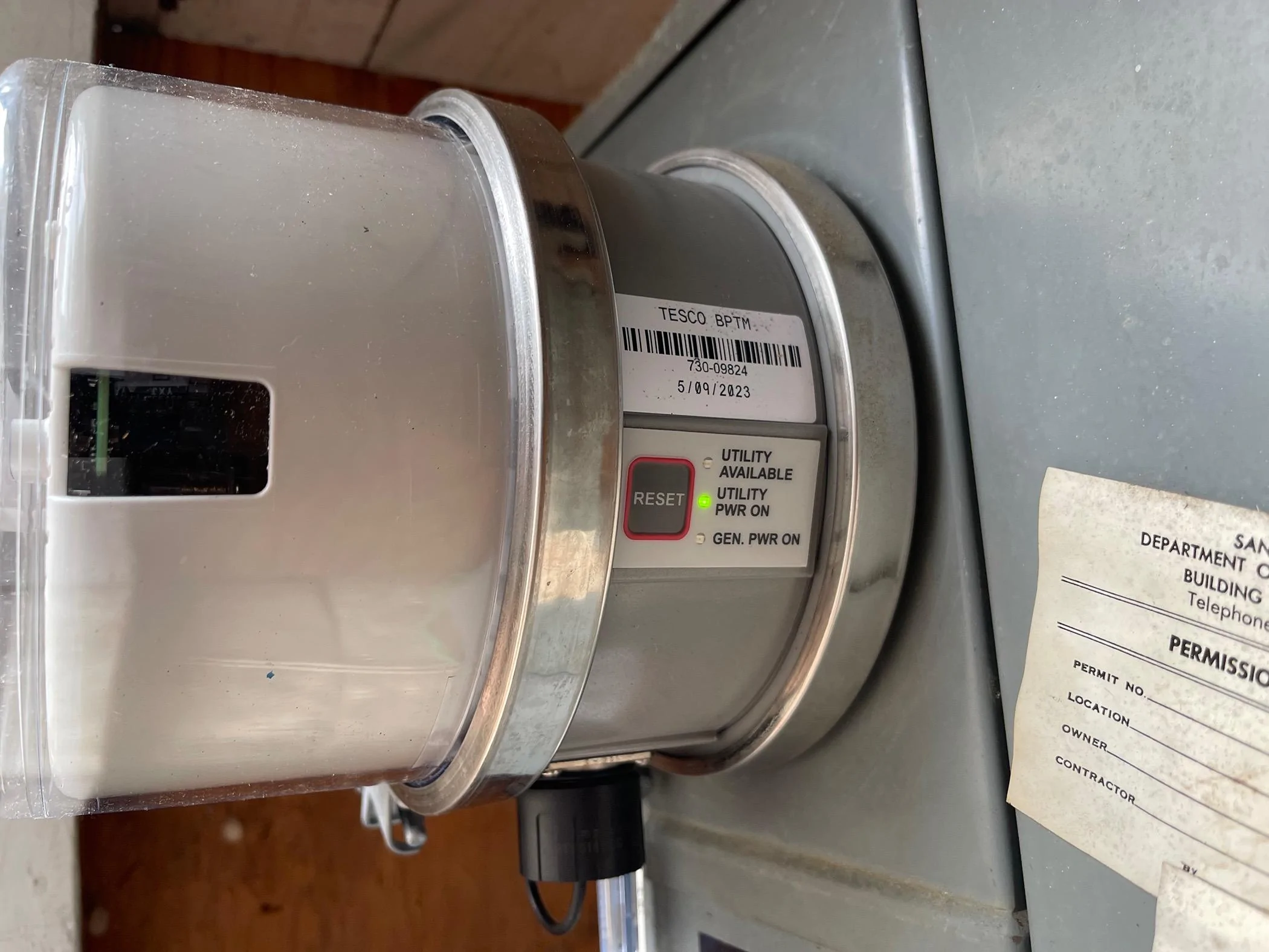

While everyone who has posted is trying to provide good & safe info, please understand this is now obsolete information.
the new meter collars with generator input provide the functionality you want.

Originally I found this company:
https://www.generlink.com/
When I inquired with them, they told me they could not ship one to me as my utility would not allow them. Fast forward a couple of months and PG&E is offering them directly at no cost.
I should have bought a lottery ticket that day!

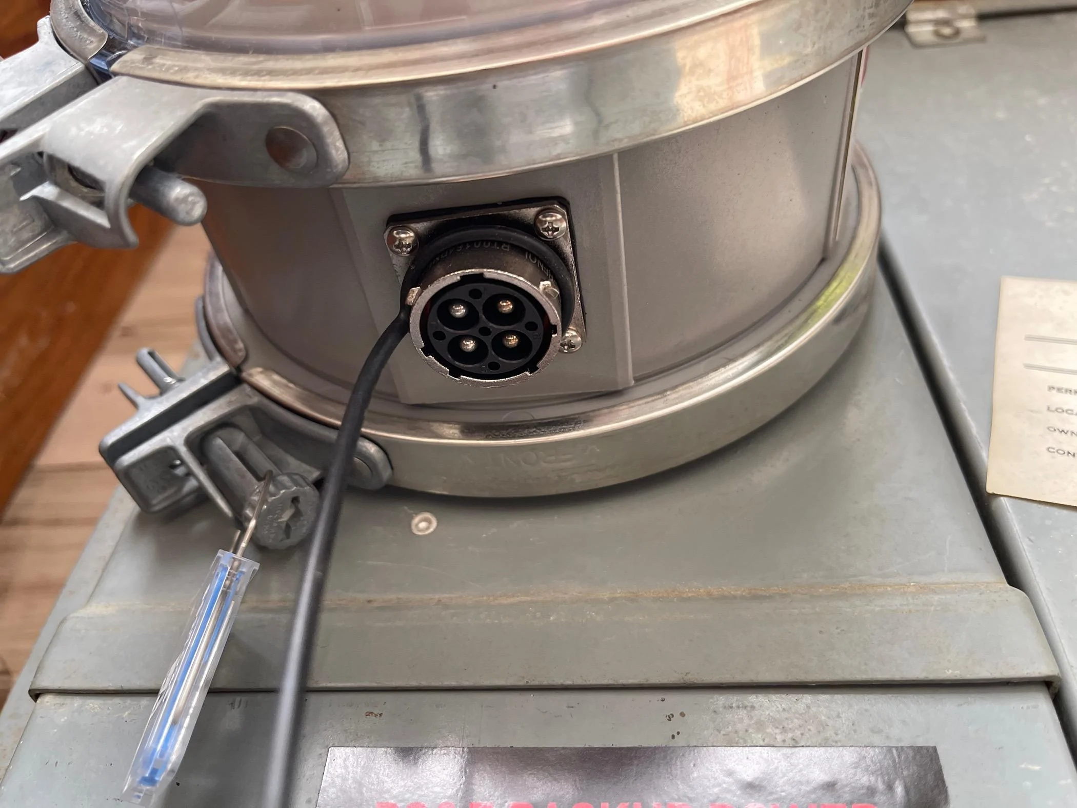

Does PGE provide you insurance coverage if the meter base somehow fries the inverters in the Truck?
As the collar provides no power, there is not a mechanism for the meter collar itself to do any damage. When utility power returns, the collar switches back to utility mode. The generator is disconnected automatically.
In the event of a Lightning strike (no pun intended) on the house that jumps to the house wiring, the ground connection in the meter panel is still in place to provide protection. If you live in an area where lightning strikes are common, you can add multiple grounding rods and interconnect them to create a ground field. Of course increase the size of your grounding wires to accommodate the largest wire your meter panel lugs and the grounding rod interconnect will allow.

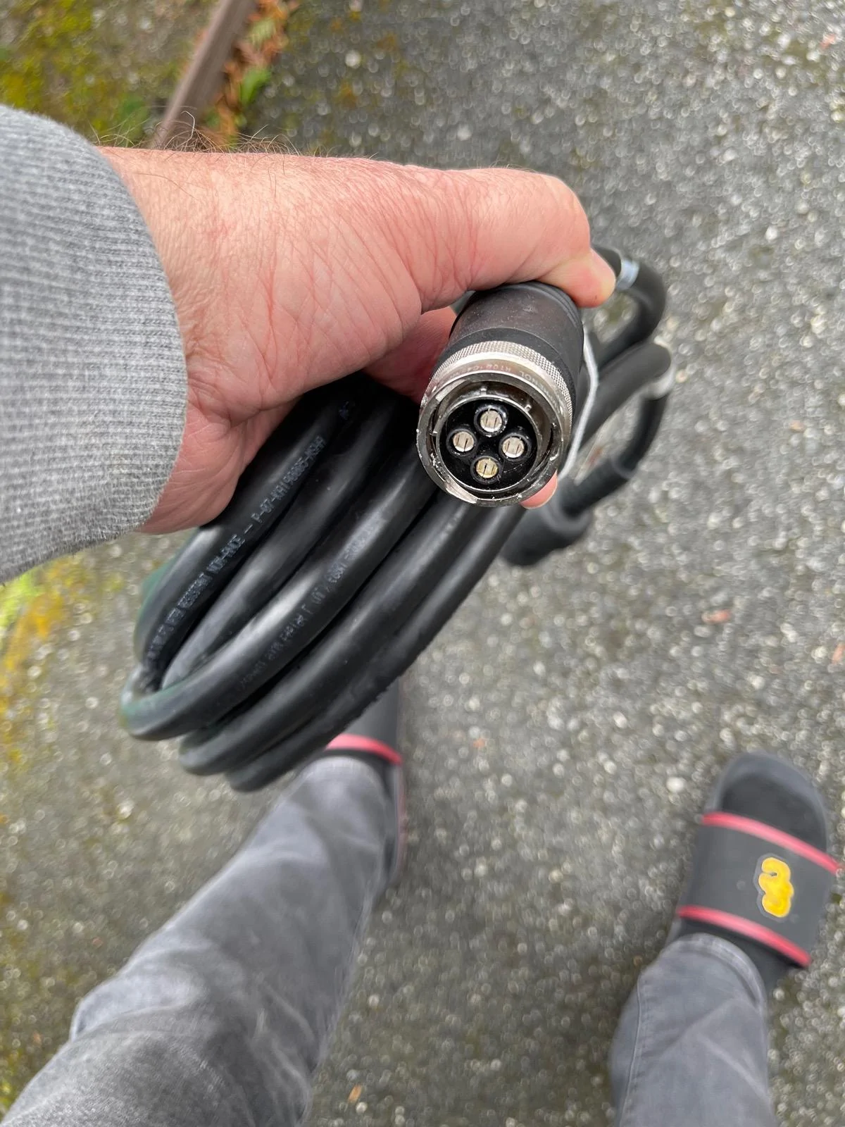

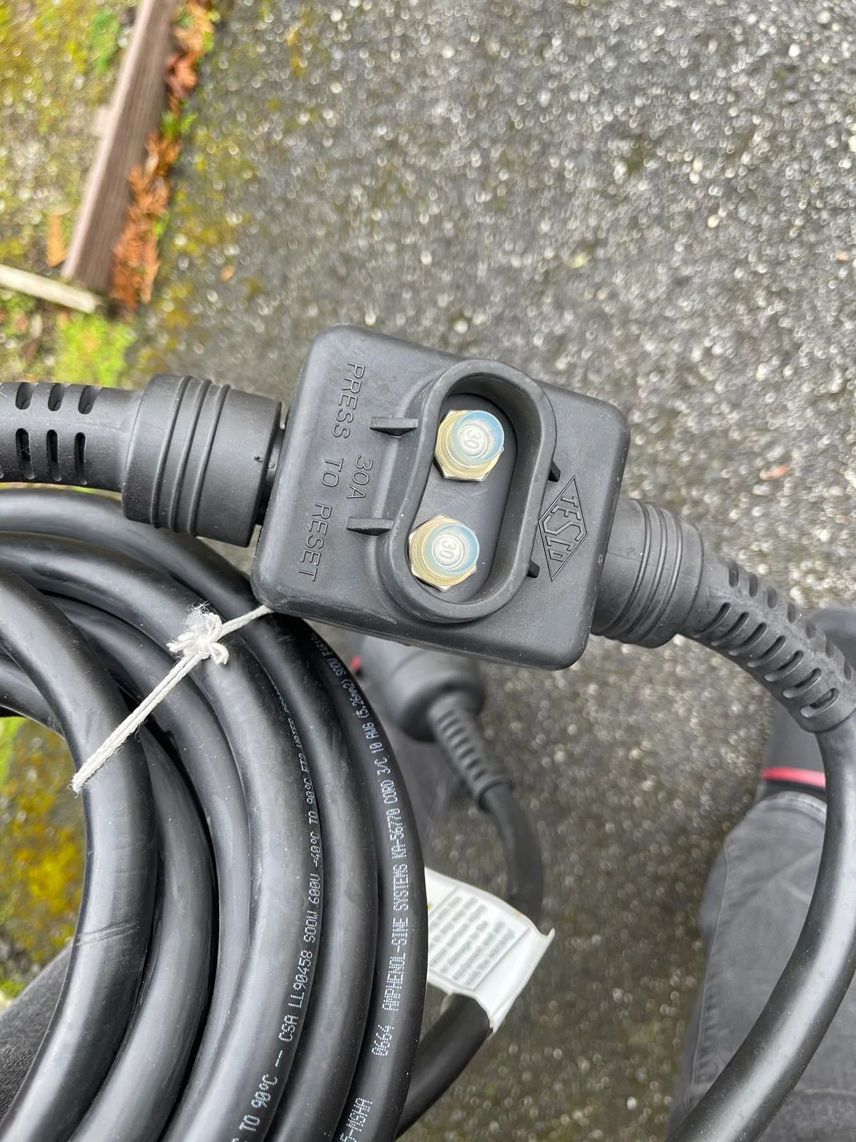

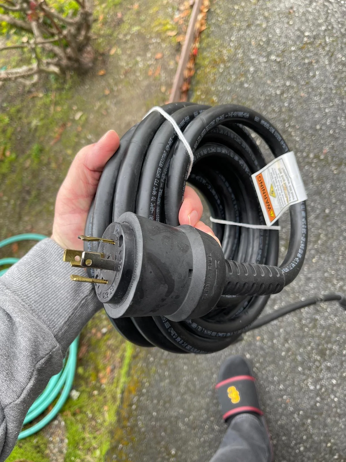

A 50A (30A) suicide cord? What could go wrong? /s
The other end of that cord could have a female fitting that plugs into a generator input
Ford F-150 Lightning Request: A concise answer to how to connect Pro Power to a generator inlet 1711381635475-0i

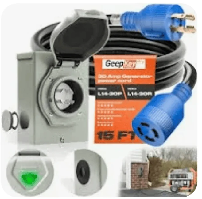

As others have stated.... explain the issue with the truck GFCI and conventional transfer switch / interlock to your electrician and get their recommendation.
Whatever they do decide, I highly recommend doing a 50a generator inlet (similar to link below) instead of a 30a. You can use your Pro Power onboard (via appropriate 50a to 30a cord or dongle) or a larger rated portable generator if you want more power than pro power onboard can supply or if down the road you have a different EV that can supply that much power.
https://www.amazon.com/Reliance-Con...DmOxBHZ_gIuzljh0_s9eOV4pNfwaAlRaEALw_wcB&th=1
