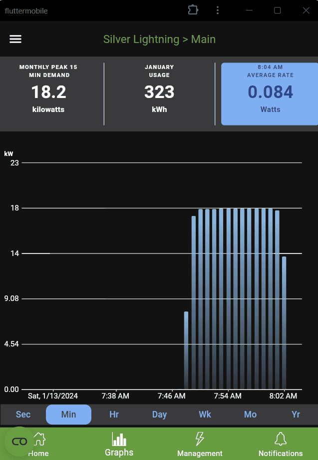

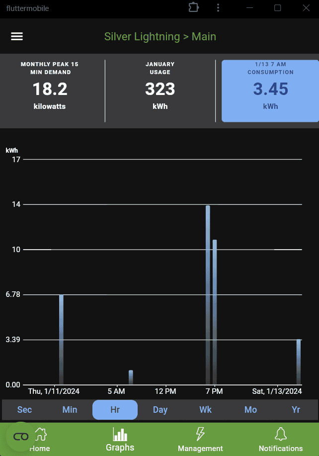

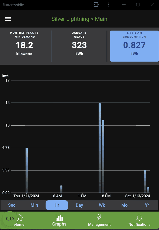

I observed something odd this morning, we had a mild raining night Friday into Saturday, wake up temps in the low 50's, I used the remote starter for a 15 minute cabin warming session, using 4.2 KWH, this was a bit more than I've used in the past typically 2-3 KWH.
