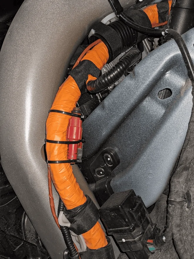

I don't mean to knock Megaohm's product, but I learned this weekend while installing ACC wiring that instead of a resistor you can use an old Ford Injector to replace the reverse/PAWS speaker and maintain the IP rating of the connector. I took the speaker apart and found that it is indeed just a 4Ohm speaker, so the injector actually matches the load very nicely. If you don't have a shop with old injectors lying around or a mechanic friend who can give you one just pick one up next time you're at a salvage. Or you can get them new for about $25 bucks or just buy https://www.megaohmmotorsports.com/product/ford-psbk-ece
