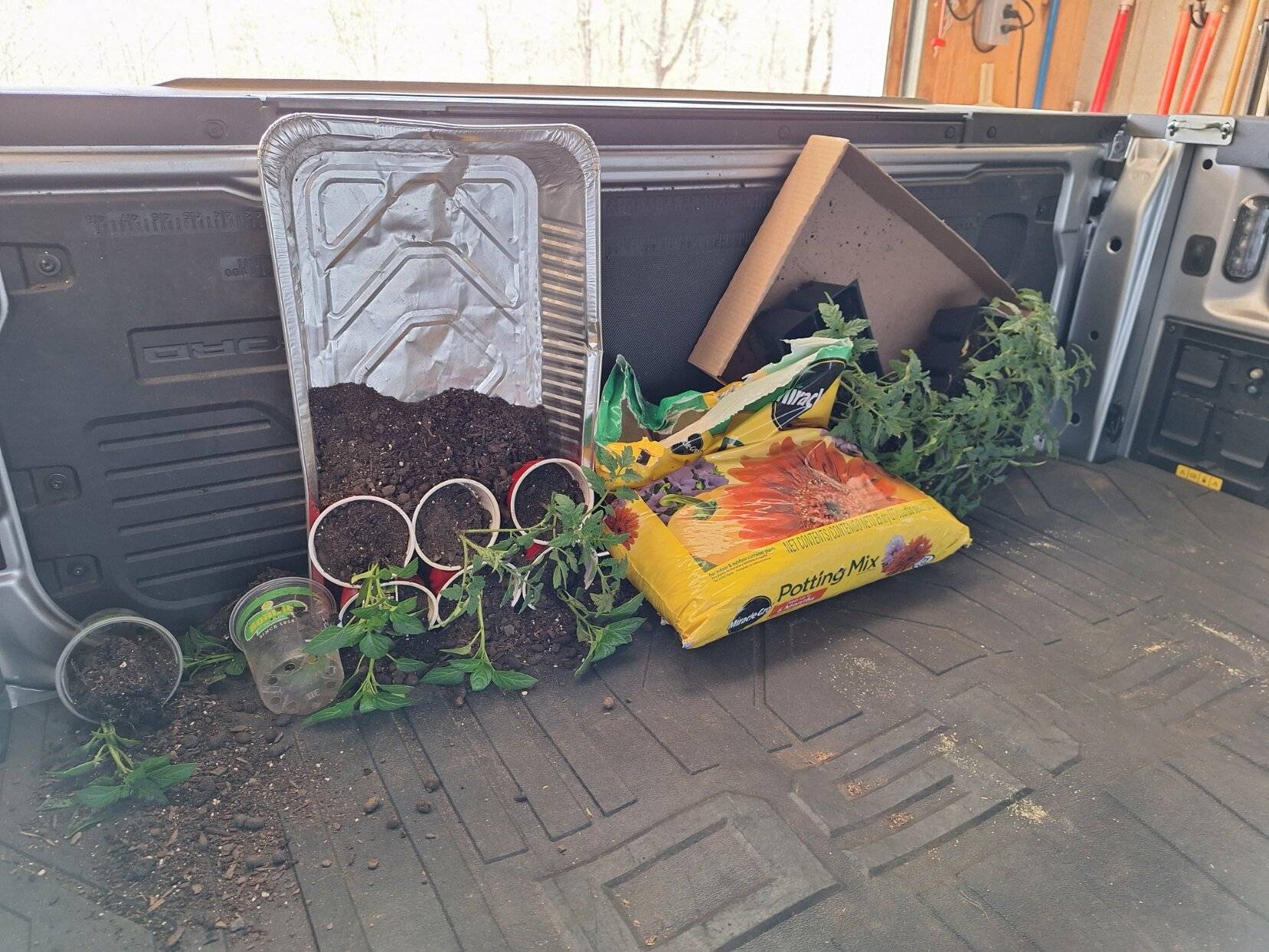

I was using my tail gate as a work bench and while I had walked away I think I heard a beep or something and it automatically closed.
Any one from Ford or tech insight have an answer? How to keep it open when being used.
It’s happened several times with my ā€˜23 Lariat 73k miles. But, I admit I’ll have to see it again - with no possibility of fob activation.
I’ve had this happen several times. My biggest loss was a tumbler of whiskey. I have a 23 lariat and it’s very glitchy, especially tailgate operations!
