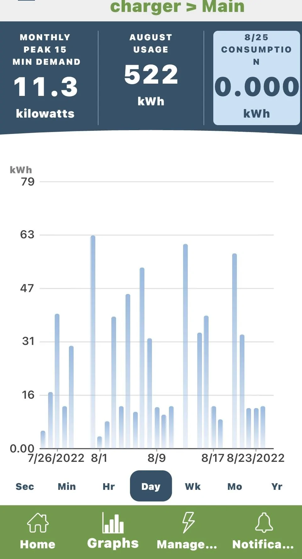

You do know you don't have to purchase another charger.
You can always derate your FCSP to lower current by the switches inside.
My 48A Emporia (UL Listed) has been great over the hot summer months - never stopped or down rated current flow even in 110+ degree temps in the garage.
Can't say that with the Ford chargers working in the heat.
My Emporia has been doing double duty ( 2 EV sharing) and it has not failed yet.
I love the wattage use graphs showing by the month, week, daily...

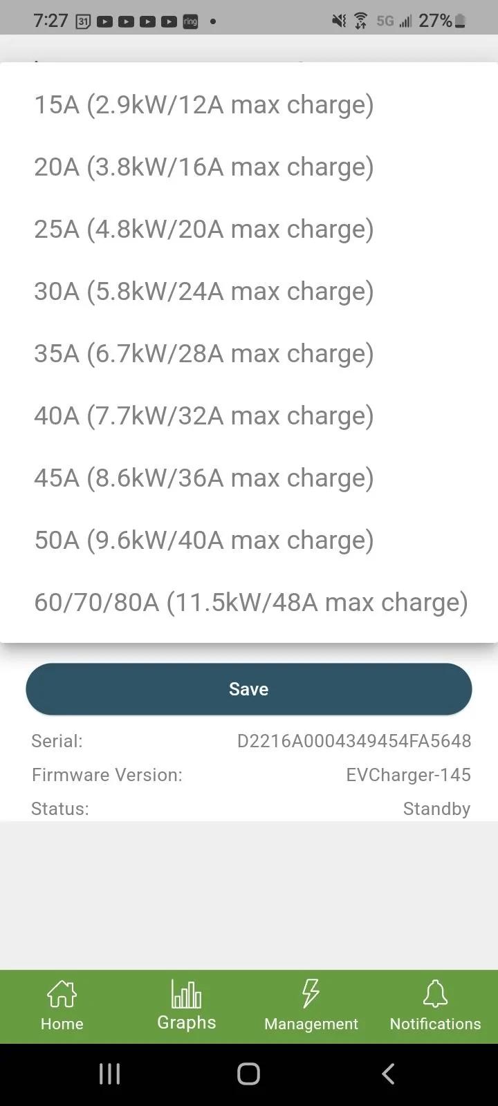

I picked Emporia because I have a Emporia energy monitor that uses the same app and you can derate the amps from 12A up to 48A. I wanted the 14-50 so I can use the charger that comes with the lighting or any other charger if needed.

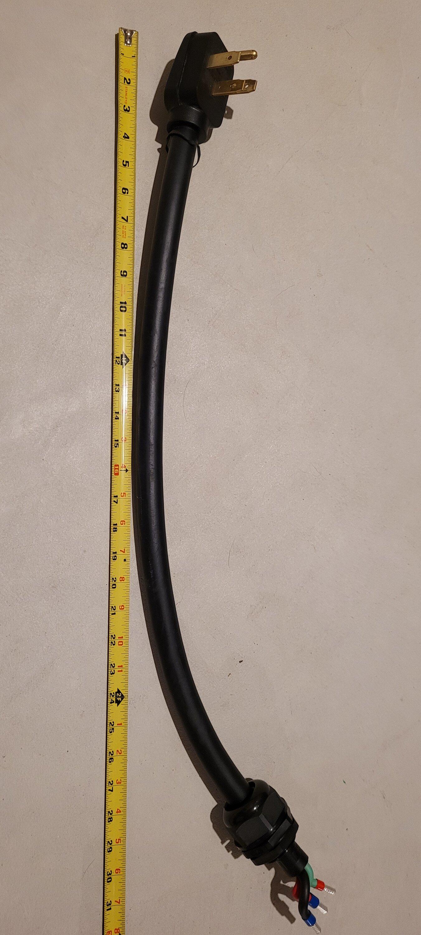

How long is the power cable with the 14-50 end on it? I couldn't find that on their website.
Ford F-150 Lightning Just INSTALLED: L2 48A EVSE from Amazon - getting prepped for incoming Lightning 20221010_204656
EDIT: Apparently, the UL listed length is different than the non-UL. Mine is not listed. The length of the listed length, according to the website, is 22 inches.
3,759
6,827

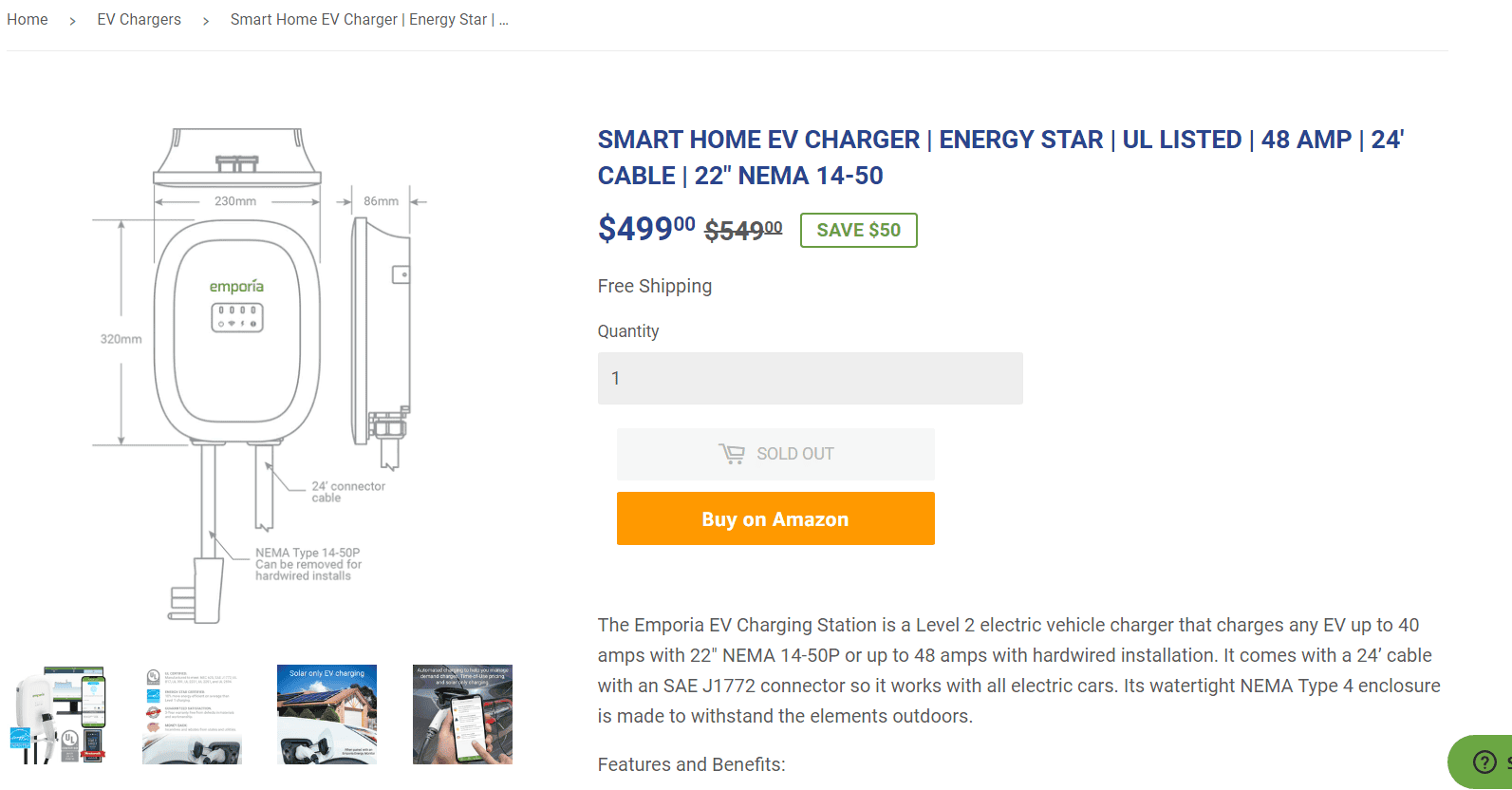

That’s one of the reasons it’s not UL listed. Power cables longer than 12” must have a GFCI built into the plug.
The UL listed charger on the website has a 22" cable with no GFCI built into the cable.

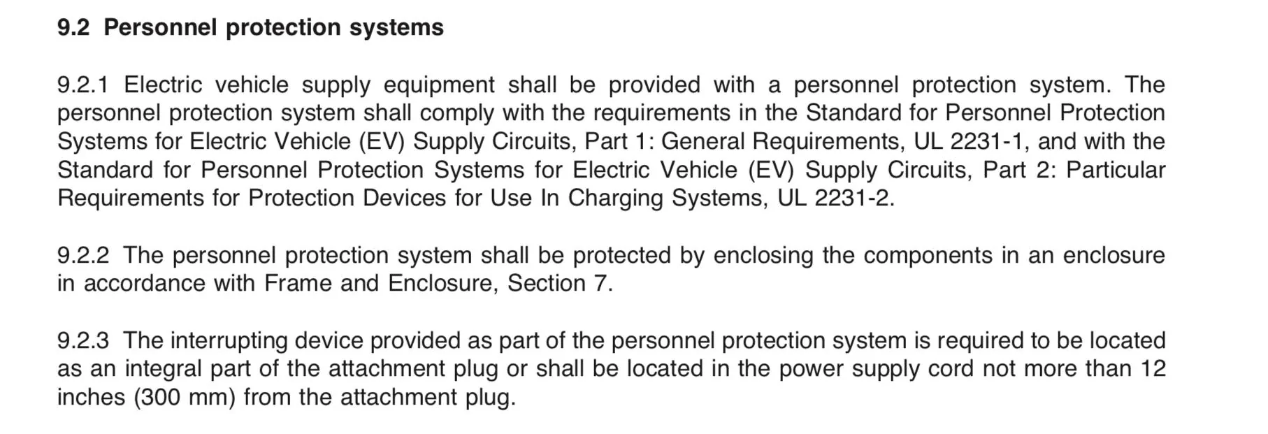

This is the standard UL2594:
Ford F-150 Lightning Just INSTALLED: L2 48A EVSE from Amazon - getting prepped for incoming Lightning 56D7CB00-F7D0-404F-9EFD-70B9ADA9A174
I don’t see how they’re meeting that. 🤷🏼‍♂️

My very wild guess is that they had the unit UL certified in its "hard wired" configuration then added the cord later. I am also concerned that the max amps setting seems to be software controlled only; I would expect a physical setting of some sort to prevent a software (or user) error from overloading the circuit.

Yes, the current setting is controlled by the app.
If it does not connect to your Wifi & app, it defaults to 40A / 11kW (assumes plug use).
3,802
4,900
When the amperage is software controlled by the user, the supplying circuit must be sized to the maximum ampacity per the NEC.
Isn't the GFCI built into the circuit board where 240V enters ?
Likely so.
In order to meet UL 2495, the GFCI must be not more than 12” from the plug. Hence the reason most EVSEs have 12” cords.
