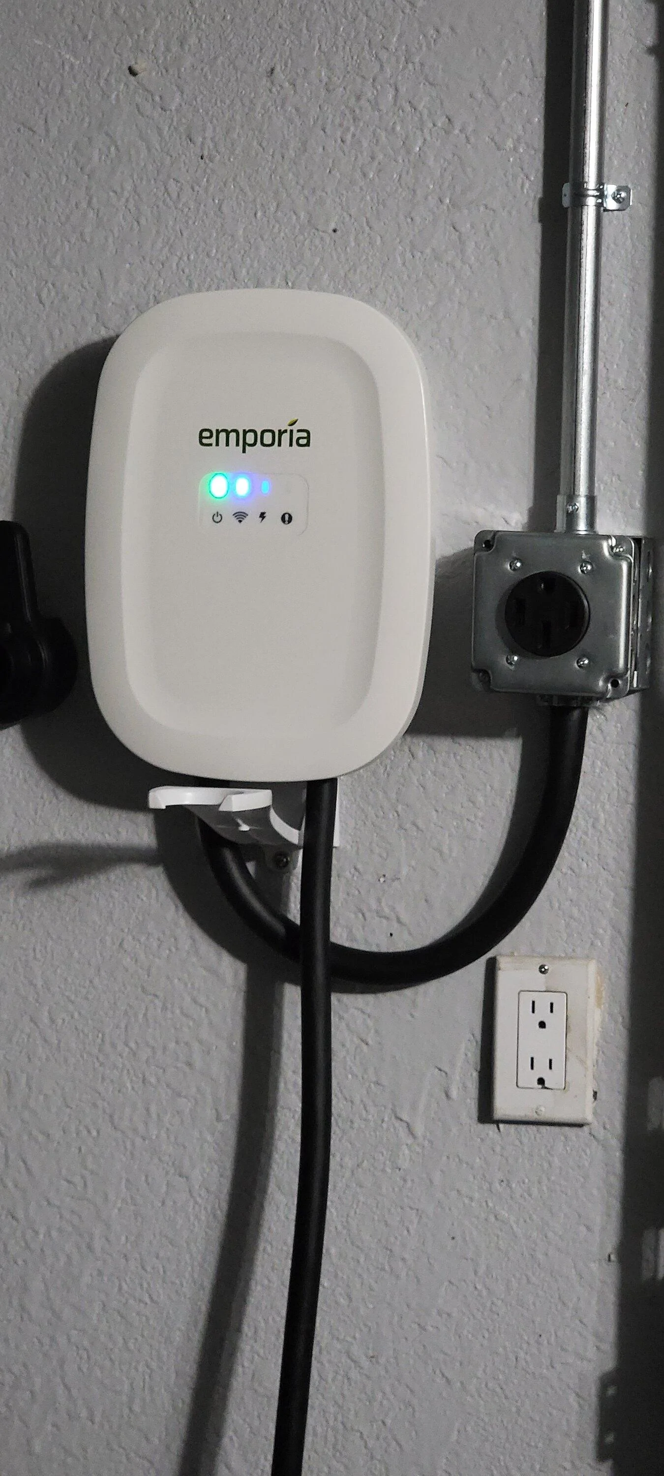

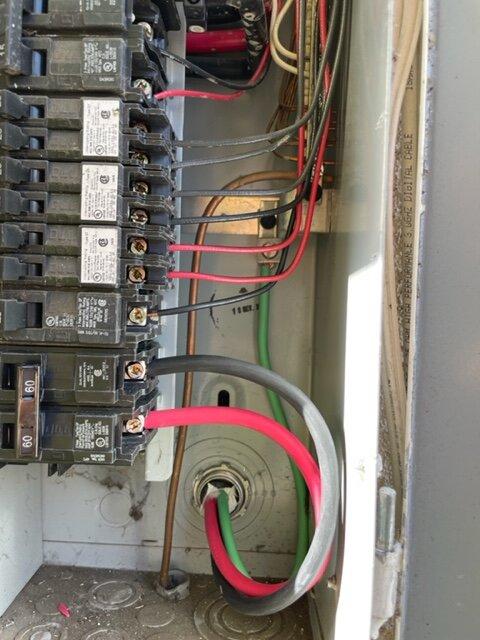

My installer is a licensed and self employed that was recommended from my neighbor who had a Tesla charger installed. I had him run a 60amp breaker direct to the Emporia charger and a nema 14-50 so I can plug in the Ford charger if needed.
Great minds think alike.

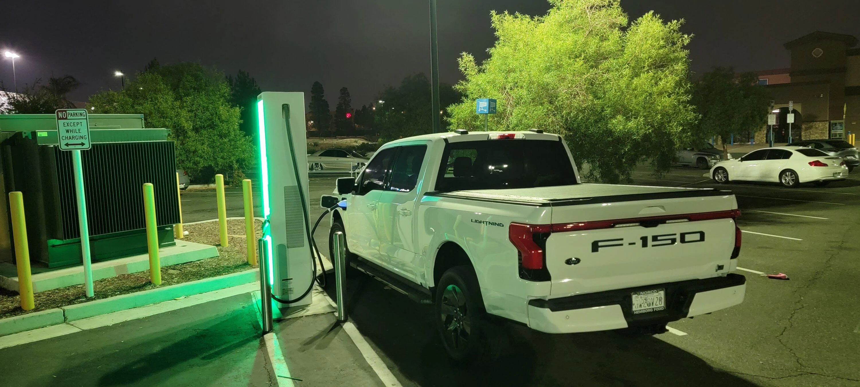

I like this charger better its faster and free.. 😊
