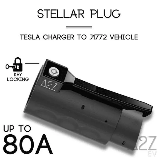

You will need the DC Level 3 NACS to CCS1 A2Z Typhoon Pro adapter to charge your Ford Lightning at eligible Tesla Superchargers.
The AC level 2 A2Z Stellar adapter for Tesla to J-1772 is used at hotels, parking lots, shopping centers and Airbnb with Tesla Destination chargers.
You can bundle the Level 2 adapter - A2Z Stellar AC Tesla to J-1772 with the Typhoon Pro Level 3 adapter for $75 additional after discount by using the drop down on the Typhoon Pro page to get both adapters.
Current estimate for A2Z is shipping will take 1-2 weeks for the new Typhoon Pro adapter bundle.
Discount promo code “FORD” is still working and free shipping is also available.
A2Z EV Tesla Supercharger Adapter for Ford - Save 10% / Free Shipping + bundle the A2Z Stellar AC Tesla to J-1772 adapter for $75 additional after discount code "FORD".
