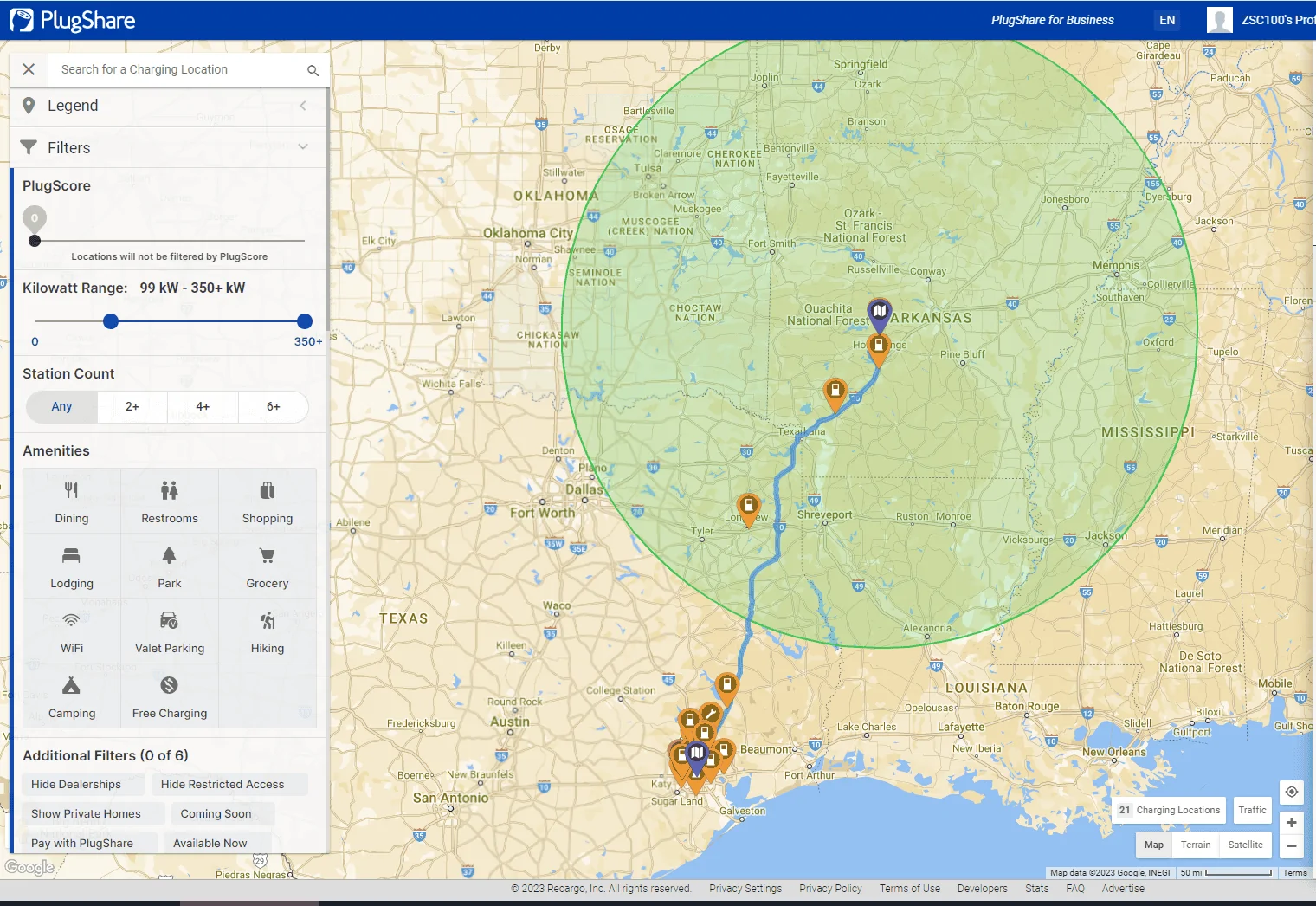

This isn't going to change anything for you, there are chargers already on the route for you that will charge your truck at the maximum rate. This is only going to be clutch for a few people who want to road trip a lot and improvise. I've driven my truck all over the midwest and had zero problems, other than the occasional slow (50kW) rate of charge, but I have a friend with a Tesla in Tulsa and he gets under 50kW at both of our superchargers routinely. He has grandfathered free supercharging so I suspect that has something to do with it. That would be just like Tesla to reduce his speed b/c he is charging for free. I can't wait to see all the lightning owners who think this is going to make such a huge difference nationwide when they experience 50kW charge rates.
I beg to differ. there is one EA DCFC for our trip to Dallas. and ZERO if we're going to Houston (US 59). access to Teslas changes the Houston route from 0 to 4 and to Dallas from 1 to 4. Can't wait! Until then my wifes car will carry the load. Oh, and the Tesla chargers can be counted on to work. what a concept.

There is a Shell in Longview right in the middle of your trip. Be prepared to pay 55c/kWhr, but it will be faster than any Tesla charger that will ever open up for you. So if you have a place to charge L2 in Houston you'll want to plan your trip carefully. This is one thing that will never change with EV's that is so different to ICE vehicles. If you want to charge at a fast rate you'll pay over 5 times as much; Tesla isn't going to change this, nothing is going to change this. It would be no different for ICE if we had gas spigots at every house. GAS pumps, brick and mortar stores, big holding tanks, etc cost a lot of money,, as do DCFCs. L2 charging is like buying fuel straight from the refinery at 1/4 the cost and no road tax. EV's are turning so many systems upside down, this is why it's so controversial, political, and disruptive. It's a wild time we're in, and nobody can predict the future.
