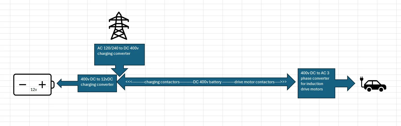

Pardon the sketchy flow chart and high level assumption of how energy flows on EV's, in particular the Lightning, I'd love to see real flow charts and schematics of the Lightning's energy management system, I'm an electronics tech at heart, not just a "Taxman".
Ford F-150 Lightning Top battery off to 90% every day? 1703688498960
When the truck is plugged into the grid, the trucks user defined settings in the controller determines the HVB charging requirements, when the 240ac to 400dc converter is actively charging the HVB., the HVB motor contactors are locked out to prevent accidental driving while charging.
When the HVB reaches desired SOC, the charging stops and the truck goes to sleep.
If the truck is in a RUN/IDLE state, but plugged in to AC or DCFC, the HVB charging contactors close to energize all HVAC devices, AC Compressor, PTC heater, HVB to LVB charger, in this mode of operation the the AC to DC converter only supplies enough current to operate those devices, little if any energy is added to the HVB, but on occasion I've seen the HVB SOC creep above my set point very slowly, maybe 1-2% over an hour or so.
While this is active the LVB monitor determines when it will send a charging current from the HVB (that's being monitored by the HVB charge controller), fractionally the HVB charger and LVB charger are working in tandem net draw is from the grid.
