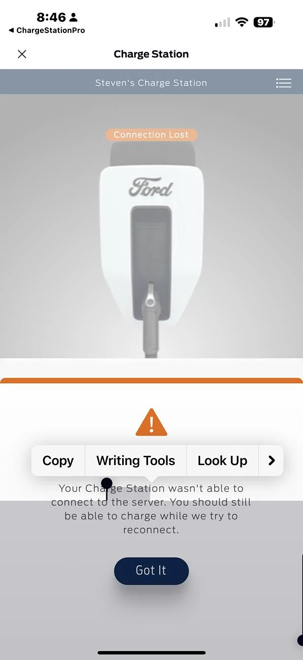

My truck had a 12V battery issue and it was replaced. During the problem but now after replacement the truck and charger aren't communicating properly. Oh yeah, and at the same time I changed my wifi from an Orbi Wifi 6 mesh setup to a Deco Wifi 7 mesh system. During this time, the home location doesn't show up in the Ford app, the truck doesn't automatically heat up before leaving for work and when I plug it in it charges to 100%. I've looked at the setup and changed the wireless, but still the same thing. Should I just reset the charger - an option in the charger app and then reconnect it? Or is there another simpler solution.

The charge station issues are related to your home network, I'd do a master reset of the FCSP from within the cabinet.

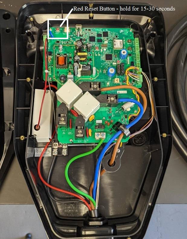

FCSP (Ford Charge Station Pro)
Master reset button is on the circuit board:
Ford F-150 Lightning Truck and Ford Charger not communicating properly reset button Ford CSP insides 1
BTW, when setting up the FCSP wifi with your home network, the 2.4GHz signal from your home wifi is preferred - travels farther and through more things like walls. So have your smart device connected to the home 2.4GHz wifi through settings on your device, then start FordPass then start the FCSP setup app. The setup app will search for the FCSP - it can sometimes take a while and a few tries. When found you enter the login and password that came with the FCSP (a sticker on the manual has the info).
The FCSP is sometimes finicky - I had to hard rest with the red button mine a few times before I could get it set up - although I never actually completed the setup - it would not add the FCSP to FordPass - but the FCSP charges my truck fine anyway - I do all my charge time and settings with the truck.
PS: that image is from an install video ( I think ) and you'll note the AC power lines are not installed. They would be attached to the terminals on the circuit board near the bottom left - and coming in contact with the AC power could be a deadly mistake. USE CAUTION when the case is open and the power is on!
