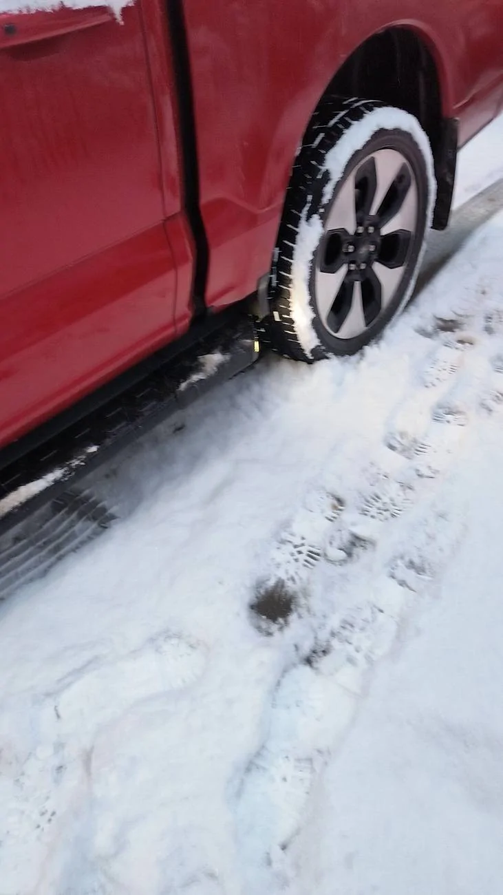

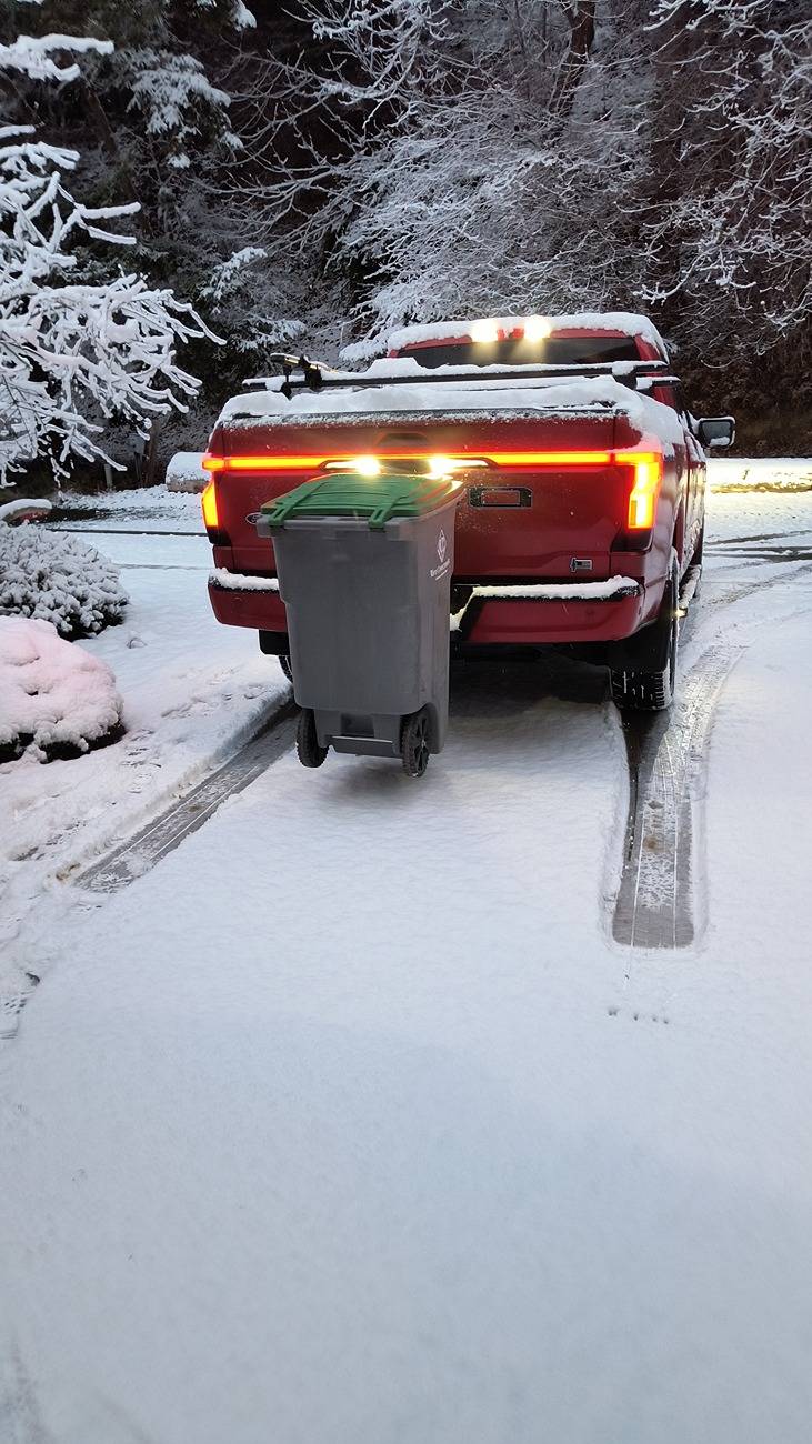

We had snow in the Northwest just last week. I parked the truck on a incline with snow. The truck slid down the driveway, about 4 feet until the snow formed a wheel chock. I attached a couple of pictures that I took. I was doing a trash run for the inlaws. Would not have believed it if i didn't see it.
