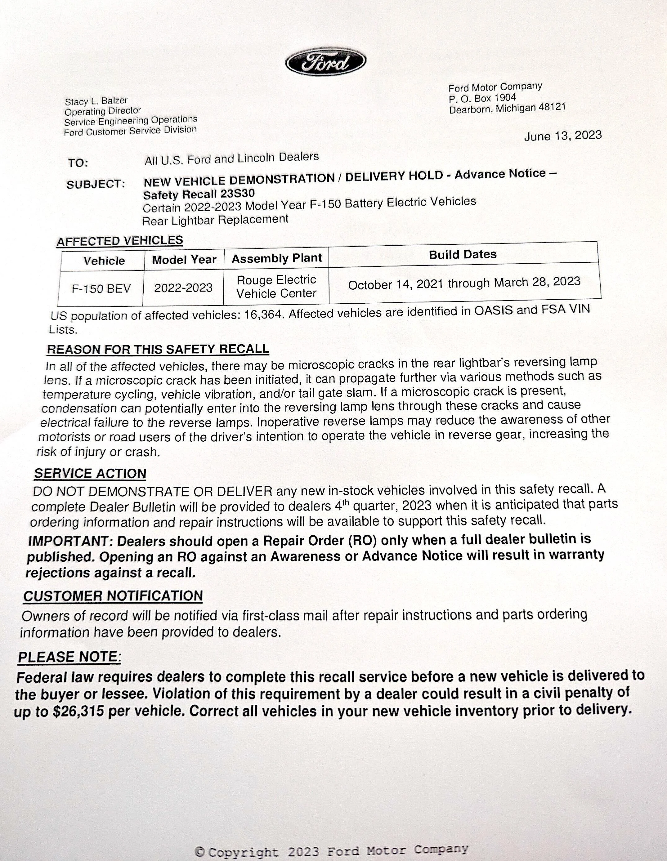

Looks like recall is for build dates ending March 28th. My build was completed in April and does not show the recall. They may not have any delays for new trucks if they started using the new part in April. I'll be watching to see if the recall expands to my truck.
I put in my Vin and it shows a recall notice. I was on the 2/6 build that got delayed until March and I actually didn't get the truck till May :( I am wondering if I can contact Turo and tell them that it is not a recall that will affect the vehicle safety since the brake lights are not impacted, just the light bar

Dayammn... Maybe this restriction largely involves unsold mannequins among the first 16,364 trucks.
I hope there aren't too many of those around in the first batch. Would suck to be a dealer with one of those sitting on the lot for another 5-6 months.
Unfortunately, according to the recall, the moisture in the light bar can cause the reverse lights to fail.

My Lariat was built on March 16th and is in transit to my dealership. It is expected to arrive sometime next week (June 21st or so). My ford pass app shows that my vehicle is included in the recall, but i live in Canada so i checked for this recall on the Transport Canada website. They don't show this recall yet.
I'm hoping that my dealer will be allowed to deliver my truck when it arrives as the recall notice posted in this thread indicates that the no Demonstration / Deliver clause is based on federal law in the US, which may not apply in Canada. Im keeping my fingers crossed but will know more when my truck arrives.

Yesterday I dropped off my Lariat Lightning to replace the rear light bar due to the infamous moisture condensation on the inside. They had the new part ready to put on, but called me this morning saying that within the last couple of days Ford issued a recall on the lights due to micro cracks in the plastic.
They've been informed that they are not to replace the light bar as that replacement has the same issue.
Ford will be replacing the light bars with updated parts that do not contain those cracks at a later date and the dealer will call me once Ford has the part available. This has now been confirmed.
