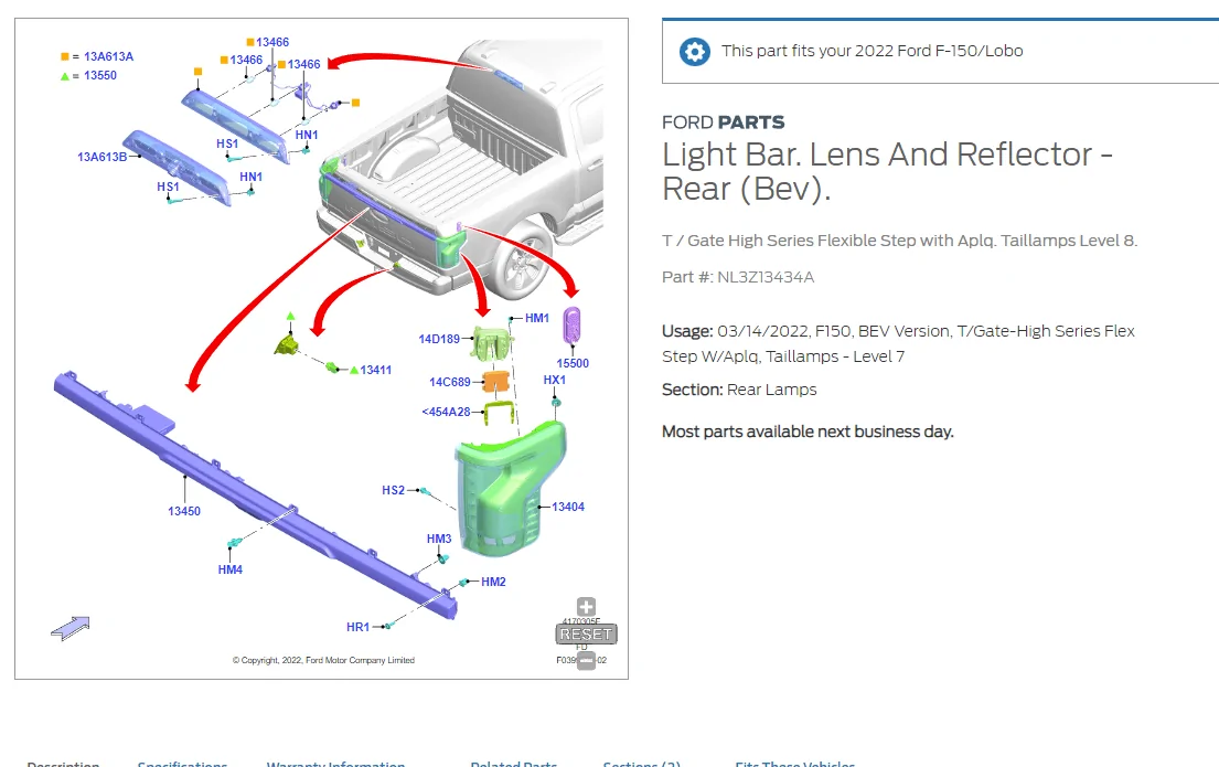

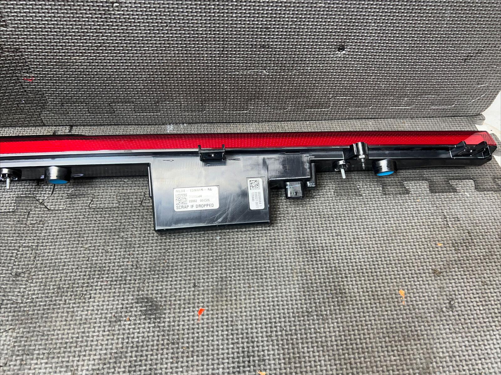

You are not wrong, nor are they. I am still trying to figure out the differences, if any. I came across a ebay listing, which had that number on it. When look at FMP website, I see the one listed in your post. They could be the same, and just renamed or just pointer to another part.
You may not be able to tell the difference, but something changed. Ford doesn't change the engineering part number just for the heck of it. It could be a different grade of plastic or something with the assembly process.
I get that and I totally agree, however when looking at NL34-13N466-AC, it points to NL3Z 13434A and when looking for NL34-3N466-AE... nothing shows up (which is expected since they didn't produce it yet). This is why I found the ebay listing, and it showed NL34-13N466-AC right on the sticker.

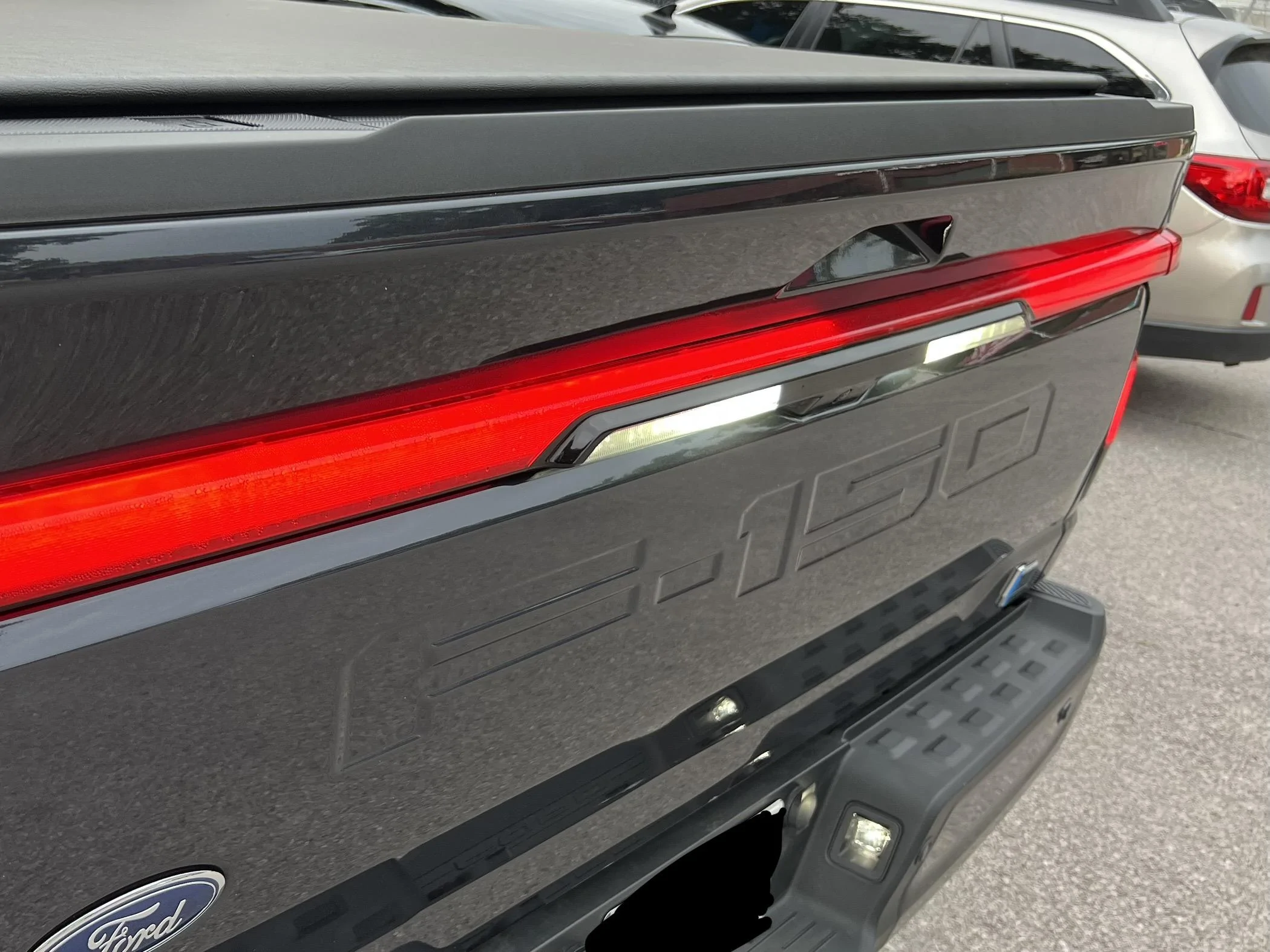

Well it got me - 1/4 of the bar isn’t lighting up. Guess I have to wait for parts before scheduling anything - and I'm not sure how my local dealership will handle it. A few months ago they were telling me I'd have to leave the truck with them to even get on a list...

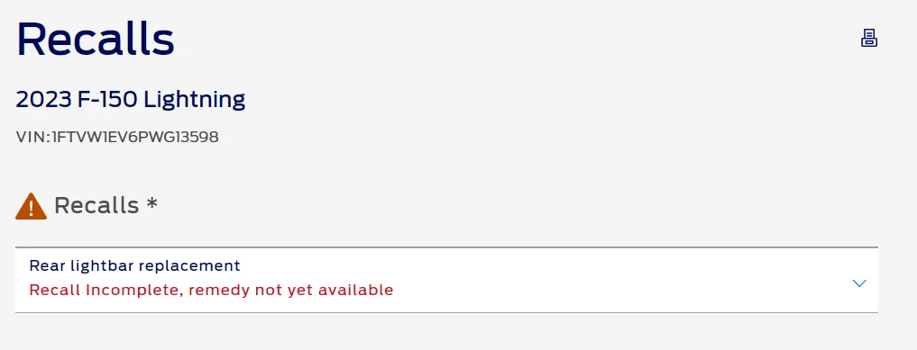

Yesterday I dropped off my Lariat Lightning to replace the rear light bar due to the infamous moisture condensation on the inside. They had the new part ready to put on, but called me this morning saying that within the last couple of days Ford issued a recall on the lights due to micro cracks in the plastic.
They've been informed that they are not to replace the light bar as that replacement has the same issue.
Ford will be replacing the light bars with updated parts that do not contain those cracks at a later date and the dealer will call me once Ford has the part available. This has now been confirmed.
Has another found out how long it will be before the replacement parts will be available?
