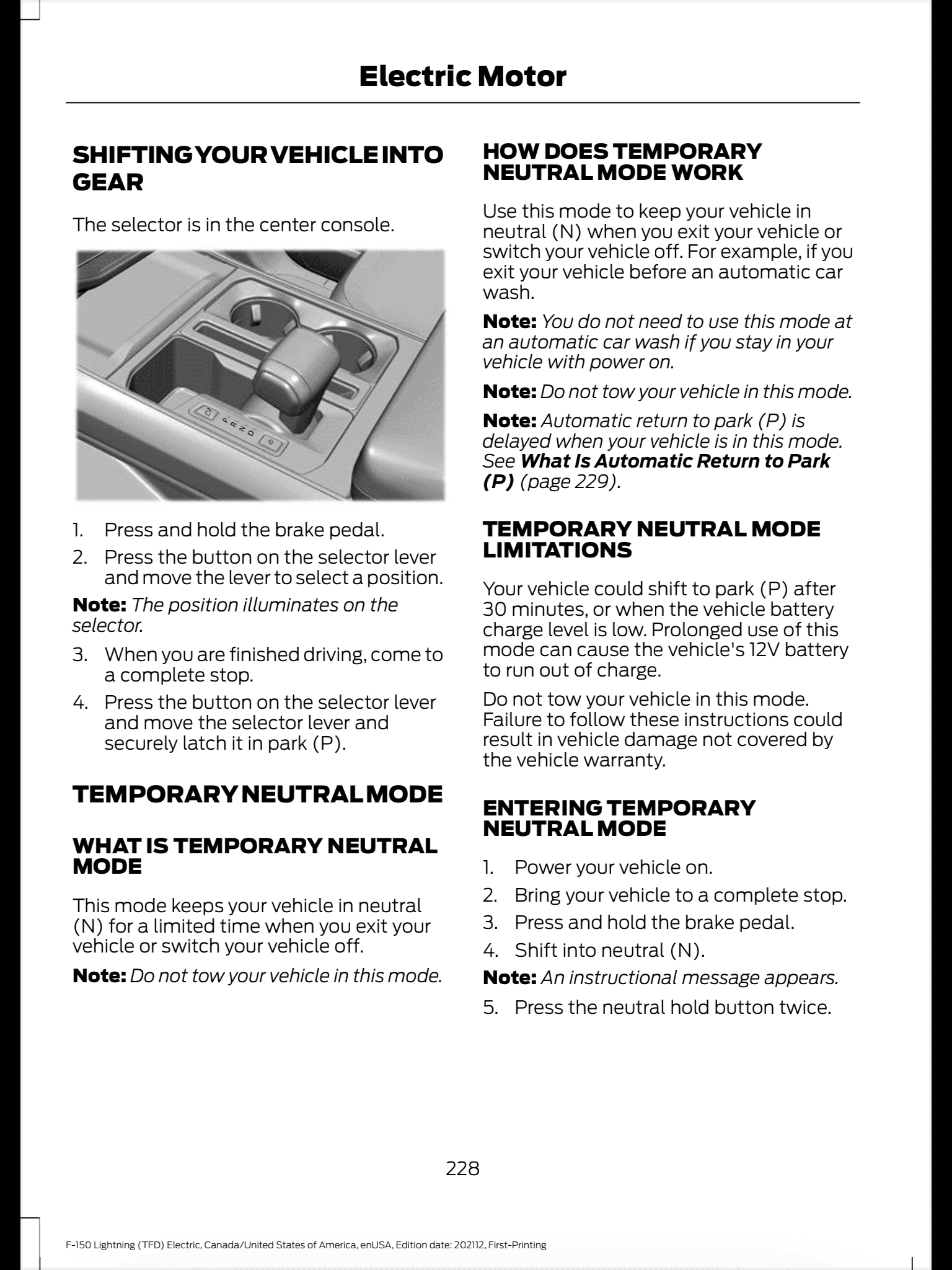

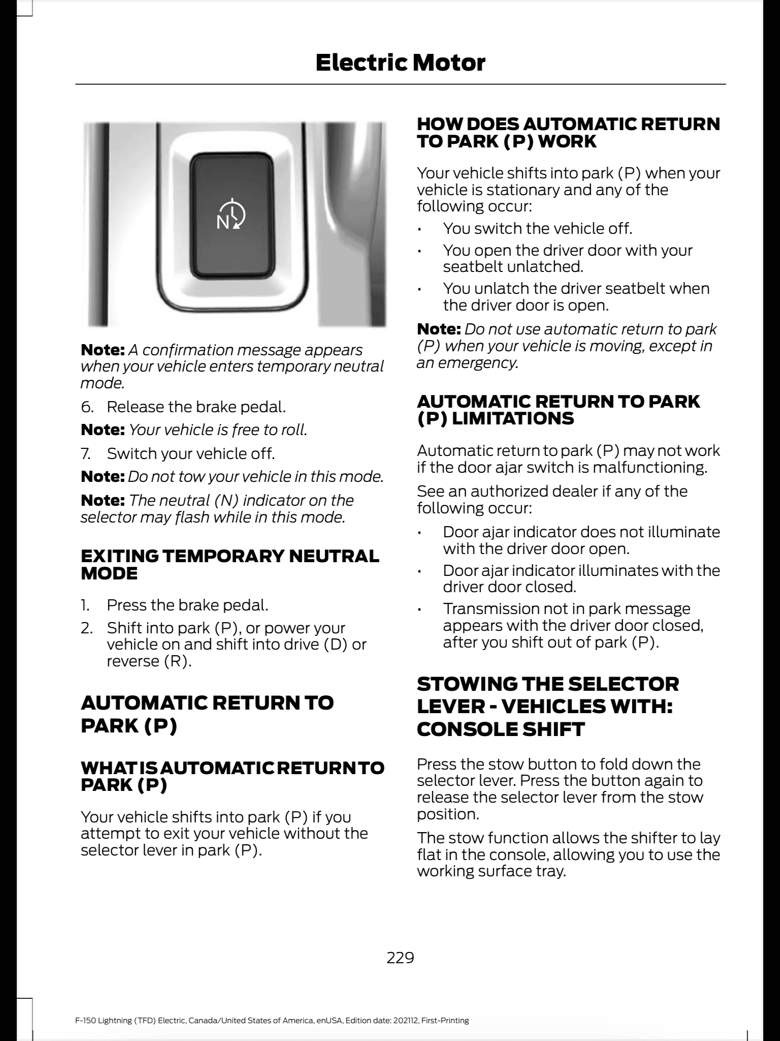

What is the N Clock button for?? I don't see anything changes on the dash when i press it.

Think that is the car wash neutral button. permanent magnet motors are not intended to freewheel unless the car deactivates stuff. esp. if no driver and vehicle is not on.

Temporary Neutral activation
From the Owners Manual……..

Put it in Neutral, then press the button.

The manual does a good job of explaining its use. But to further explain: your car will go back into park when the door is opened, even if you have the shifter in N. The button allows you to put the car in N and exit the vehicle.
I believe this function exists in all EV cars. In my Tesla it is called car wash mode.
Also, I really recommend you read the manual. There are lots of features that have received little attention on this forum or other videos.
I have had my Tesla for three years and I still refer to the manual for features I seldom use.

If you break down and need to get pulled on to a flat bed, you will need this.

At a car wash is when you will use it, unless you go to one of those touchless washes that moves around your vehicle.
