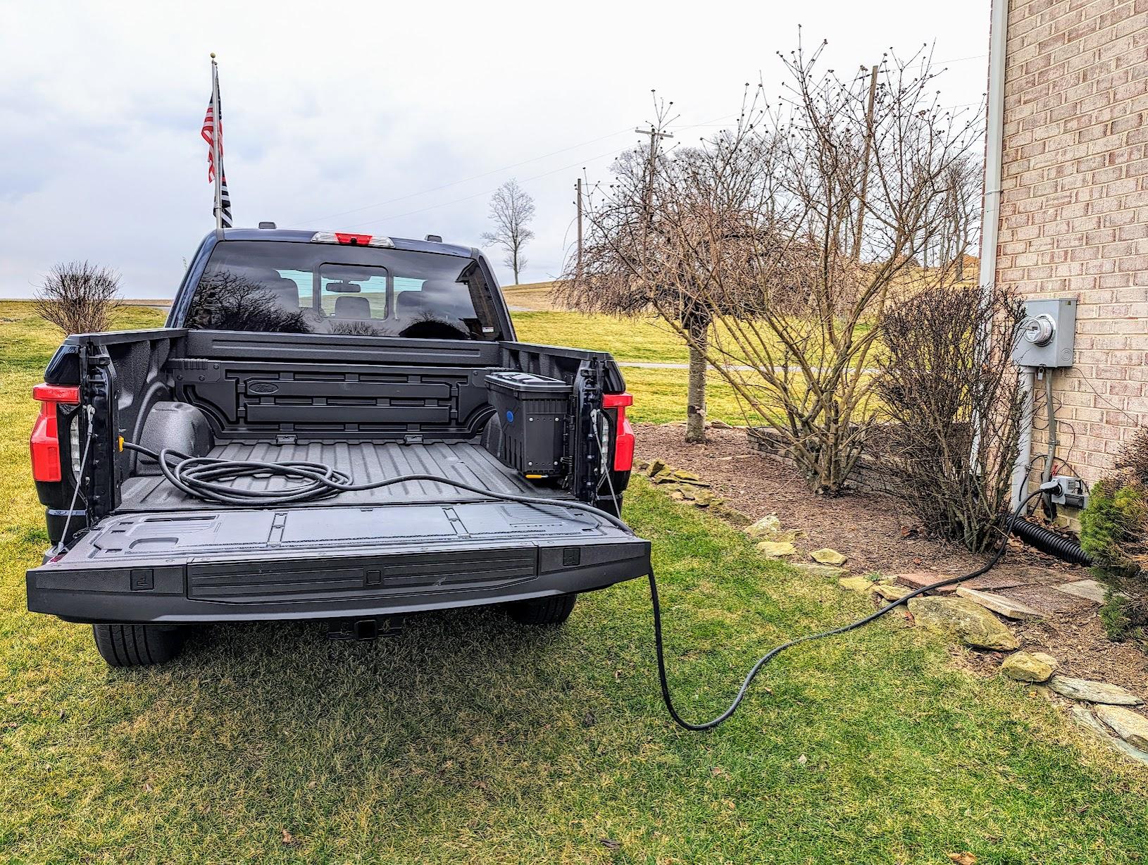

Tested using the truck to power up the house through my generator inlet. Success mostly. Unable to handle the startup surge of the heat pump compressor and the Pro Power trips off on overload protection. In order to use the heat pump (normal central heating and cooling), I'll need to put a soft-start unit on the compressor ($379).
This becomes even easier if I run some 8-8-8-4 aluminum SER around to the garage to put the generator inlet box in the garage. Warm, dry, and plug it right in.
