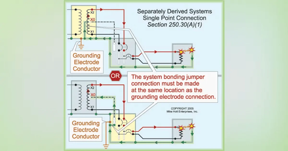

Not sure why the Whole home back up - a simple approach thread is not open to reply anymore. I would like to share some additional info in response post https://www.f150lightningforum.com/...e-back-up-a-simple-approach.18301/post-367782.
Per the post, Mike Holt certainly a trustworthy source. His advice is certainly good but I like his concise interpretation of the code even better. Here is what has said about grounding (connection to earth) and bonding (neutral-ground bond) for separately derived systems (SDS).
Ford F-150 Lightning Whole home back up - a simple approach 1707413065991
https://www.ecmweb.com/national-ele...-and-bonding-of-separately-derived-ac-systems
In addition, NEC 250.64 (https://up.codes/s/grounding-electrode-conductor-installation) requires the grounding electrode conductor (GEC) to be continuous without splice (sec C) except for some specific exceptions that don't apply here. Other sections (e.g. B6, smaller than 6AWG) may also apply.
IMHO, the above requirements make a Pro Power system connected to house wiring via a neutral transfer switch (i.e. SDS) with grounding via the ground pin in the L14-30 outlet and plug cable to the main panel ground (i.e. non-continuous GEC) non-code compliant.
I have seen many diagrams from Mike Holt in the past and he has always shown a separate grounding point for SDS, while non-separately derived systems usually just have one grounding point. Here is an example

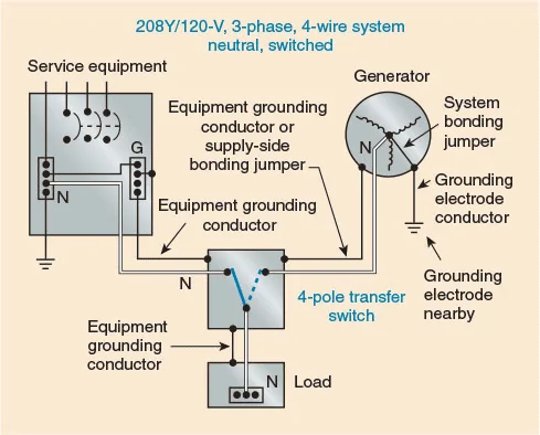

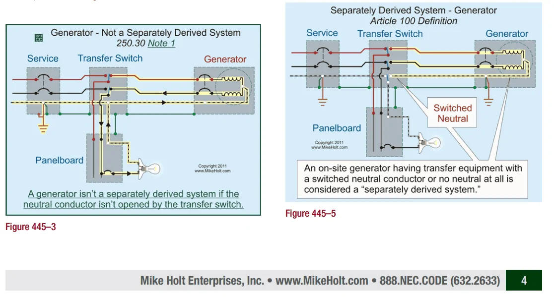

That does not address the continuous GEC requirement.
I typically like Mike Holt, but I think this graphic from the official NEC Handbook Commentary is a little more clear. "Service" on the Mike Holt image is going to be your panelboard in most cases as you can see with the breakers indicated in the diagram. This wiring diagram would also be the correct way to make a code-compliant backup system:
I agree the graphic is bit more clear but it basically shows the same scheme of grounding and bonding on the generator that Mike Holt shows. It's more clear in that it actually calls for a "Grounding electrode nearby" for the generator.
