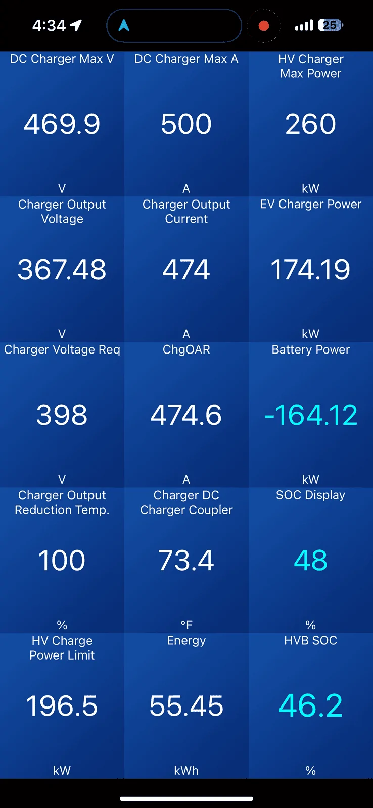

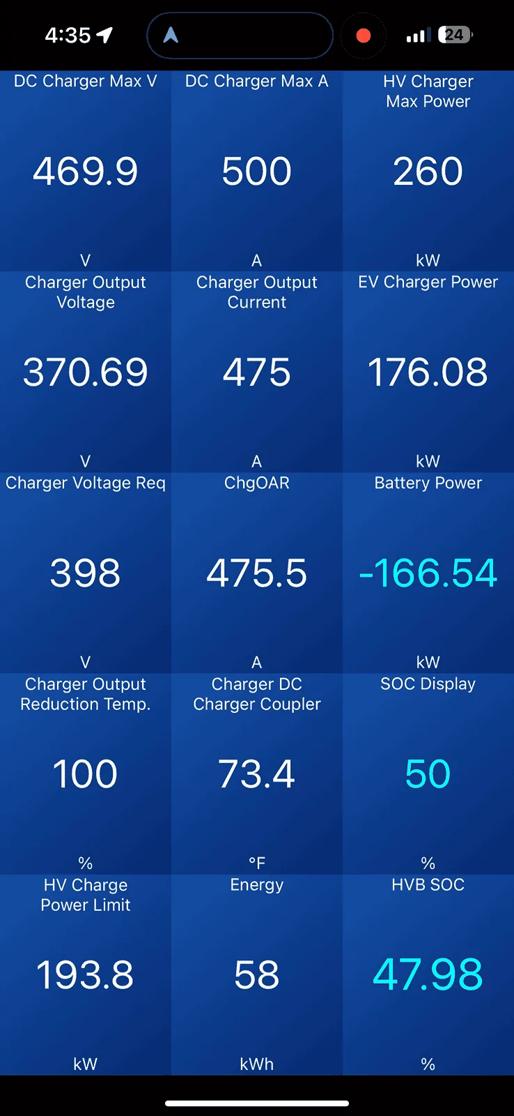

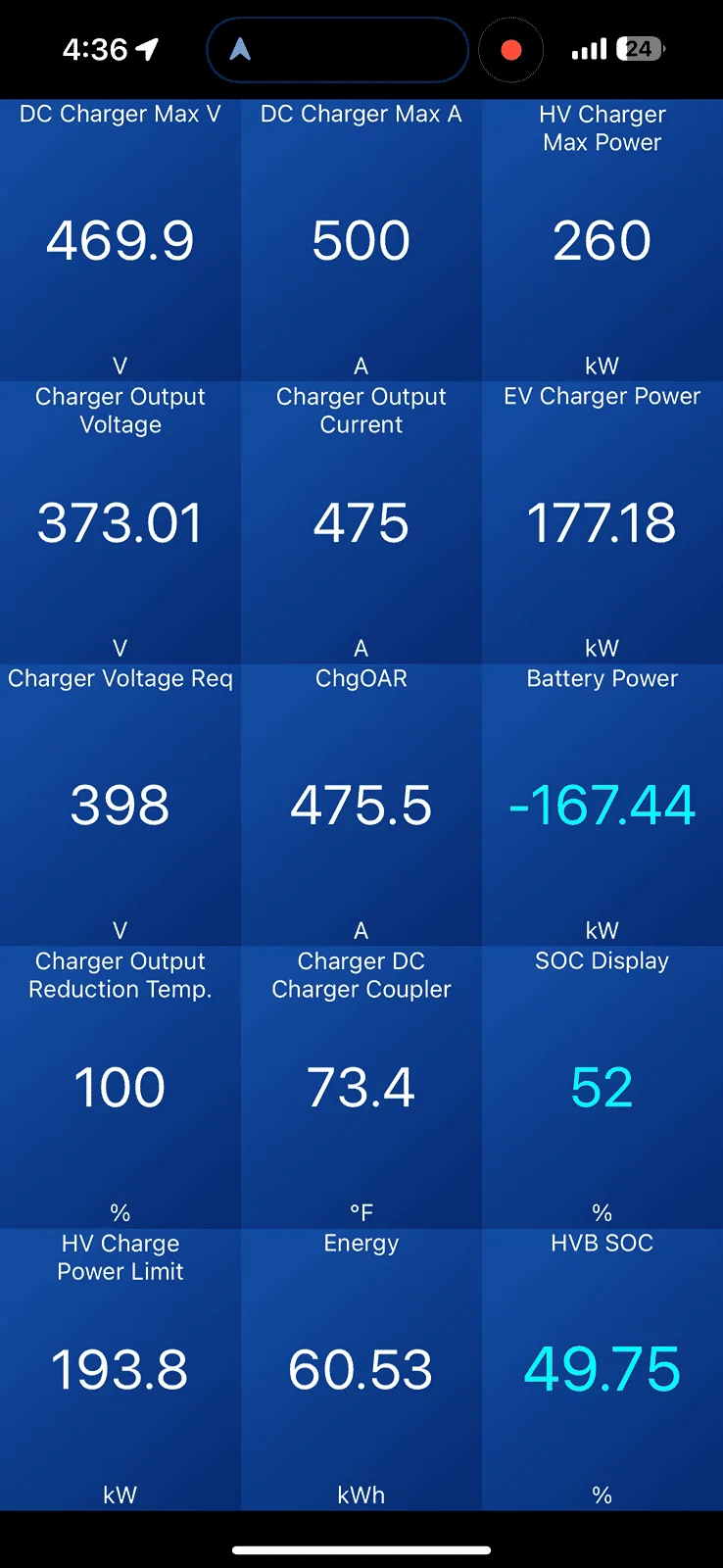

I've never seen more than 174 kW on a 350kW EA unit. I saw 173kW on a Supercharger. I don't know what to tell you.
100% correct.
I will ad my evidence to the record.
We can nerd out (included Car Scanner snaps) all we want regarding the limitations here and the limitations there. The fact of the matter is Tesla V3 Superchargers are capable of providing the equivalent performance as a EA 350kw. Here is my first Tesla Supercharger data from earlier this week. It is identical to what I have experienced on EA 350kw chargers, a boost near ~175kw over 5 minutes and then a tapering down sometime after 5 minutes to ~150kw. Once I saw the same thing occur in my test I unplugged. I had seen enough and had no reason to charge more.

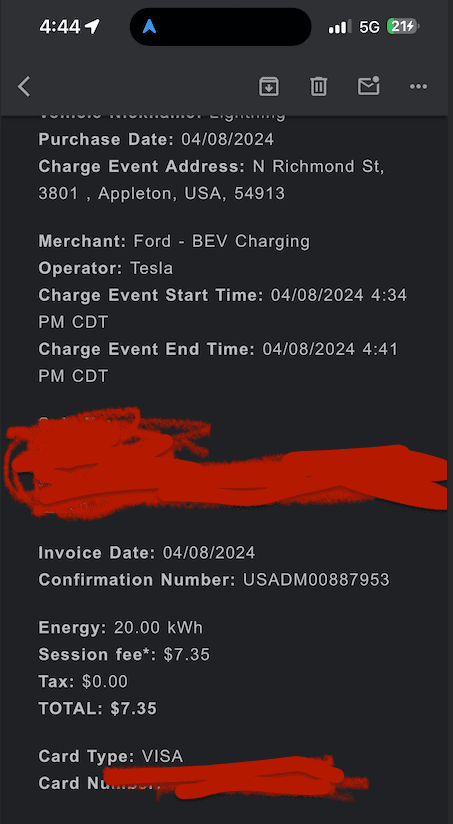

20kw over 7 minutes = a average rate of 171.4kw
I have the whole session screen recorded if someone really needs to see all the data but a few screenshots should serve as enough evidence.

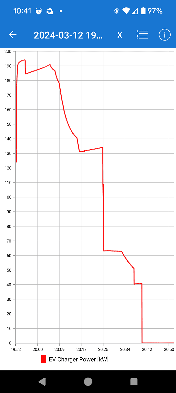

Rawlins, Wyoming. 193.87kW. EA. Shows it there or above 180 from 7:52PM to 8:09PM, 17 minutes.
And that is the game changer in all of this. As long as there isn't a need for the second stall you may be blocking, now 800v vehicles aren't going to get mad at us lowly Lightning and Mach-E drivers for "taking their charger". They all work the same.
