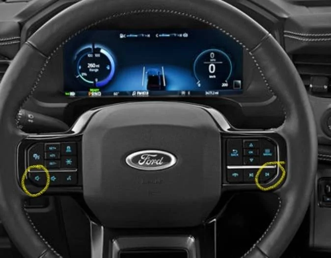

Every time I get in the truck CarPlay pops up decently fast, but there is never any sound. I reboot Sync and all is good.
I'm going out to the truck for lunch right now and see if I can figure it out in the menus, but other than turn the truck off and back on, how does one reboot sync?
Hold the two most outward buttons on you steering wheel for 10ish seconds. The panel will reset. This can be done at any time whether the truck is moving or not. The left one is the volume down button and the right side is the skip foreword button. I have attached an image.
