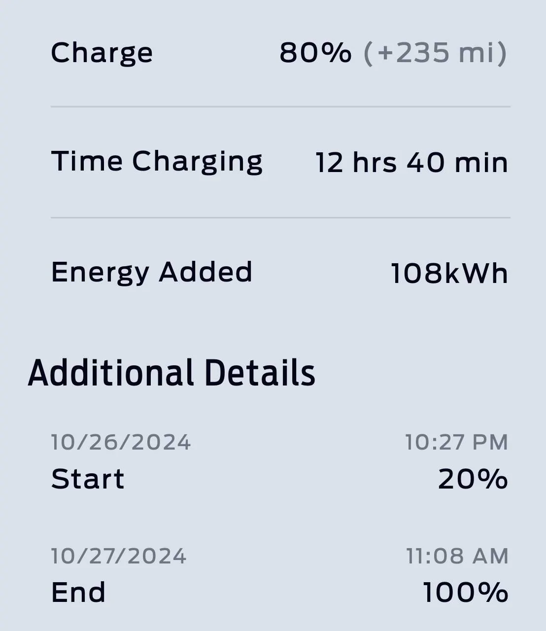

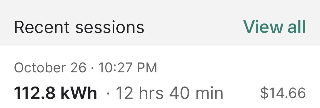

As a reference, I just went from 20% to 100% overnight at 40 amps (L2 charging). It cost me $14.66. Just add an L2 charger at the farm and be done with it ?
Not to side track the conversation, but the Fordpass charging record reflects about 91% of actual total energy consumed from the grid, ex. 108 kWh net to the traction battery converts to about 120 kWh from the grid, 9% loss.
This has been my experience measuring the total energy with an Emporia Vue 2 on the circuit feeding my FCSP

That Dollar amount in my post above is from the Wallbox app which better accounts for the full amount of energy that it pulls from the grid. In my case, I lose about 4.5% going from grid to car battery. That has been consistent for me across both my Ford EVs.
