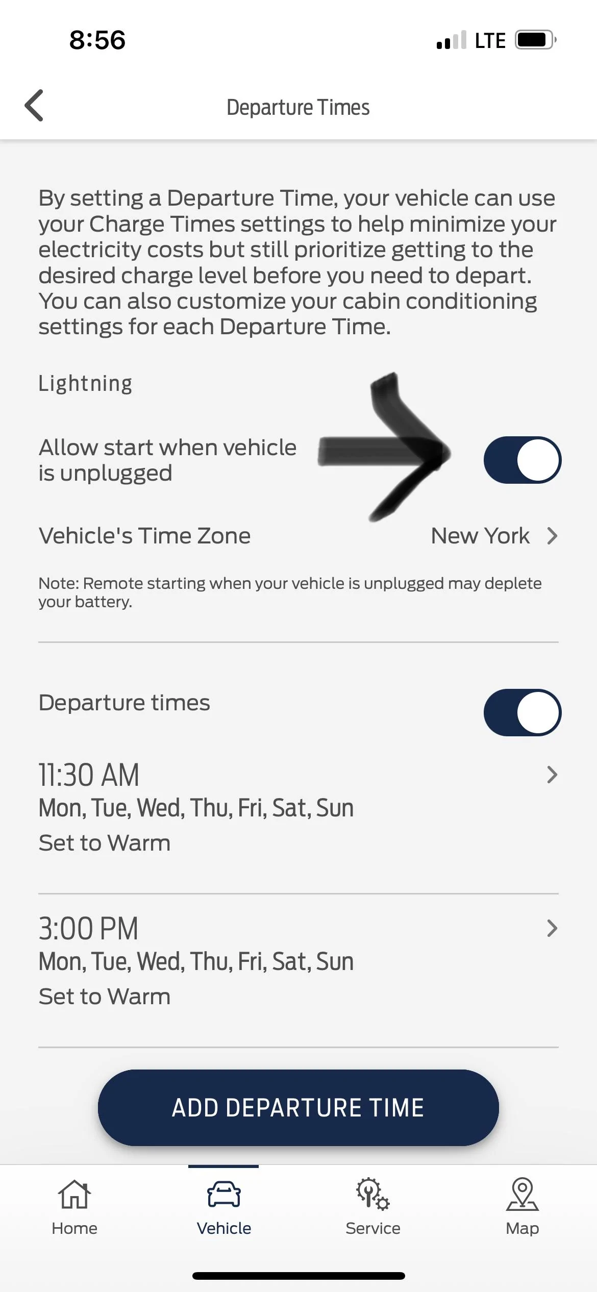

There's a Toggle in Ford Pass for allowing that on the last screen when you add your first Departure Time.
I thought that toggle was just for remote starting while unplugged,
not for preconditioning battery?
Ford F-150 Lightning 100% charged by Airport valet upon drop off, unrequested. Now what? šŸ¤”šŸ¤£ 74C8C93D-3D1C-4585-98FC-921519BC519A
174
12,705
13,431
Speculation by some is that the amount of battery heating is reduced while not connected to shore power. Brings to mind an experiment I am going to perform today & Monday morning to see how much more (if any) a preconditioning cycle or two depletes the battery compared to just manually remote starting vs a timed schedule. Is there a substantial or minor difference ?

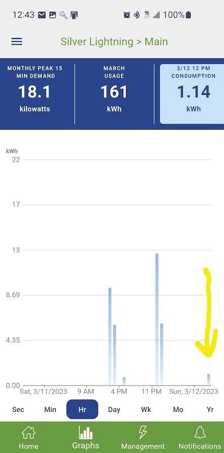

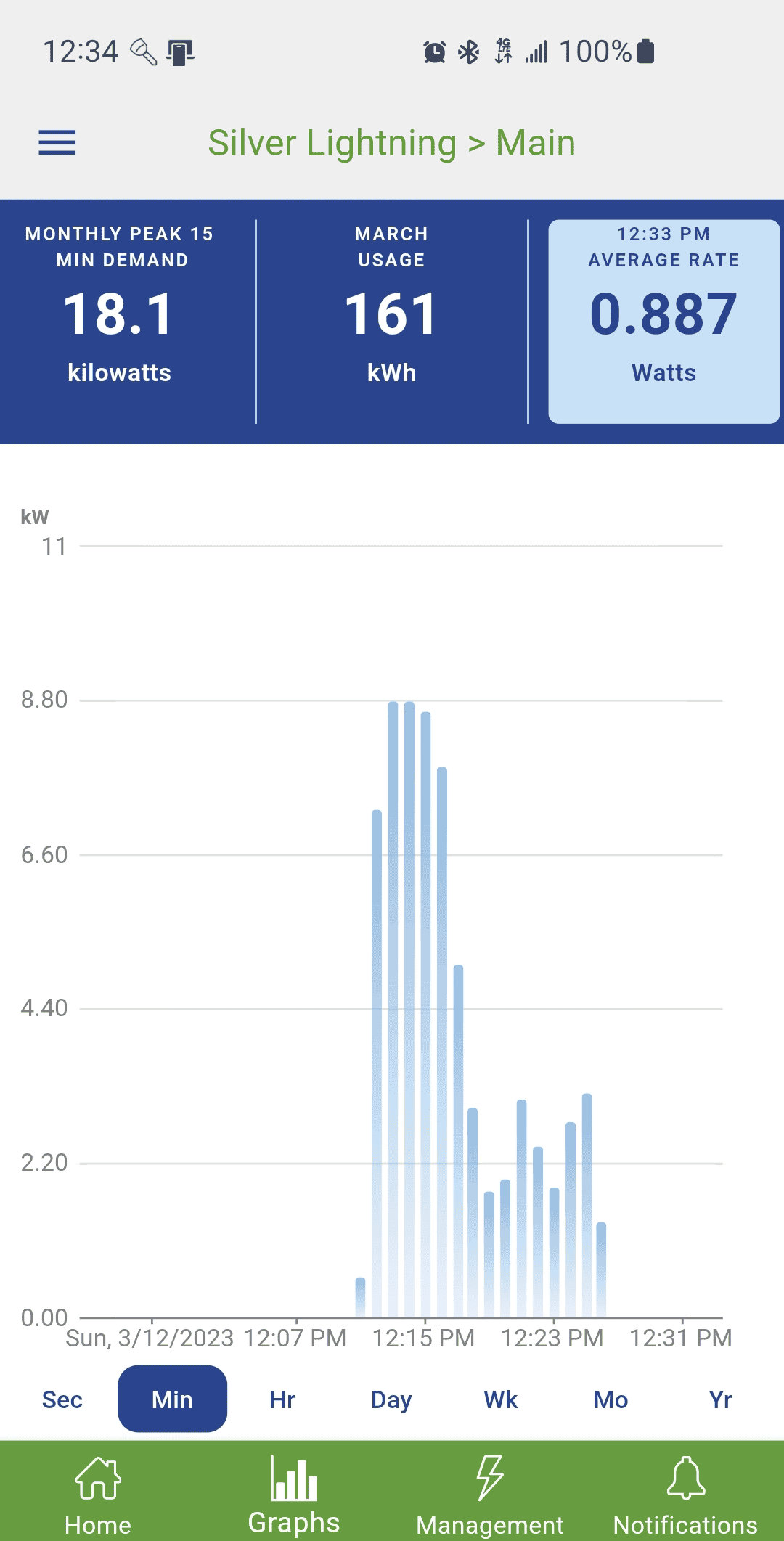

Assuming that a remote start or timed departure events occur 14 times over the next week, you will consume at least 14 kWh of energy based on this sample of one 15 minute remote starting session at the southern New England ambient temperature of 46Ā°
This is the minute by minute energy consumption chart.
Ford F-150 Lightning 100% charged by Airport valet upon drop off, unrequested. Now what? šŸ¤”šŸ¤£ 1678639116509
This is the hourly chart showing the kWh used, I suspect it will be about the same using the departure setting you have programmed.
Ford F-150 Lightning 100% charged by Airport valet upon drop off, unrequested. Now what? šŸ¤”šŸ¤£ 1678639457555
Hopefully the airport parking attendant doesn't panic with seeing your truck illuminate periodically through the day's & week while your away, heck, he might proactively charge you up again prior to your arrival as a measure of good customer service.
It doesn't matter, deplete your battery (a little) is what you want to do, from your screenshot:
Note: Remote starting when your vehicle is unplugged may deplete your battery.
I do agree with the 'forget about it, stress kills' sentiments. But, as @TaxmanHog demonstrated, you can probably skim some battery charge off from where you are.
