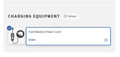

The confusion may be on how to remove it, but you can remove it. On the order screen just click on the picture box with the checkmark and the option is removed. Or click on the box with the small "i" and you get a screen showing more info on the option with a big button to "REMOVE". All the options work this way.
Default:
Ford F-150 Lightning 2023 Charger or no charger? 1682606464035
Removed: notice you can now add it (+)
Ford F-150 Lightning 2023 Charger or no charger? 1682606605256

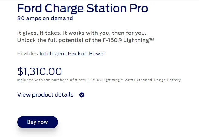

You can order and buy the Ford Charge Station Pro for $1300 on the Ford website
https://chargers.ford.com/products/...the purchase of,™ with Extended-Range Battery
Ford F-150 Lightning 2023 Charger or no charger? 1683599337852
